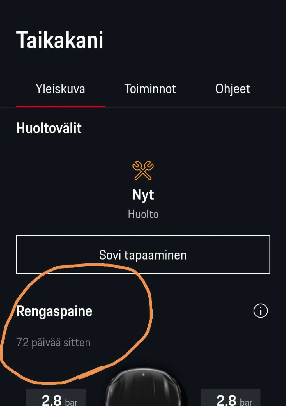

My 2020 4S has now been 72 74 77 84 135 days unusable - Red 'Electrical system fault' .

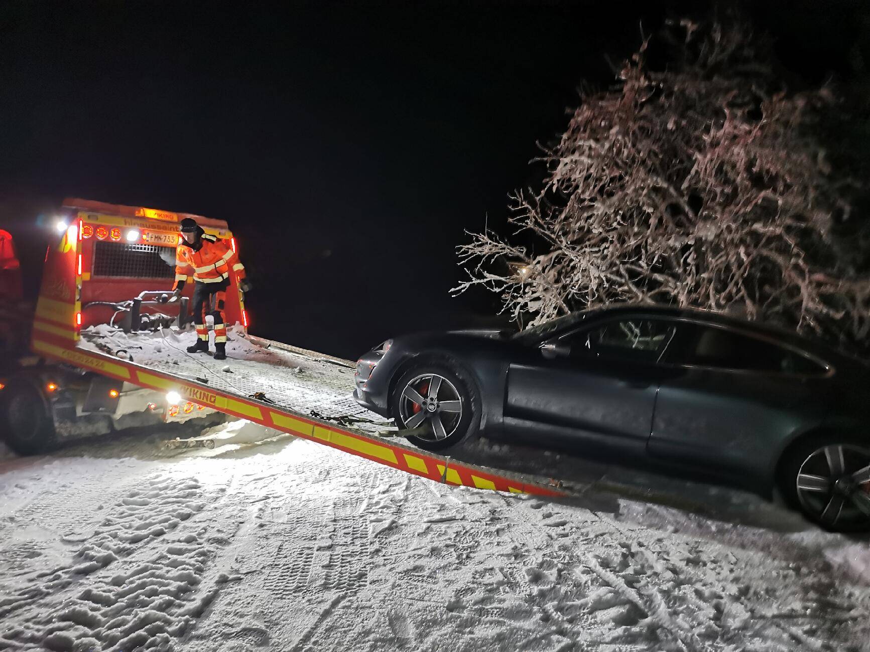

Porsche Espoo/Finland was too busy to take it into service before 1.1.2024 when it left on flatbed.

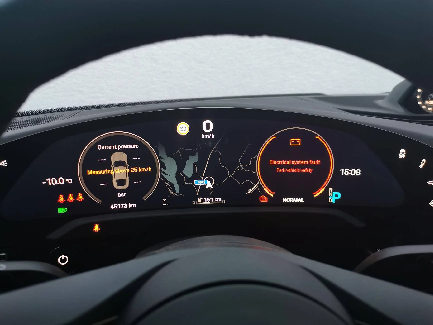

I bought this car december 2021 and it gave this error first time 28th of dec. 7 times during cold temperatures like - 20 to - 30C. Only once during summer.
After service visits Porsche told it's solved by updates and fault returned after cold time's returned over half year later.
So it looks like this problem has now existed during three years and after this 72 74 77 100 135 days I still don't have any estimate when it will run again.. if ever.

I too had a red Electrical system fault. Took a long time to resolve and the fix was WPN8 (which didn't work) followed by a new 12V battery which did... Of course there are multiple potential causes of this fault so YMMV.

Over a year ago I complained about 12V battery issues as this error raised after battery voltage display goes very fast from ca. 13.5V to ca. 12.0 V during 'starting' if the weather was cold.
If it stayed over 12.5 V before the DC/DC converter kicked in - no error.
So they said they ordered the 12V battery for this but after service they told it was not changed and this was just software issue!
Until now they have changed on board charger and converter (I don't know which converter..).
Looks like they have new parts for the coming friday as there's time slot reserved..
The Porsche Approved warranty insurance from 'Real Garant Versicherung AG' ends 1.5.2024.
I don't know who can afford to keep these things running after warranty as it takes months to service and tens of thousands (€) in parts.
