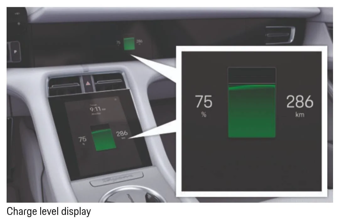

Thank you. I must be being thick. So let me get this right the charging summary (as attached) will fluctuate when fully charged

based on that screenshot, your range at full charge is about 238 miles
286km at 75 percent full means it would be about 381km at 100 percent full, or 238 miles
of course, that Is an estimate based on everything others have said earlier

Hi Reg, sorry that screen shot was taken from the Porsch Good To Know, my bad just wanted to describe what I meant. Thanks for getting back to me

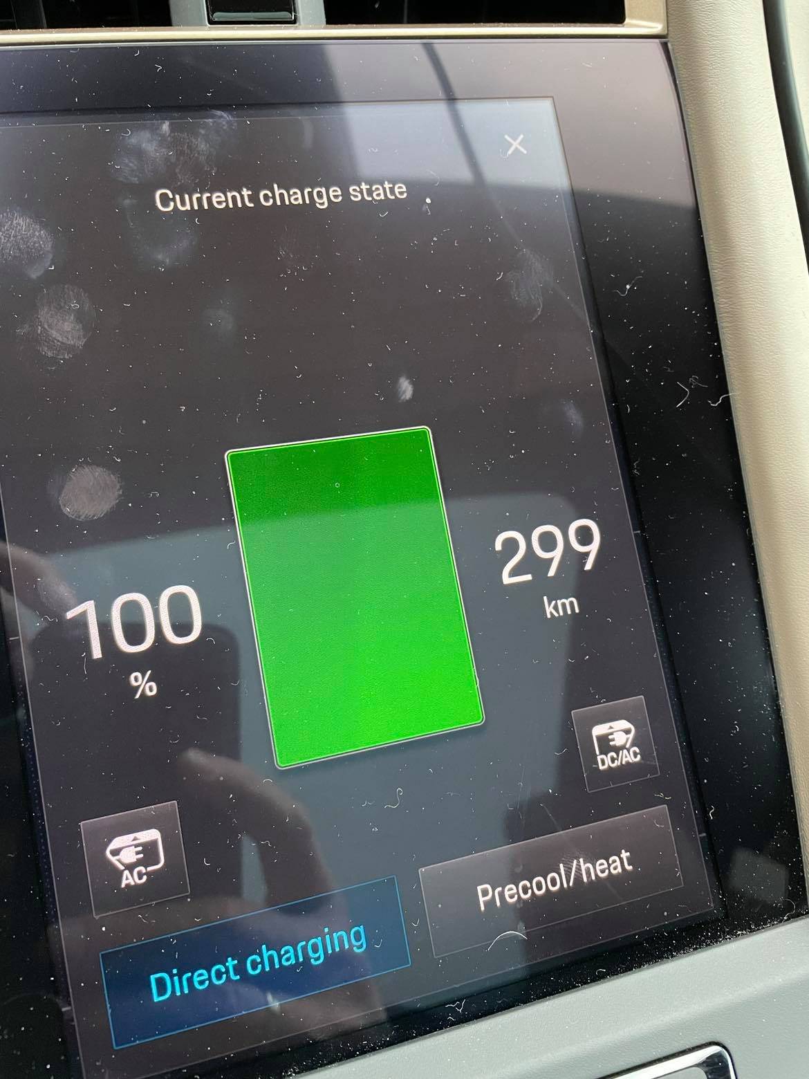

Similar problem has started to occur with my own and also with my friends Taycan. Weather at the moment is about +2...+5 Celcius, so not very cold and also we keep our cars in the warm garage but after fully charging the battery it shows under 300 km range and i'm not even sure that it can do even that much with Normal mode and regular driving.
This is definately not okay! Imagine what happens after 3-5 years. Also to note that in the summer time full charge with regular Performance Battery showed only max 350 km range not 400 llike writen in the spec sheet by Porsche....
Also we both optioned additional heat pumpes and it was said while ordering that with that the car spends less electricity on heating and can go longer. Actually this is very frustrating. Especially given that for Battery Plus they charge about 6000 € and it should give you only 50 km more. Concidering this, i think it is absolutely outrageous to get 100 km of less range in real life with normal battery compared to marketing materials.
NB! Just got an update that the real range that was driven after charging was 232 km and the car showed 31 km remaining. So in reality the range in these conditions was actually about 260 km!!!
