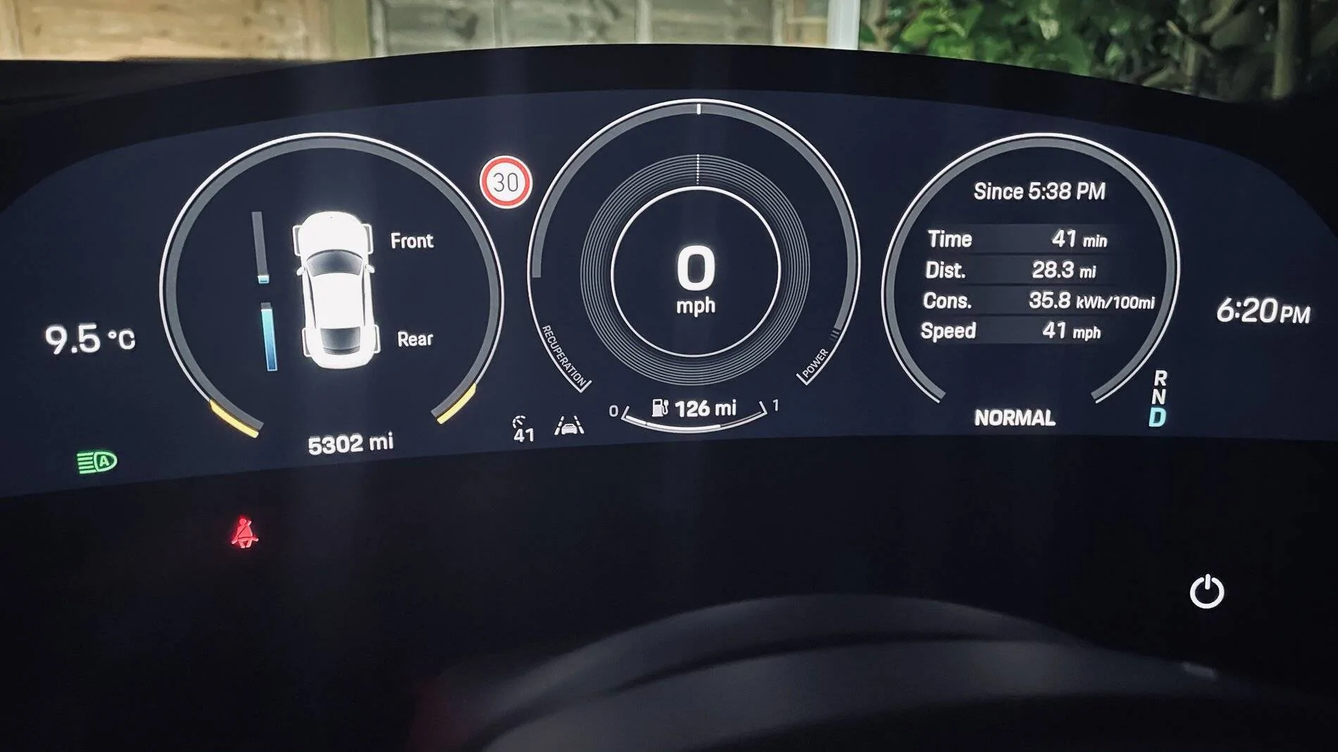

I managed to get 36khw/100miles once by rolling down a big hill then driving at mph on a main road at 35mph for a few miles.
Porsche dealer asked HQ about it and they said nothing wrong just adjust driving style!
There must be some kind of battery test they can do?
Slightly bizarre...

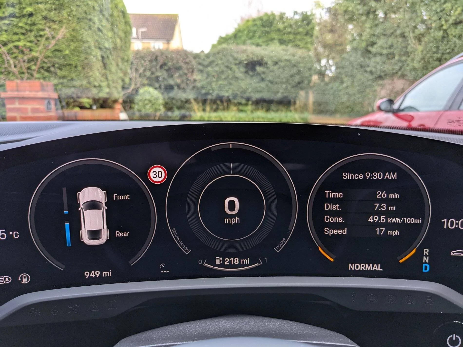

This is the most I seem to be able to get, which just fees abysmal to me.

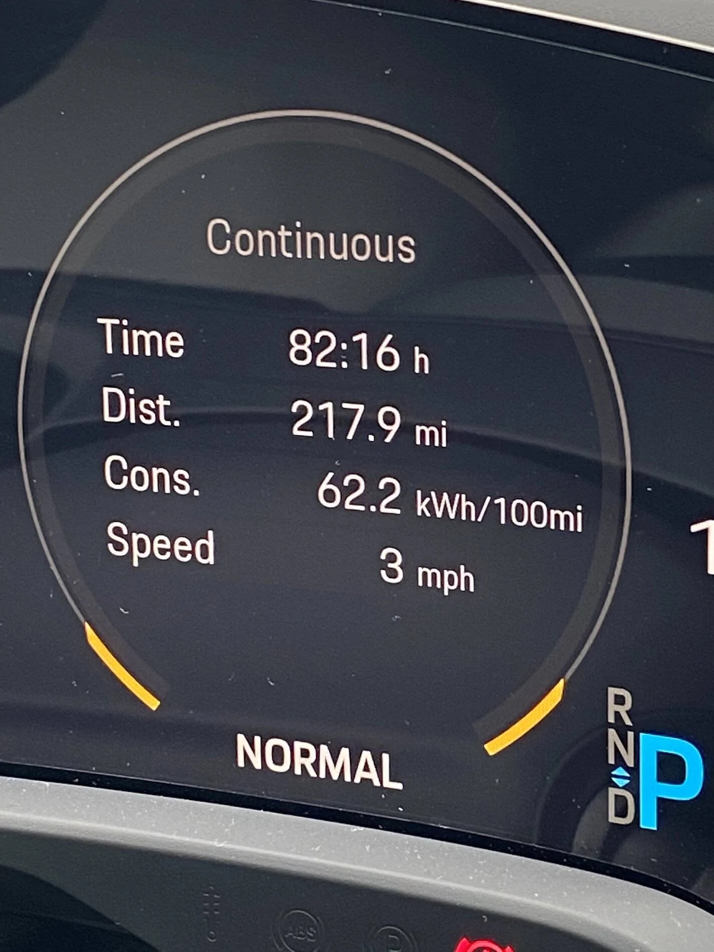

How come your av speed is only 3 mph over 218mi?
Was your car in a showroom and powered on all the time to explain the 87h?
It’s a really good question, when I go back and total up the duration of each of my trips it only comes to around 20 hours. So I have no idea where the extra 60 hours are coming from?!
3,081
2,681
Weird! But did you not say something about sitting in the car in the driveway to play around with the PCM? Maybe those hours count, but 20 hours sound an awful lot?
Your latest consumption figures also look very odd. It would not be so that you by mistake hve switched on seat heating and massage etc in the car. Tyre pressures are ok?
I guess you are under lockdown in the U.K. so it is difficult to take a longer trip etc. But that would be the only advice I could offer to see the consumption.

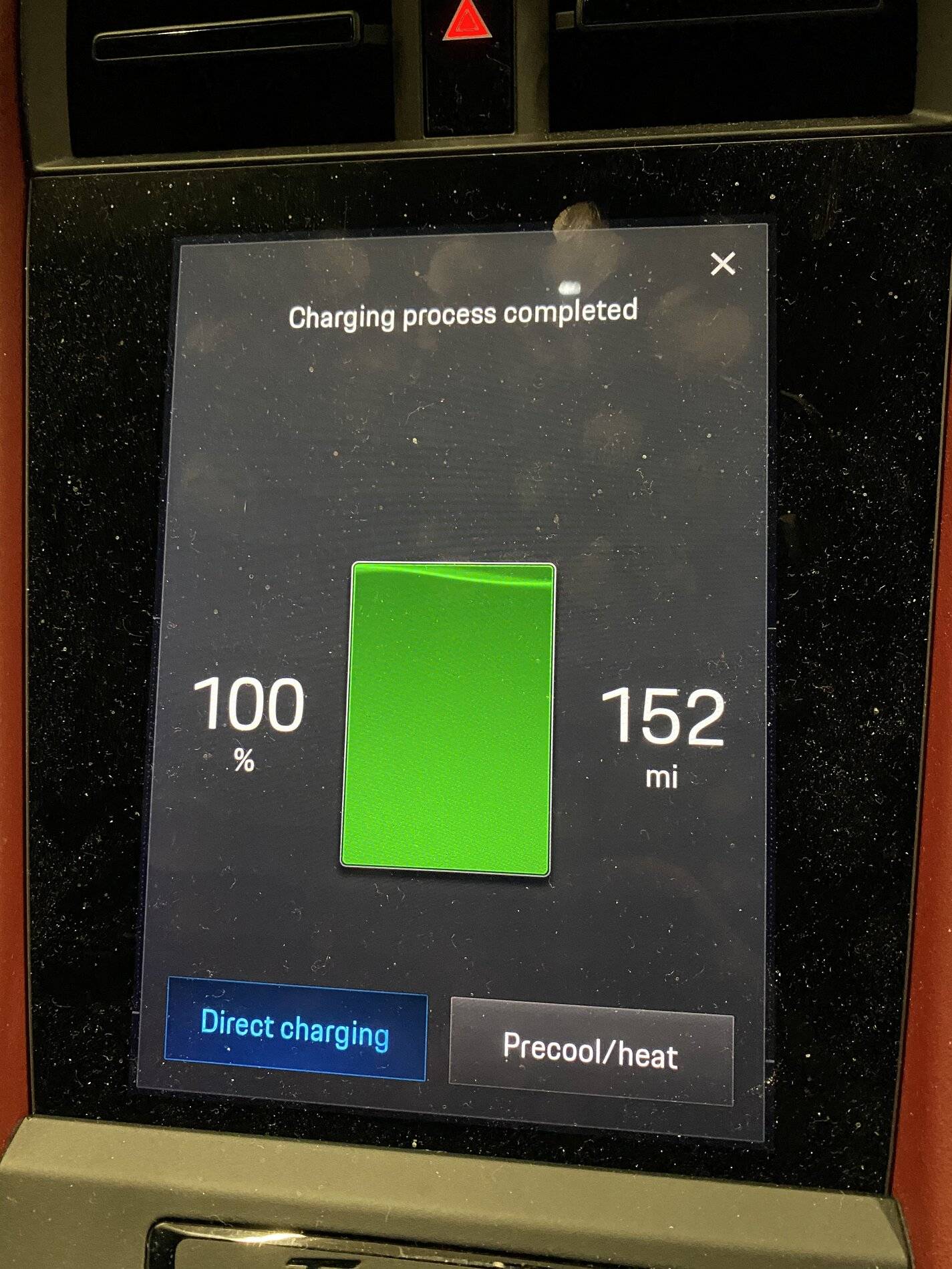

I have the same problem. When I got the car (big battery) I had over 400km range when full. Now I get only 252km with 100%. It started before Xmas. I went to Ionity Chippenham all and arrived with 40%. As I installed the chargers there, I ran the battery down to see how the chargers work. At night I tried to charge back up to 100% but the range absolutely dropped and I couldn’t even get home. I had to stop in Baldock again to put some juice in so i could get home. And now as well, it looks like the car thinks it has a smaller battery???

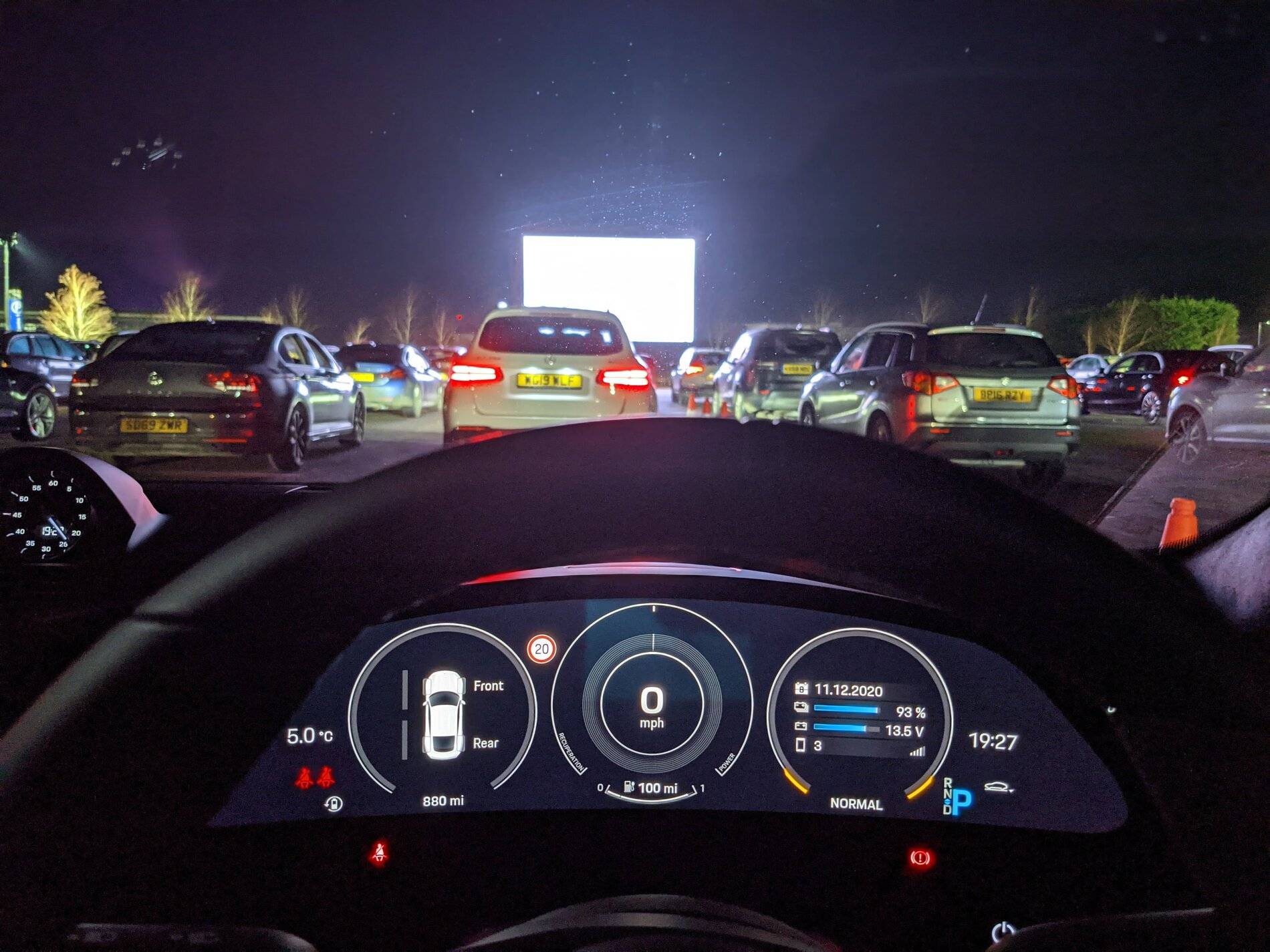

Interesting, my car is currently with the dealer having new battery fitted - it lost approximately half the battery capacity, I don't have a very good picture, but you can see the effect here, 95% charge and 100 miles range predicted:
Porsche Taycan 100% charge showing 175 mile range PXL_20201211_192723709
On the consumption topic, I'm doing the nursery run tomorrow - 3.1 miles each way although the weather is predicted to be a balmy 10 degrees. I'm not preconditioning so I'll record the battery usage and update.
Wow, well that is interesting. Did you lose range gradually or was it pretty sudden?
I got home after running the car pretty low, having completed a long trip where the range was normal. The next time it charged up it only showed ~100 miles @ 100% SOC.
Sorry to hear about the problems. That's quite bizarre - my initial instinct would have been that it was a software issue or battery management software problem not measuring capacity properly after the battery was run down, but sounds like your dealership has determined it to be a battery hardware problem. I thought it would be quite rare for multiple cells to fail like that so suddenly, and the battery should have a lower floor buffer to stop the battery completely discharging and getting damaged. Just to be clear I have zero education in lithium battery science, so I could quite clearly also be making things up.
So how difficult was it that they changed the battery and how long did it take?
I am looking to do the appointment now as 100% and only 150 miles is not good enough.
They came to conclusion that the battery was toast themselves, though I'd pretty well proven it beforehand.
Currently they've had the car 55 days and counting.
