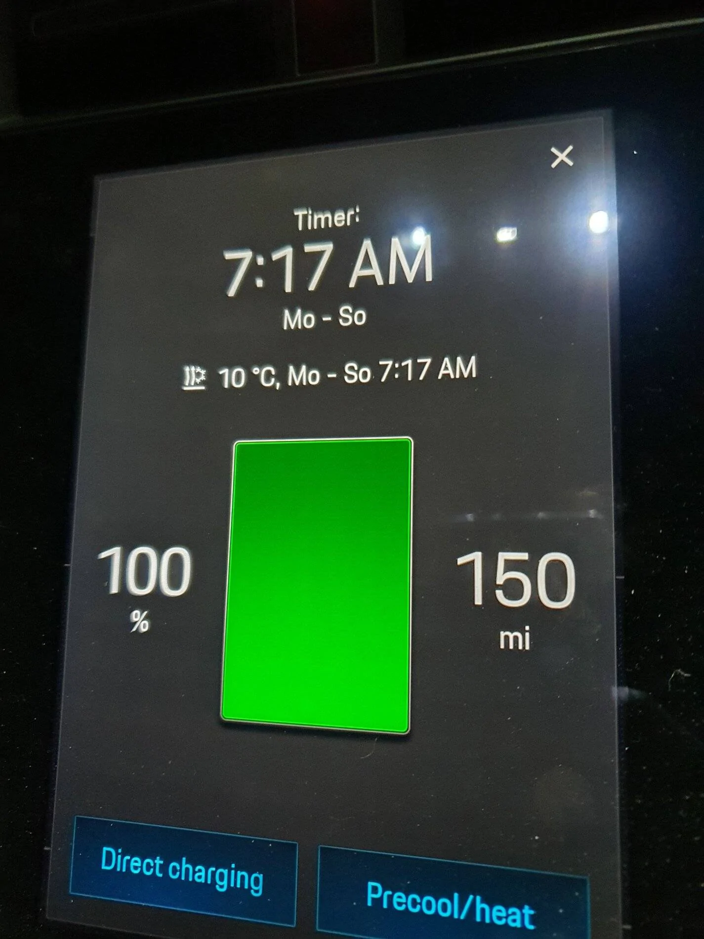

Hi all. Finally took delivery of my 4s and absolutely love it. However, something I noticed when I charged it for the first time at a rapid charger is that when it got to 100% the range showed 175 miles. Is that right? Also noticed the word 'overview' in the Charge menu in the PCM was in German!! I went out of the menu and then back in and it went back to English :CWL: I didn't opt for the performance battery pack so its the standard 79kwh. To be honest I thought a full charge would show a range of 250 (which I know you wouldn't get in reality).

Let us know how you get on. Have you noticed all the low range problems seem to be on UK cars?
They must have a bettery tester?
So how difficult was it that they changed the battery and how long did it take?
I am looking to do the appointment now as 100% and only 150 miles is not good enough.

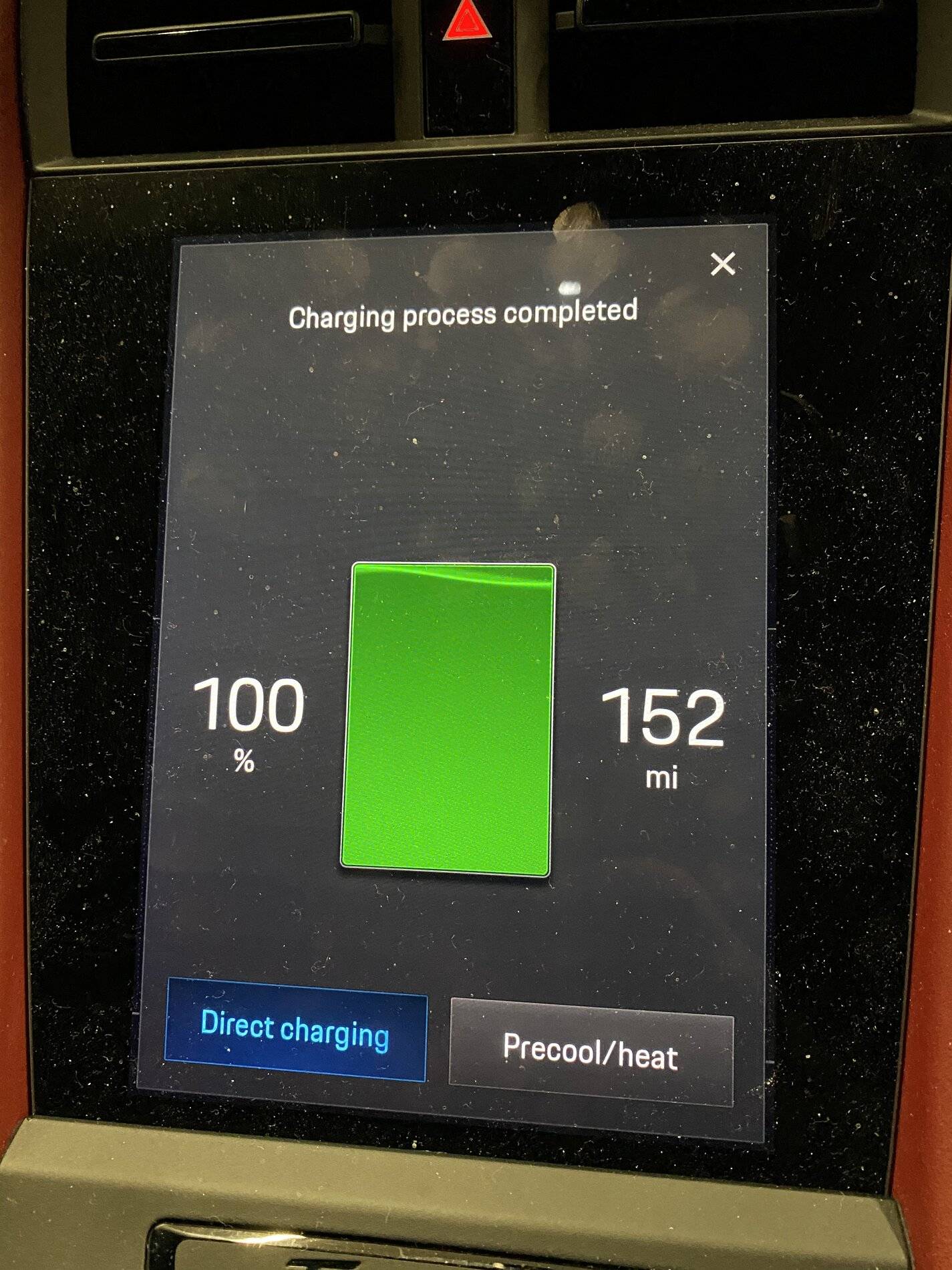

This is mine and I have the performance battery?
Porsche Taycan 100% charge showing 175 mile range D78C79F7-09DC-4AB1-8A67-380CC1B72980
