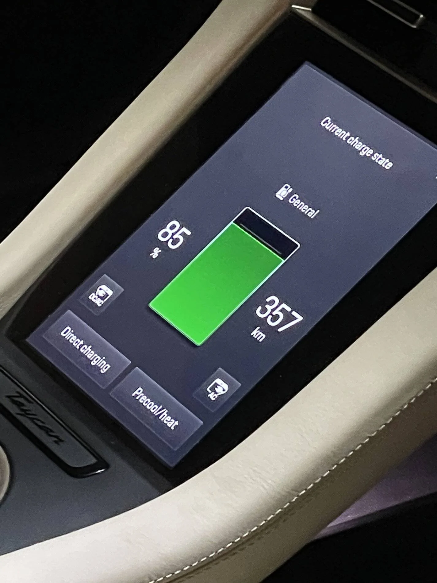

100% charge showing 175 mile range
John89
Apr 29, 2020
265
124
Illinois
2020 Taycan Turbo S
How do you get such high consumption? Battery heating, launch control, mountains?
Flat roads, 20°C, no AC, relaxed driving, I get under 27 kWh/100mi (16.7 kWh/100km) and a total range of 316mi (510km)

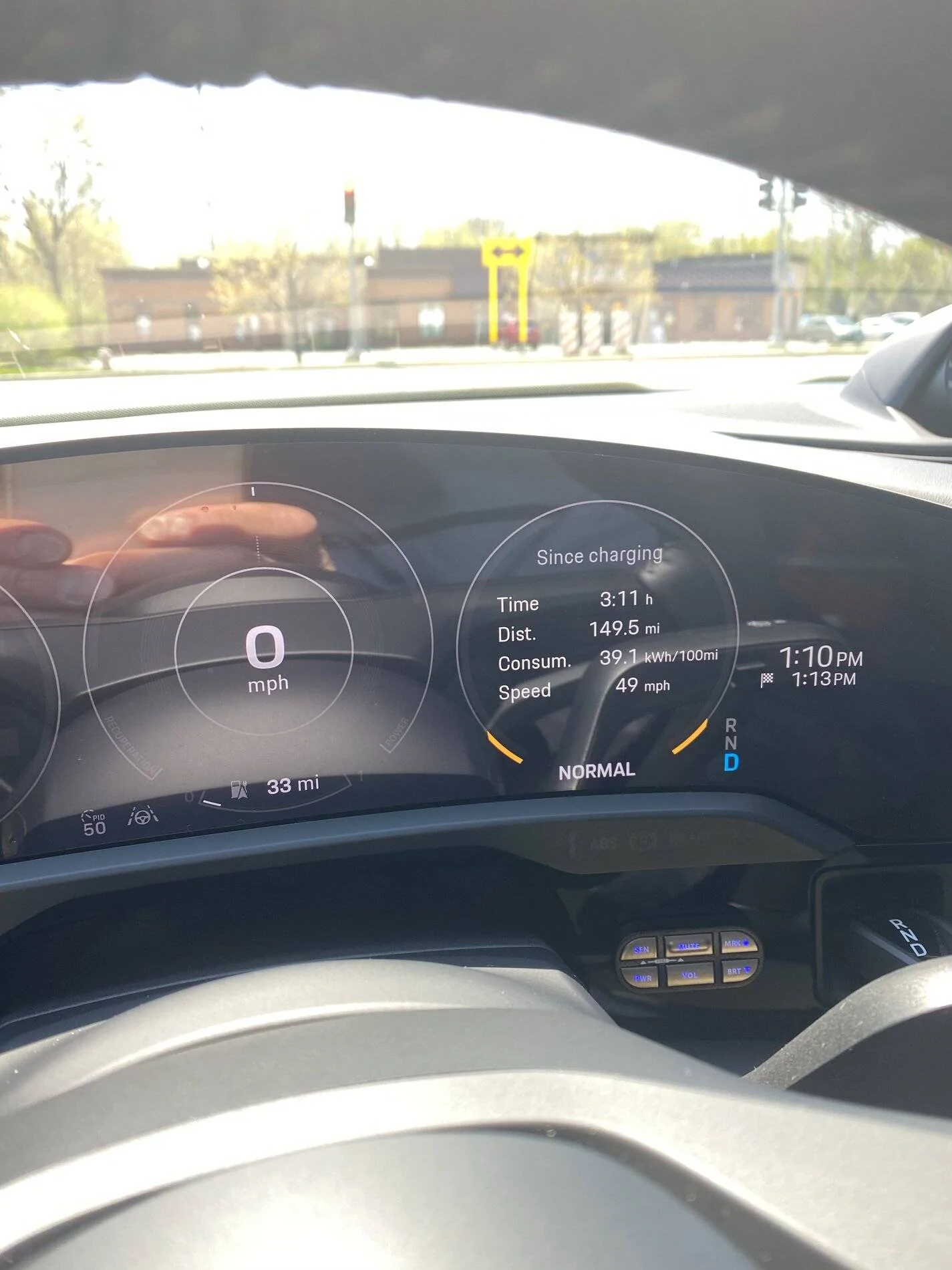

I have about 41kWh/100 this charging cycle, thats actually good for my car. I had a "guesstimate" of 211 miles @ 100% charge when I started. I am on pace for 206 miles and I have about 65% charge left. Weather is warmer than last few weeks, it's in the low to mid 40's and that makes a difference.

John89
Apr 29, 2020
265
124
Illinois
2020 Taycan Turbo S
I have been driving VERY carefully and gentle. I am on pace to see 221 miles of range at 100% charge, this cycle. I have not accelerated hard even once, I am consciously trying to see max range.

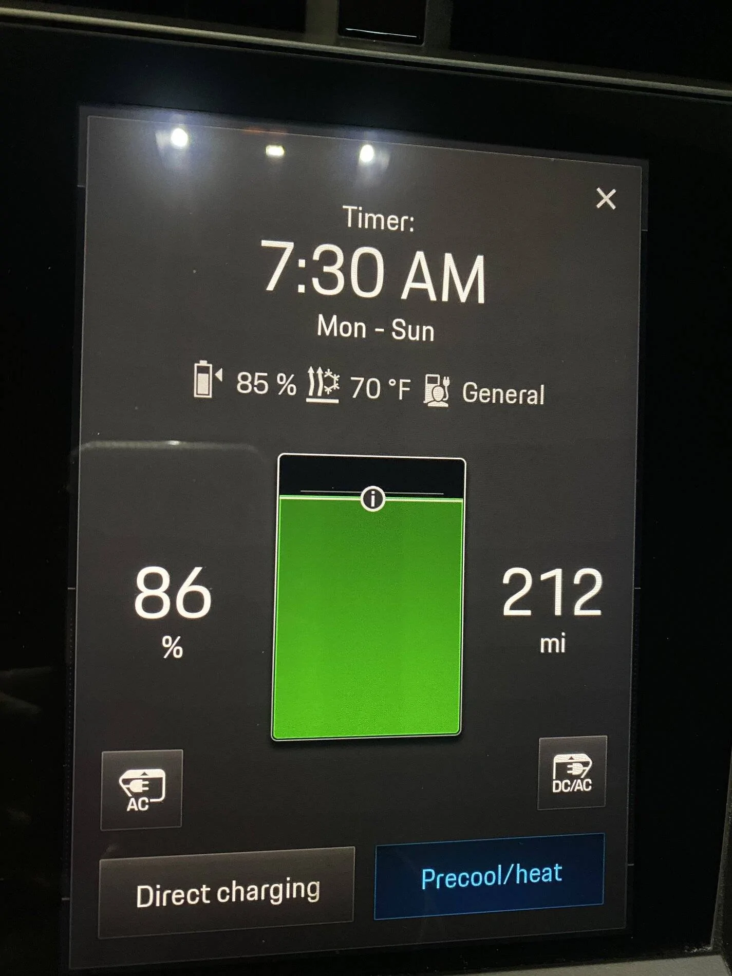

Here was my range guesstimate this morning. car preheated to 70 degrees.
And here was the actual mileage this afternoon. 182.5
Outside temp 57 degrees last part of ride.
16% reduction in range than Guesstimate. BUT, thats good range for me for 85% charge.
Normal mode. No charging phone, WAZE on via car play, no seat heaters, ECO mode for climate.

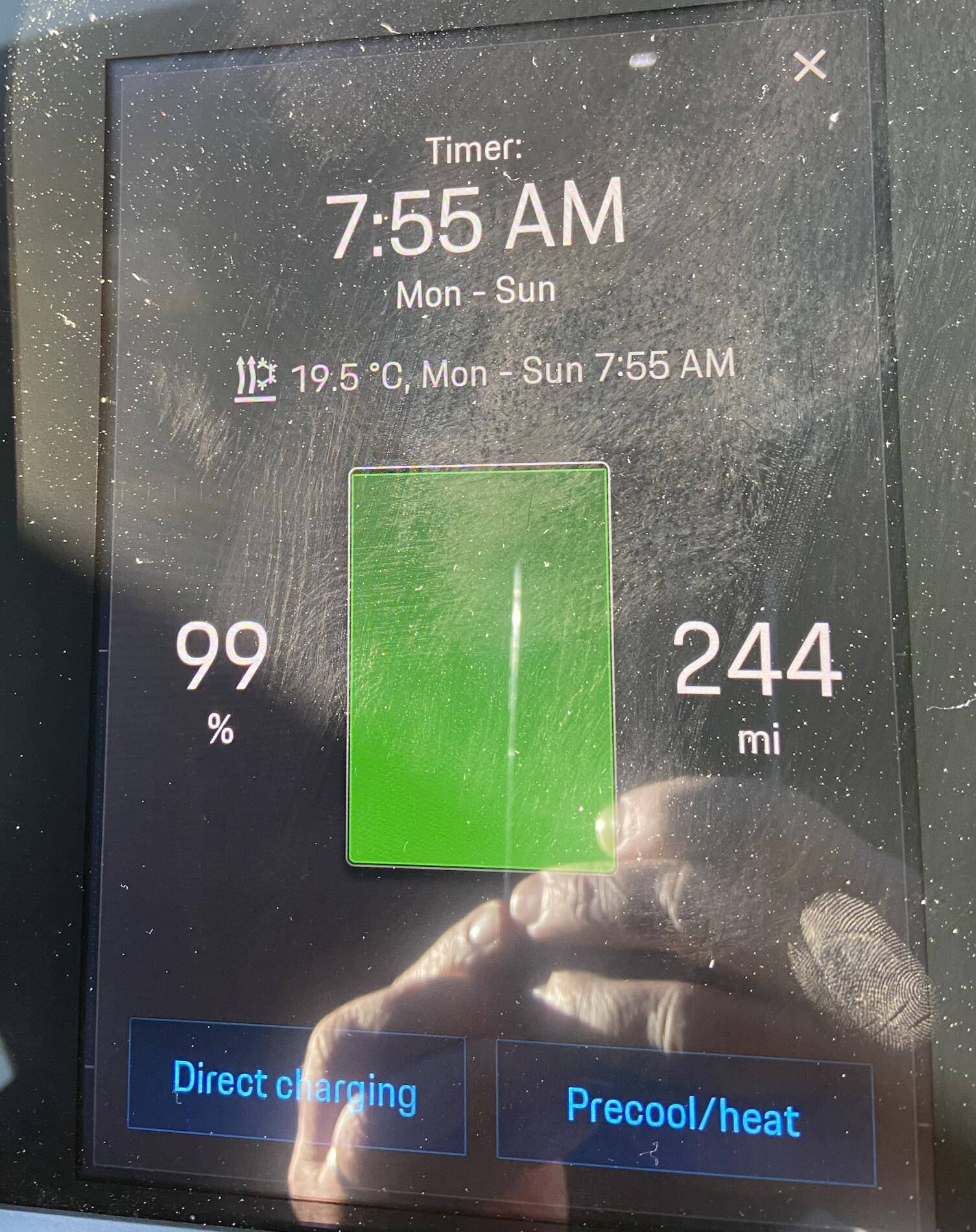

Just had the software update installed at the dealer and range has increased from 220 to 244 miles.
UK Taycan 4S with regular size battery.
NC_Taycan
Lewis
Oct 13, 2020
588
473
Wake Forest, NC
I will postulate that your range didn't increase - instead the past driving history was erased and this is the range based on the default calculation without any driving history. If your next few trips are on a cold battery in sport plus and you drive it like you should, I suspect your range will go down. If you make longer trips on a warm battery in range mode and hypermill, your range may go up. I'm booked for the update on my MY2020 Monday.
