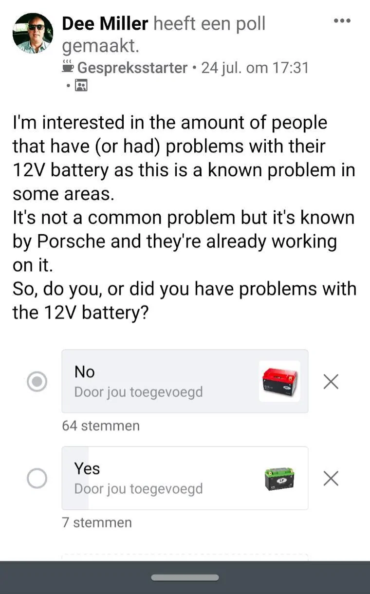

Yes.
Oh, when was that done? Did you get anywhere with Porsche?
Thank you.
Porsche reads forums too.
But if you ever going to contact Porsche you are free to use my results.
I've had an update recently so I know Porsche still works on this.
