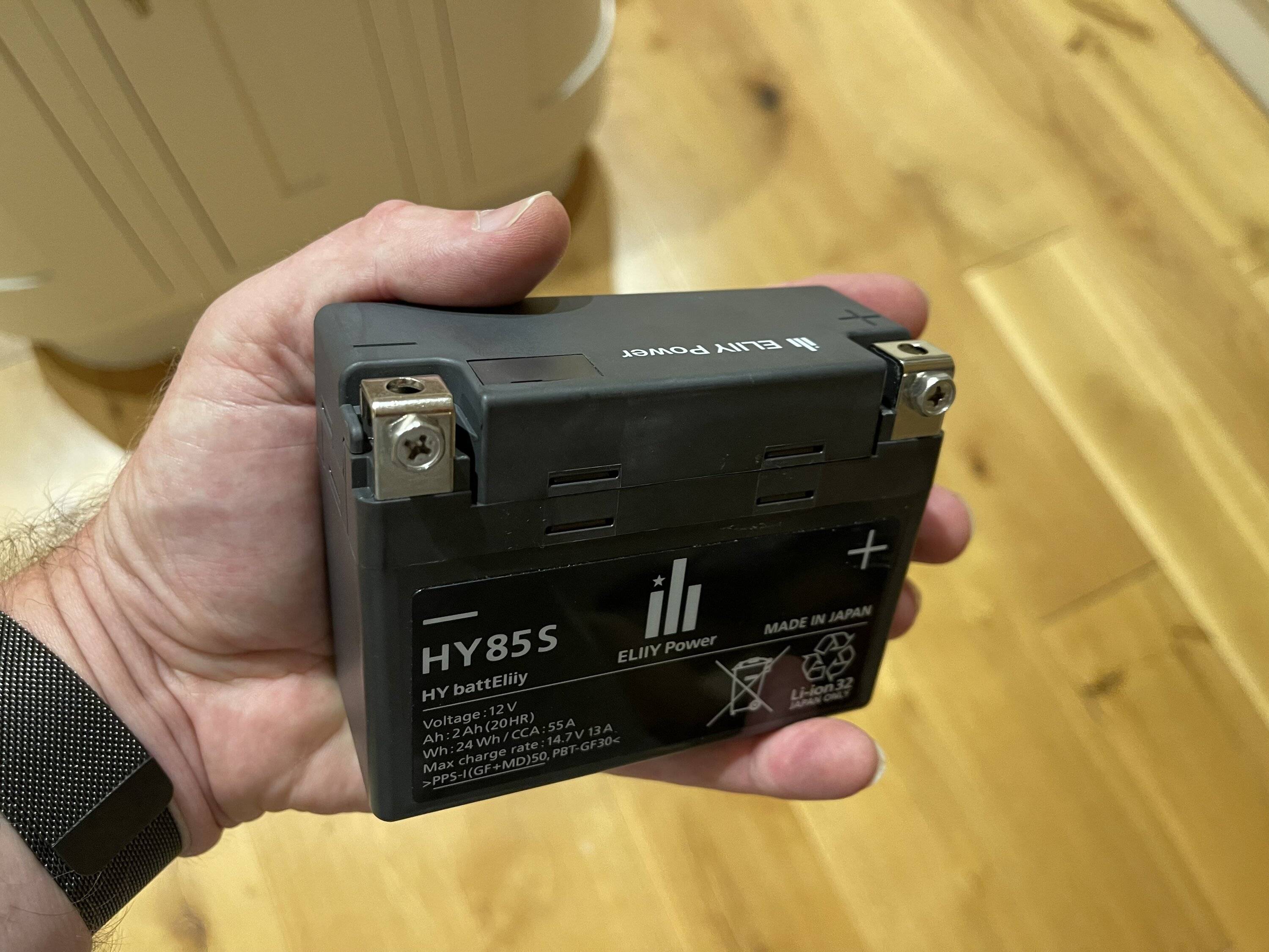

I picked up a new Fireblade SP a few weeks ago, fitted with a Lithium-Ion battery - but appears to be a bit of a special (size) - to suit Honda.
Wondered if Porsche had done similar, hence delay in them sourcing an alternative?

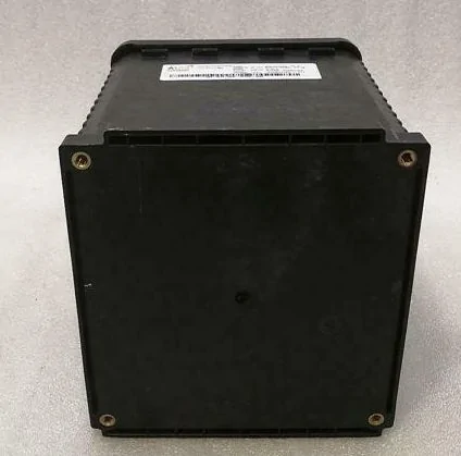

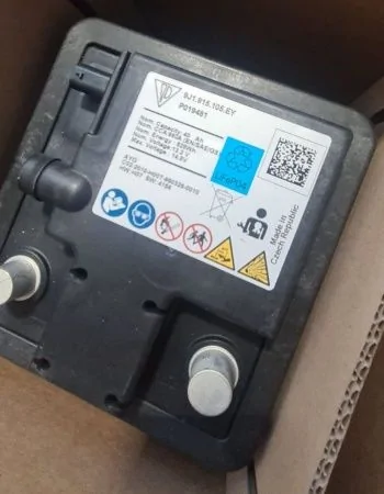

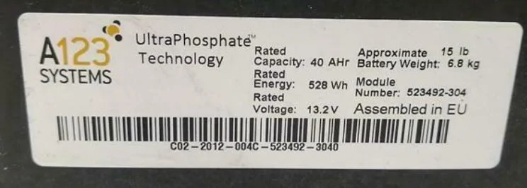

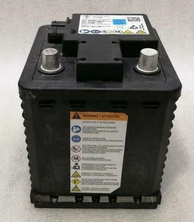

Answering my own thread 😂 how sad!
Definitely looks like a ‘special’ - from some various googling this morning…the 12v battery is a Lithium Phosphate type made in the Czech Republic by A123 Systems
From what I’ve read it’s a somewhat fancy beast, using a LIN bus connection to the car for telemetry and diagnostics. Therefore no simple/ready/cheap aftermarket drop-in replacement.
Original part looks like it was;
Porsche Part # 9J1915105EY (9J1-915-105-EY)
Think this has been superseded (possibly following earlier battery fails and recall) by:
Porsche Part # PAD915105 (PAD-915-105)
Parts prices look pretty insane too btw. A grand for a 12v battery!!:eek:
What an odd little thing (2 Ah) to start a 215 hp bike and run the numerous ancillaries...they may as well have taped some 9V alkaline cells together. No wait that would be heavier! 😂

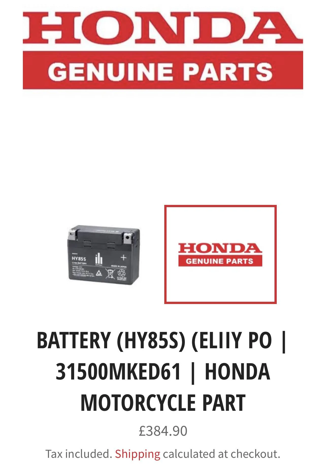

Pro rata, the cost to replace the Honda battery is worse than the Porsche 12v battery…both ridiculous prices imho. 😎
