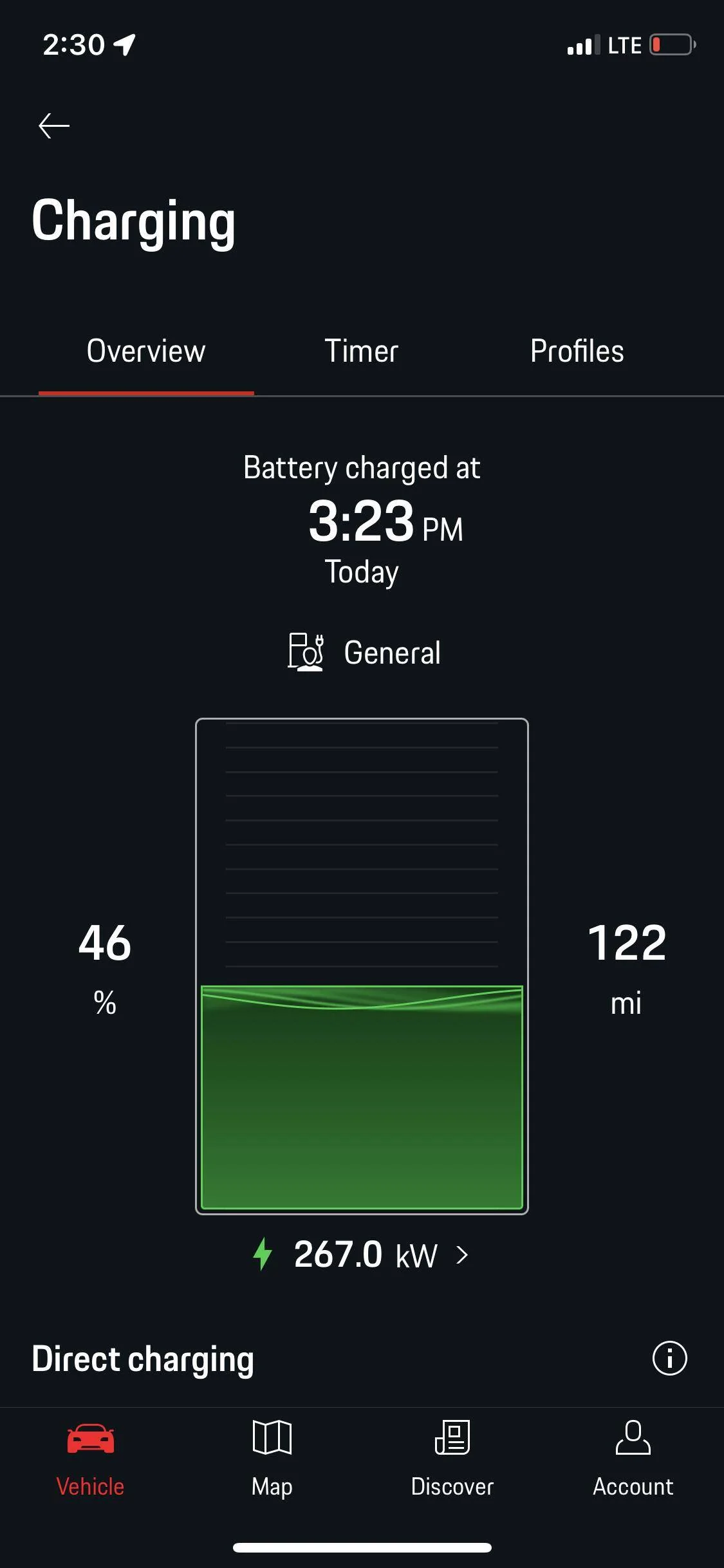

On the drive down, the EA stations were nearly perfect (2 restarts needed). The charge rates were incredible. We didn’t even have time to eat…. At one point the charge rate was still over 260kw at over 40% charge.
