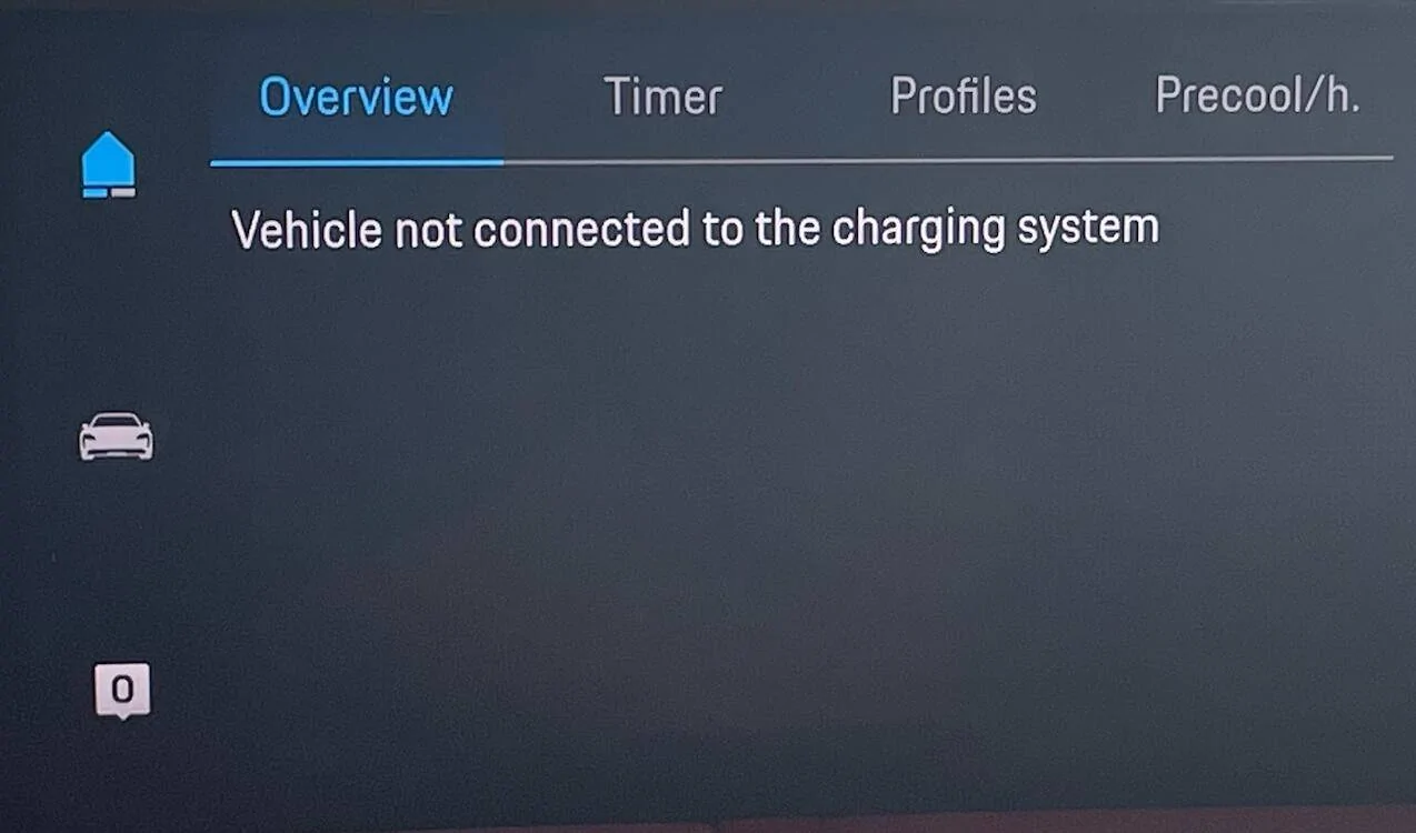

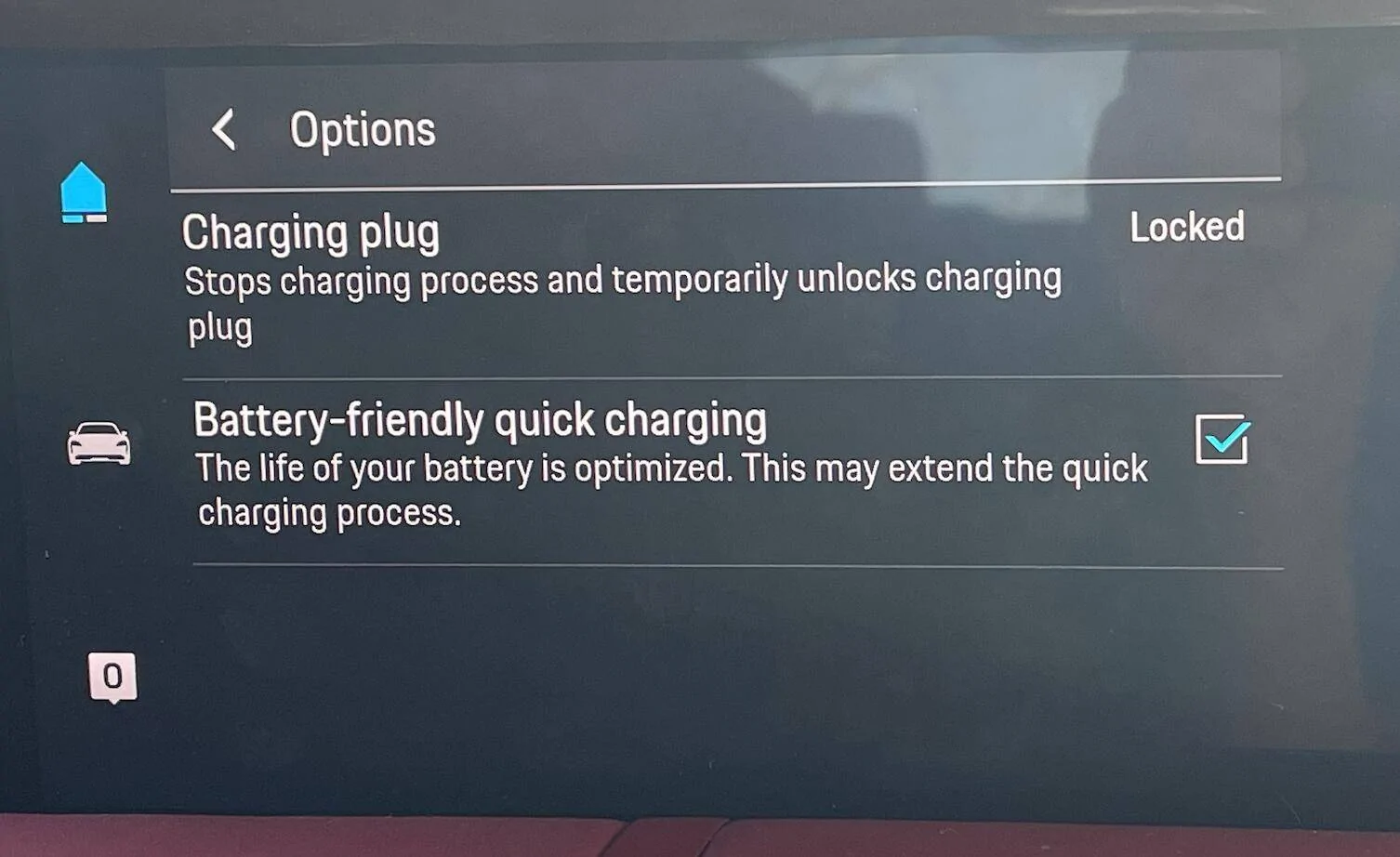

8,733
5,213
GTS ST, Macan T
therein the root of my charging frustrations.
is that what the car says now? when I set my car up that message wasn't shown
I got my car in Nov'20 (MY21) and these options have been there since day 1.
If they aren't visible today then I assume this relates to MY and build date unless there is also a regional variation.
