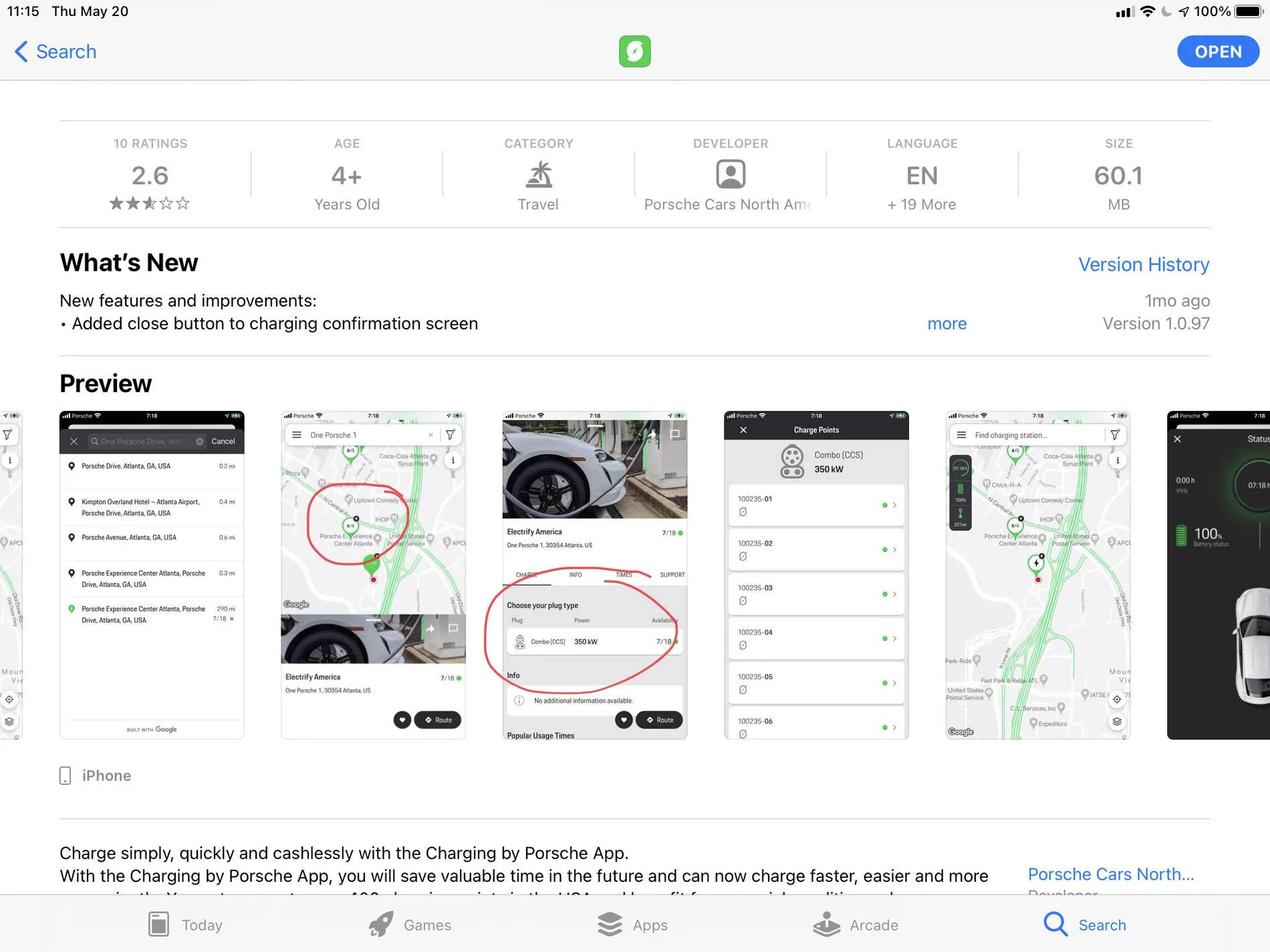

So related to this conversation, is there any way to check what the output of an EA charger is without physically driving there? The EA website doesn't seem to list specs for their chargers. Plugshare app? EA app? Something else?
Yes. See image from NA app. In the app you can click on a location and it will show you what chargers they have and their capacity.

Cool, I'll check out the EA app, thanks. I understand they are theoretical maximums affected by battery temp, SoC, etc. Just want to know what hardware I'm working with. I thought you said most 400V chargers will be 50kW? Any reason you only listed "150kW or 350kW" as options?
the charge NA shows what level and how many units are at each location
The Electrify America chargers are all 800v. There is another thread on the site that shows how few 400v DC chargers there are in the US. So, EA puts out just two speeds for its DC chargers, the 150 and 350.
