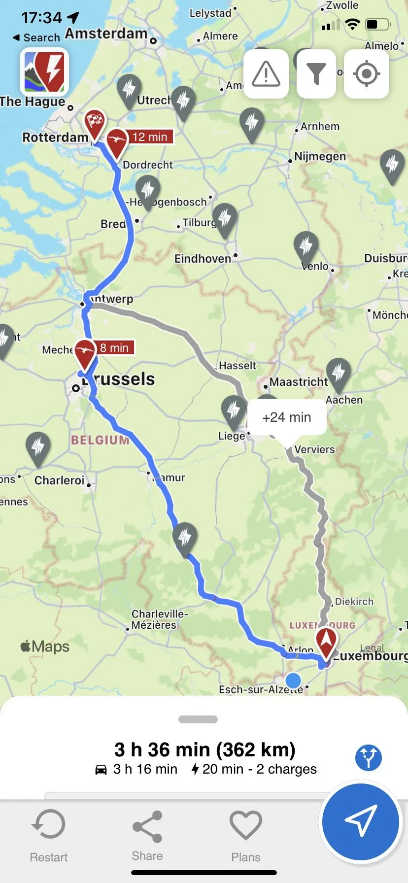

How's this? Make sure you set Ionity as "Preferred and Exclusive" in the sidebar settings.
Hello Submatrix, thank you for your response, I really appreciate your help.
I got this proposition too but wanted to add a second charging stop close to Rotterdam "Sandelingen Oost" in order to arrive with about 50% SOC.
As I want to precondition the battery for speedy charging I manually entered the stopovers into the car planner, this is where all goes wrong and it puts the second charging station before the first and then I arrive with -x% SOC.
How can I plan this route in the car? Actually, the car does not even find Ionity Sandelingen. Tried it with a different route.
The "along the route" function also seems not to work properly.

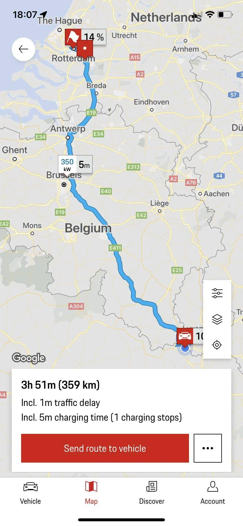

Here when I try to plan this in the Porsche app. I enter the final destination and then add the two IONITY Charging stopovers in order to arrive with 50% SOC at my final destination. In the final plan, it does not consider these as charging stations, see image below.
Porsche Taycan 2,500km family roadtrip - Dublin (Ireland) to Athens (Greece) - in a Taycan 4S. IMG_0760 2
Porsche Taycan 2,500km family roadtrip - Dublin (Ireland) to Athens (Greece) - in a Taycan 4S. IMG_0761.PNG
What is wrong?
Thanks for any help.

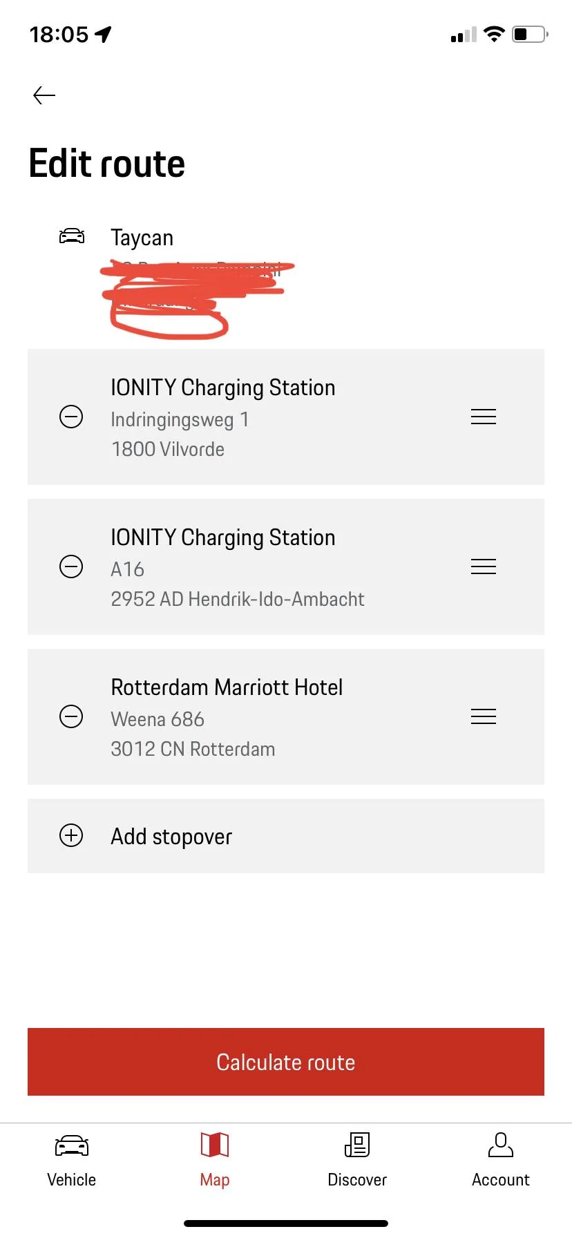

What is wrong?
The app doesn't take the charge stops in account. I had the same but you should sent it to your car and change it there. My wife did it today once we left. When I entered the Ionity station it automatically removed the charger it had planned. I do have intelligent range manger don't know if it makes a difference.

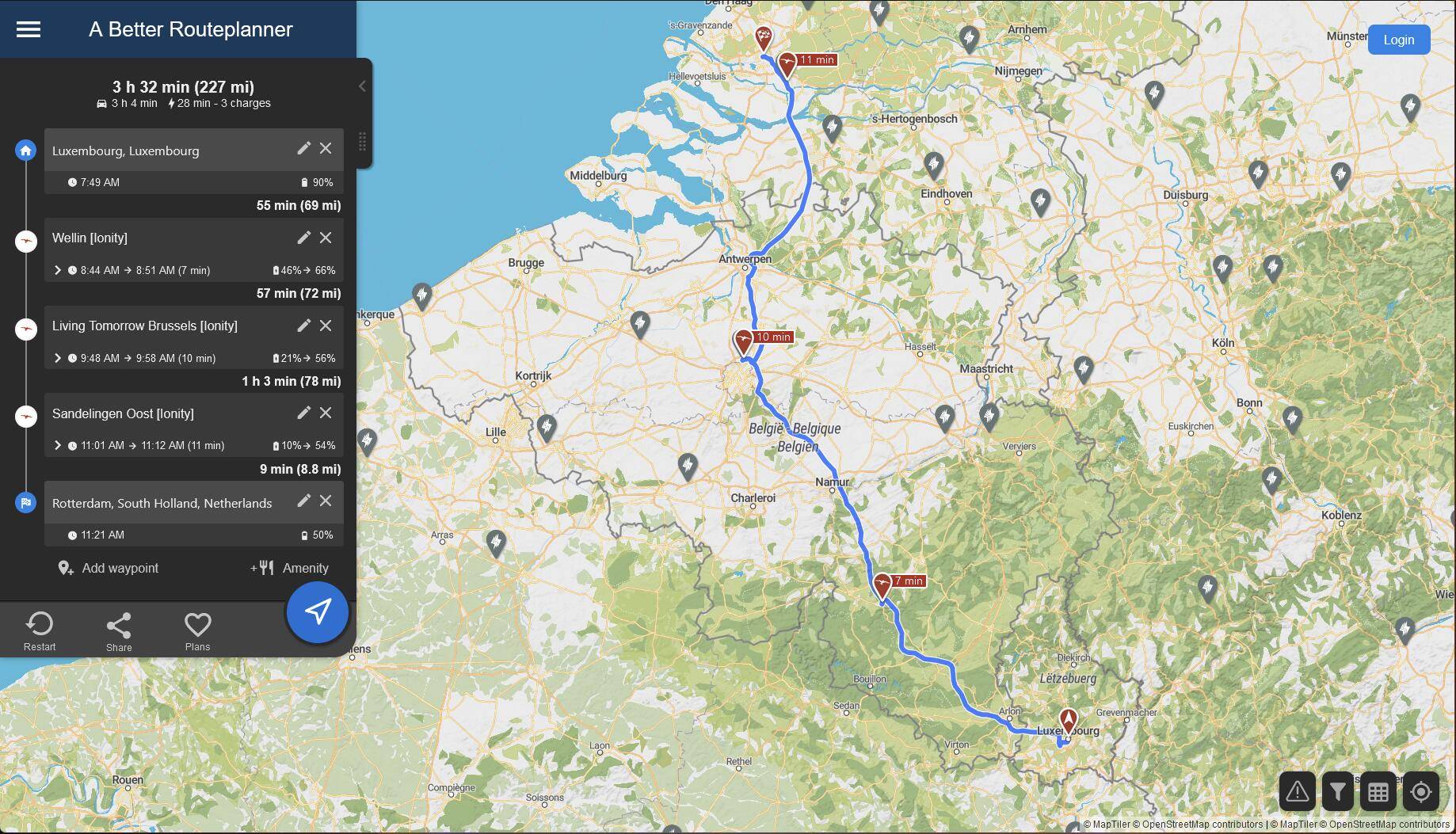

Not sure what happened on your end, but you can set your desired destination charge % in the settings. If I set it to 50%, this is what I get:
