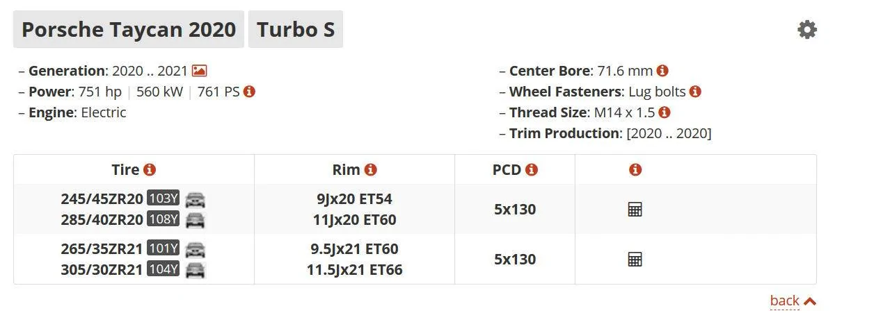

Anyone know if you can put 20" wheels on a Turbo S? What is the min bore size to clear the CCB's?
(I posted this in another "winter wheel" thread but have not gotten a reply...)
II can find 21" winter wheels and tires but the choices are pretty limited. If we can put 20's on the car it would open up a lot more tire options... With the CCB's, I think the bore clearance is going to be the defining parameter.
One of the 3rd party wheel configurators shows that 20" inch wheels are available for the Turbo S as an "OEM option" but the Porsche configurator does not seem to show this as an option...

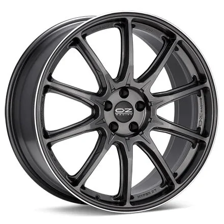

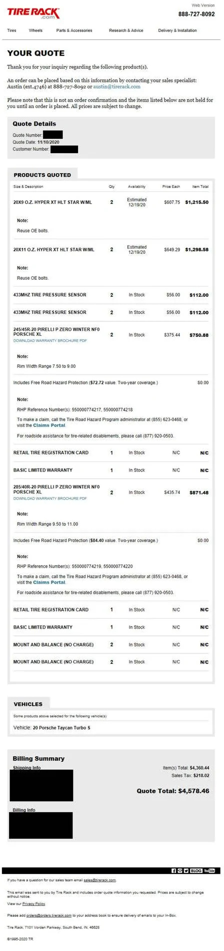

I just contacted TireRack about a pre-mounted winter wheel/tire set. They have been very slow this year in actually getting a kit prepared for the Taycan (covid?). They currently don't list any winter tire/wheel packages for the Turbo S on the web site.
Anyway, I started up an online chat session with a rep and he sent me the quote below. He says the 20" package specifically will work for the TurboS inc CCB clearance. He also says its a tough fitment...
The "graphite" colored wheels look fine I think. They are "winter wheels" in any case so I'm not inclined to spend a bunch of money on them just so they can get beat up by snow, ice, salt over the winter. However, it looks like the wheels (from Italy) are back ordered until mid-December.
Porsche Taycan 20 inch wheels on a Turbo S?  (Winter Wheels) wheel
Anyway, the $4600 price includes TPMS Sensors, mounting, balancing, and delivery. All you have to do is jack up the car in the driveway (or on a lift ;)) to swap the wheels...
He also tells me they should have the web site updated "soon"...
The customer rep's contact info is included in the quote below if anyone else is interested...
Porsche Taycan 20 inch wheels on a Turbo S?  (Winter Wheels) Sanitized Tire Rack Quote
Yes of course you can put 20 inch wheel on the Turbo S! But no smaller than 20s.

However not every 20 inch wheel will fit (despite the bolt pattern, width and offset).. The inside barrel of the wheel will have to be large enough to clear the CCB rotor/calipers. (I went through this with 19 inch wheels and the CCB's on my M4...)

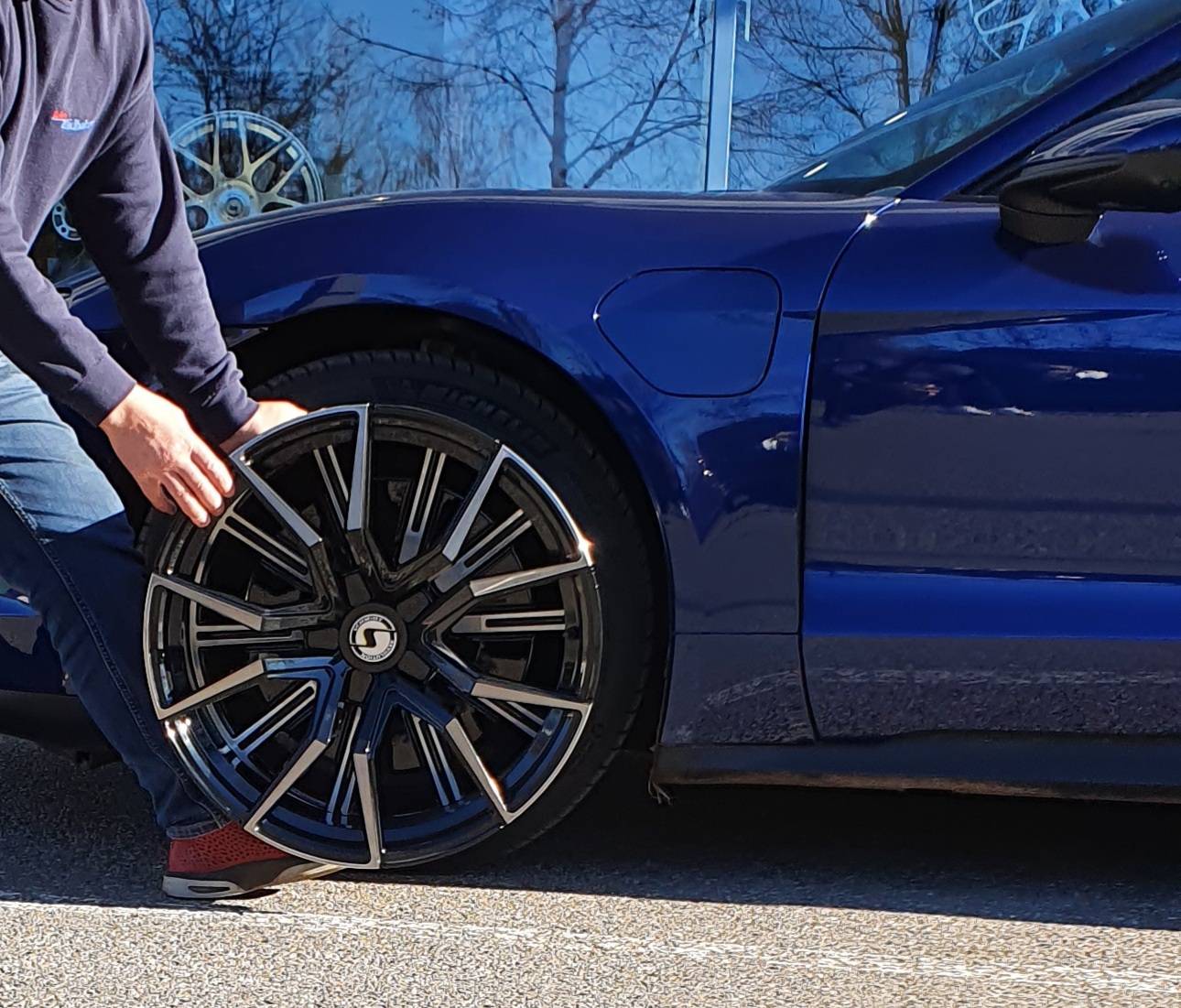

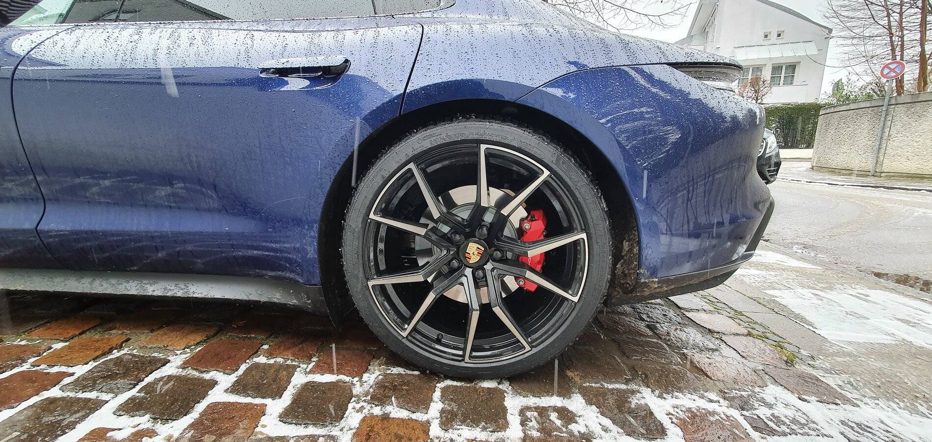

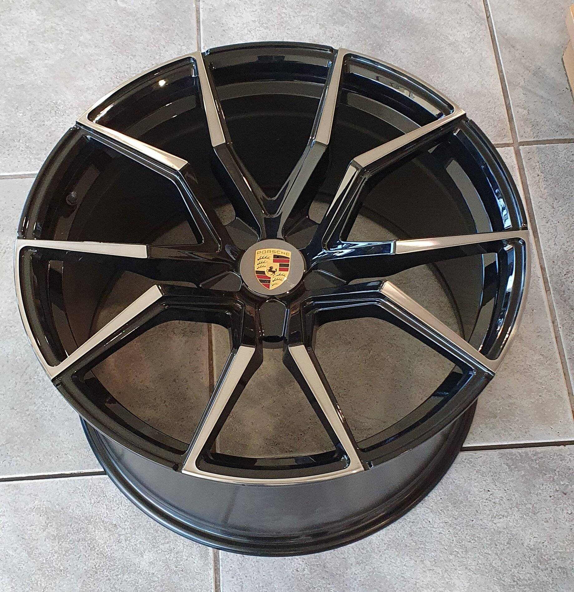

Hello,
as a datapoint, I just bought these 21" wheel rims (Schmidt Revolution Drago "Hellcat") with Michelin Pilot Alpine XL 5 winter tires. The manufacturer was quite interested in getting them onto a Taycan and is sponsoring an extra expertise for the car/rim combination (this is mandatory in Germany). Maybe in about 3 weeks we'll see the result. Price: About 4,800 Euros excluding tax, but including the small stuff such as mounting, tire pressure sensors and so on.
Cheers,
Henrik
PS: The picture is of the demo wheel without bolt holes.
Porsche Taycan 20 inch wheels on a Turbo S?  (Winter Wheels) 20201114_155240
Porsche Taycan 20 inch wheels on a Turbo S?  (Winter Wheels) 20201114_155307

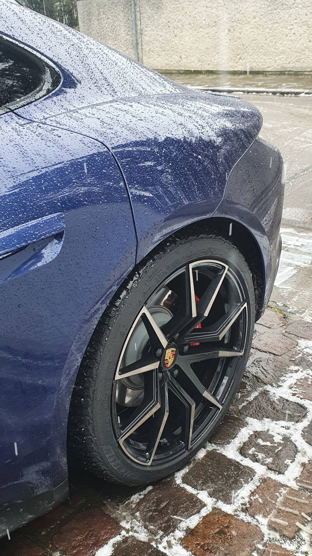

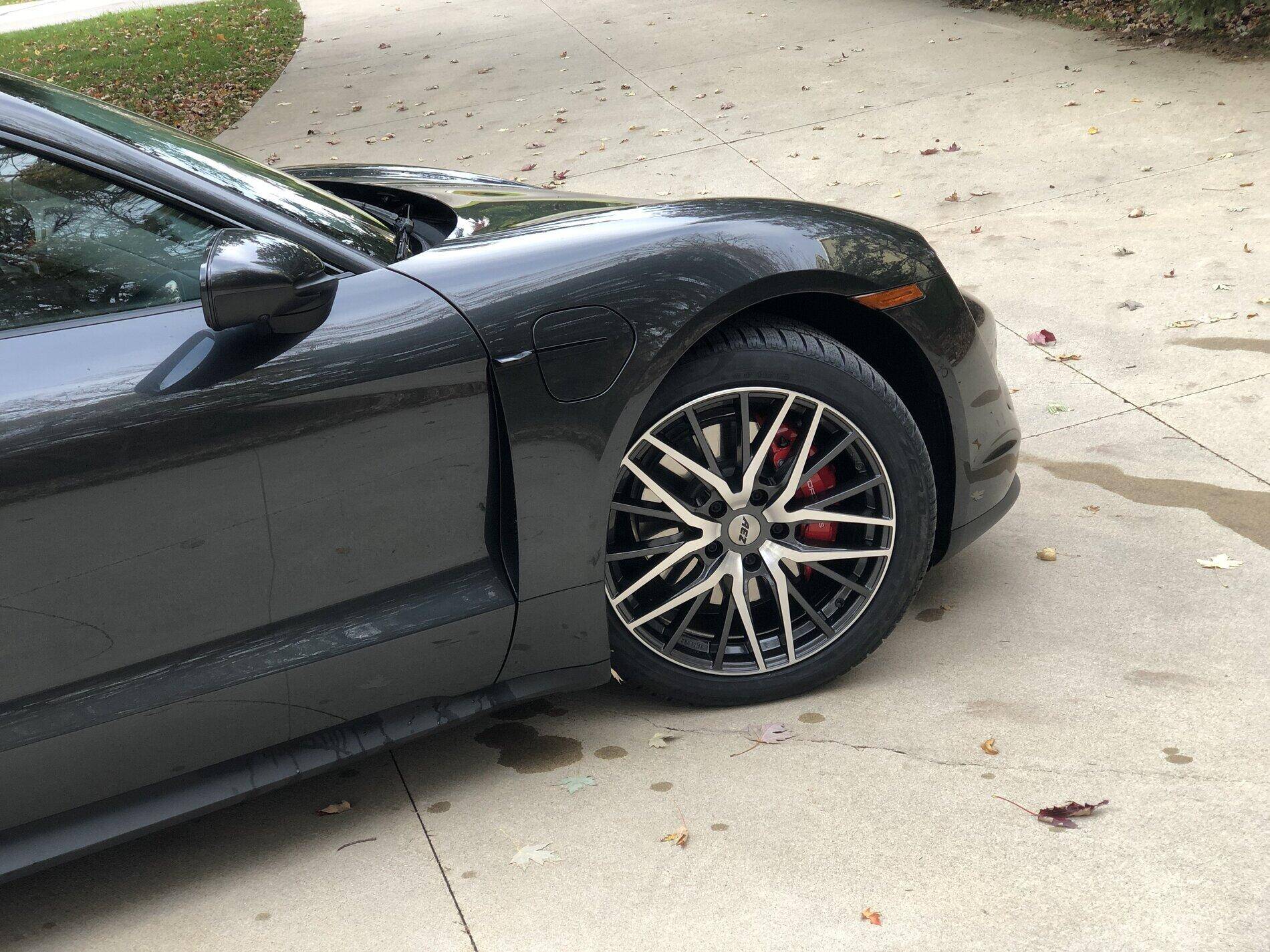

The 20" AEZs I have seem to work well for Turbo S / Turbo.
Porsche Taycan 20 inch wheels on a Turbo S?  (Winter Wheels) 1606575793759

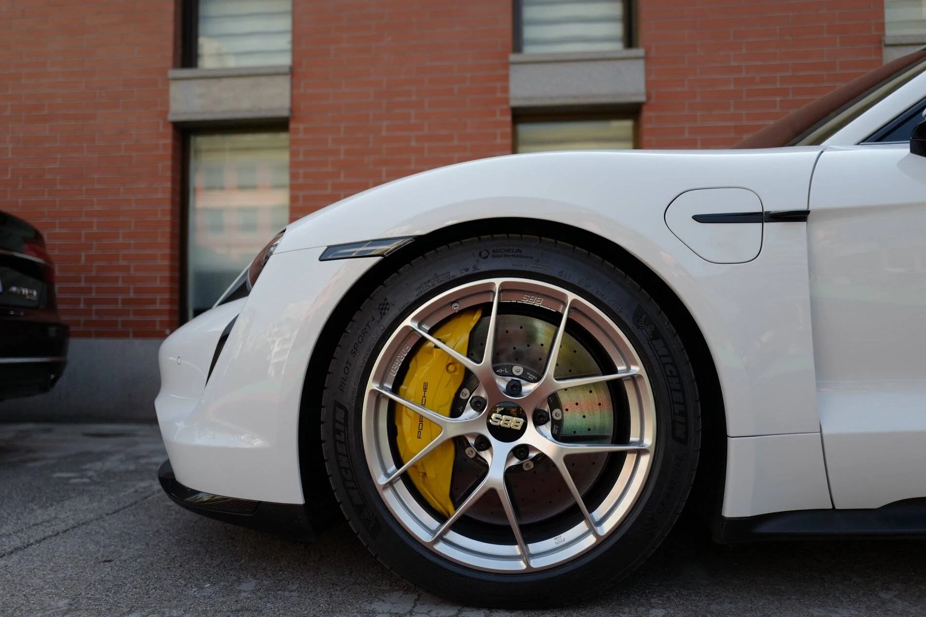

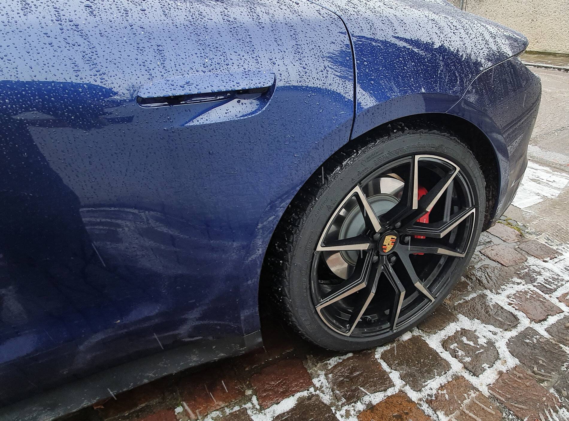

BBS FIR 20” will work, barely....
Porsche Taycan 20 inch wheels on a Turbo S?  (Winter Wheels) 59BA73E4-7185-415C-8A99-5CD078FF754C

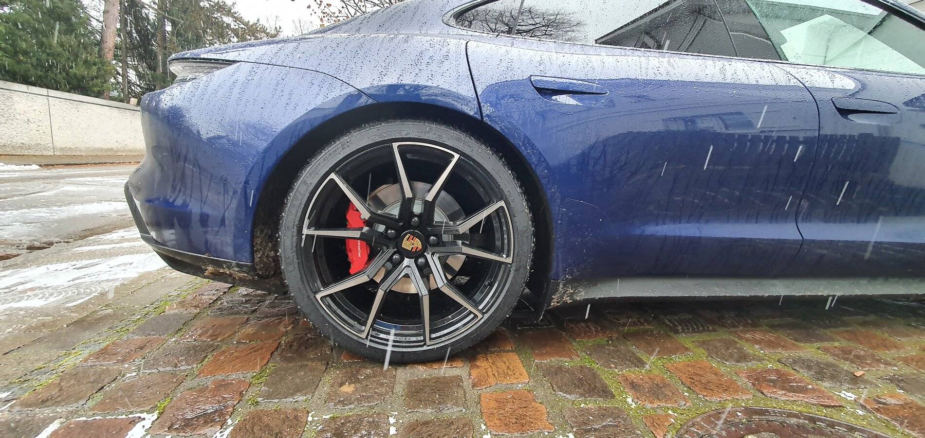

Here they are: 21" Schmidt Revolution Drago "Hellcat" with Michelin Pilot Alpine XL 5 winter tires.
Cheers,
Henrik
PS: Source: Reifen Widholzer, Riemerling, near Munich.
Porsche Taycan 20 inch wheels on a Turbo S?  (Winter Wheels) T4S_Winterwheels-2
Porsche Taycan 20 inch wheels on a Turbo S?  (Winter Wheels) T4S_Winterwheels-3
Porsche Taycan 20 inch wheels on a Turbo S?  (Winter Wheels) T4S_Winterwheels-5
Porsche Taycan 20 inch wheels on a Turbo S?  (Winter Wheels) T4S_Winterwheels_1
