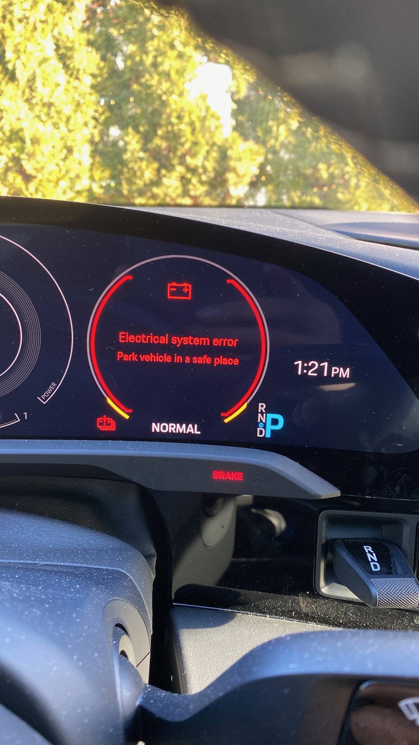

I knew getting a 2020 would make me a beta tester but I didn't think it would be this bad. My card was dead about 5 days into ownership. It had to get towed in. It had the 12 v issue. It went back a few times to get updated. It was doing fine for many months. Then in the last 3 months it would only charge to 60 something percent. I had it set to 85%. I would hit direct charging and sometimes it would go to above 80% but rarely hit 85%. I would see a charging error listed on the app. Then one day it was dead in my office parking lot. It got towed in again. So what they found was there are 2 issues. I need a new charging cable. That must have been the charging issue. I also need a new high power battery. The service manager said Porsche hasn't published anything but he's hearing about this happening to 2020's. They are going to put in a 2021 battery when they get one. Hopefully that solves the problem. Thankfully I wasn't driving when it died.

What is their solution for you while you wait for a battery? How long did they expect you’ll have to wait?
I have a Macan base loaner. Not quite the same as a Taycan turbo but it’s nice enough. I set it up for the long haul and put in my phone mount and charging cables and all the daily need stuff I keep in my car Bc I suspect it will be awhile. There is a battery they located in New Jersey. I live in Illinois. So they are trying to get it. The charging cable is coming from Germany. The service advisor who is now a friend Bc I’ve dealt with him so much with this car, said 1-2 weeks to get battery. So I’m guessing a month. I might ask to see if he can get me a Taycan 4S in the meantime. He even said that Porsche should do something for me like cover a few payments. I paid cash so I don’t have any payments. 3/4 of my mission E wheels have paint damage. So I might ask for them to fix those to compensate me.
According to this post and the linked Porsche service bulletin, you are indeed getting an upgrade to the 2021+ battery with updated cell chemistry.
I read a couple of posts stating that the traction battery replacement labor was around 4-5 hours, but I can't find them now. So apart from the wait time for the new battery, it seems like you are fortunate to be receiving a free battery upgrade.
