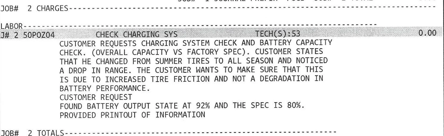

dealer inspection @ 18k miles - I had them pull the battery capacity - it reports 92% - if it was below 80% it would trigger the warranty…I'm a bit disappointed at 8% capacity lose in less than 2 years and 20k mile - none of my Tesla's or 2 Bolts showed that type of battery degrade…

so my 2020 Taycan Turbo is down 8% in 18 months of ownership about 0.44%/month battery capacity loss…
this is only a number reported by the BMS.
PIWIS provides 2 different state of healths (SoH), a fast and a slow value. I suppose they stated the slow value. Can you provide the mentioned printout of information?
There are also many more possible ways to determine the aging of a battery by comparing the cell valtages and SoC etc.
I would not be really concerned about that SoH value, either in the winter (okay Santa Cruz is probably not that cold) or if you did not see any real world limits, like your range is really down by 8% and you observe 8% less energy going into your battery when charging.

Really interesting that someone has published the results of a capacity test. Do you know the cost? Thinking it would make sense to have the test done once a year, maybe when getting the tires swapped. Do you know anything about the test protocol itself? For instance, is it affected by temperature, is the capacity actually metered or is it a calculated capacity?

dealer did it for free as part of the 18,000 mile inspection and latest safety recall.

ahhh but I have noted a loss in range - when I first got the vehicle I used to be able to drive 260-270 miles - but recently I’m lucky if I can eek out 220 miles from a 100% charge - I used to think the range loss was due to moving to summer tires from all season, but now I believe it’s a combination of grippier summer tires and the 8% loss we have now measured…
270 miles * .92 = 248 miles…range with no other factors…
my 2020 Turbo Taycan is definitively down on range…and this 8% measured capacity loss is a factor in that change in behavior.

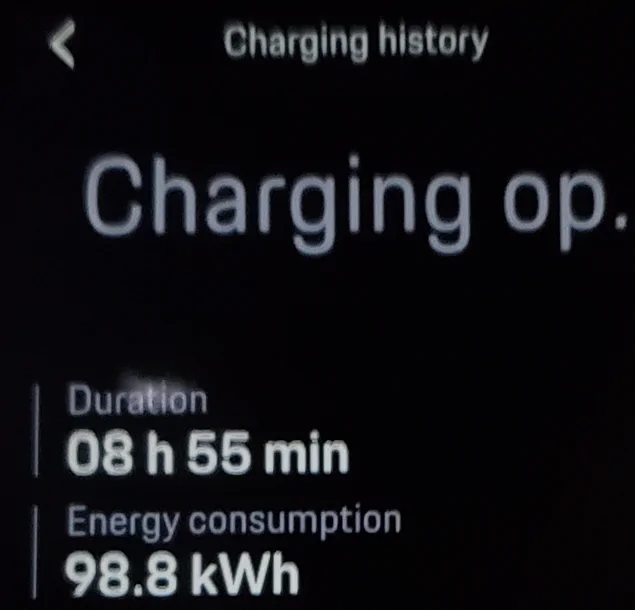

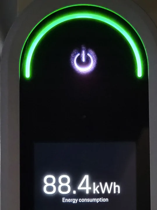

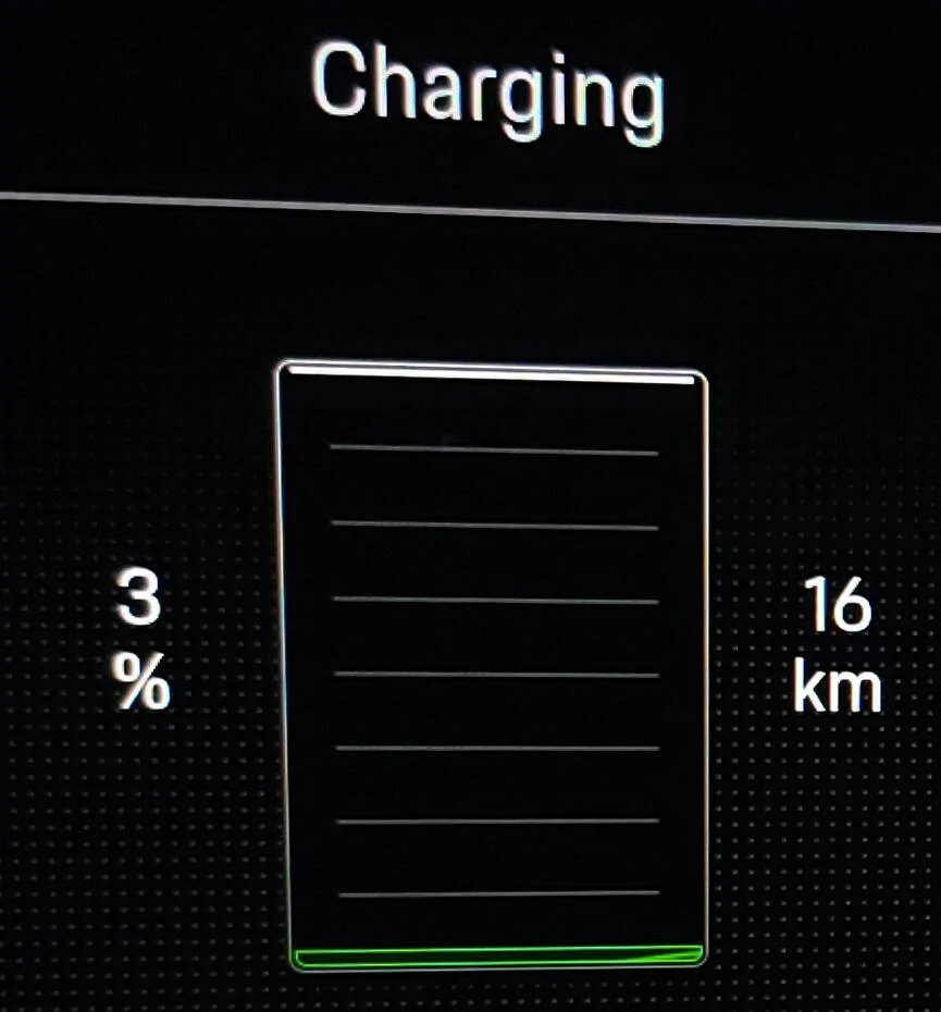

Last year, when car was pretty new, I charged from 0 to 100% and used 98.8 kWh displayed by the PMCC. Recently charging from 1 to 100% I only use ~78kWh. Outside temp is maybe a few degrees lower, but should not be relevant.
Battery shows clear degradation suddenly since October. The predicted range stays pretty stable, though...
Hmmm both those numbers look suspect. If taycan can take 85 KW usable charge then 98 would imply a LOT of loss or other filling/heating process.
Same with 78 KW, that is almost 10% loss which again seems suspect. What is measuring the power delivered?

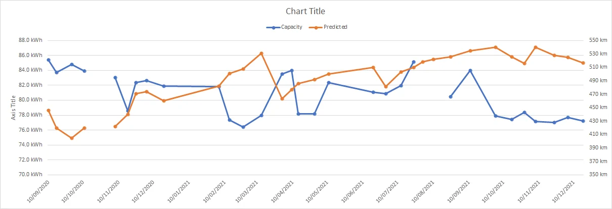

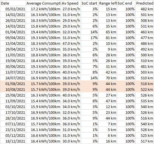

can you explain your Y values on you chart a bit please?
And 98.8 vs. 78 kWh sounds way more like some measuring errors, nothing that would make sense to compare.
Is that the best way to check degradation without PIWS?
the only valid 100% solution is to check the amount of energy that is stored by discharging in a controlled manner.
practical solution not beeing too bad would be checking longer trips and compare Start/End SoC displayed with the avg. consumption x trip lenght and ideally with many samples(trips). Be aware that the amount of enegry drawn out of every battery is less when using higher currents than lower ones.
You might be right. I think I used a timer with precondition, but recently I switched off the preconditioning on my timers. That was sloppy. I need to make a test of two very similar charging sessions and see what the difference is.
EDIT: Just saw, that the precondition on the timer was on.

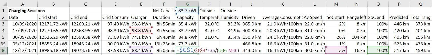

The km on the right Y axis are the predicted range:
The kWh capacity on the left is calculated by:
taking the net capacity of 83.7 kWh divided by the charging value from when the car was new 98.8 kWh (charging from 0% to 100%)...
...times the recent charging value 88.4kWh...
...divided by (SoC end 100% - SoC start 3%).
I am not a gifted math guy! Does that makes sense?
I see now, that the average consumption was quite a bit higher before, but the average consumption for the year 2021 was a stable 17.0 kWh/100km.
PM me if you want my Excel sheet. :)
