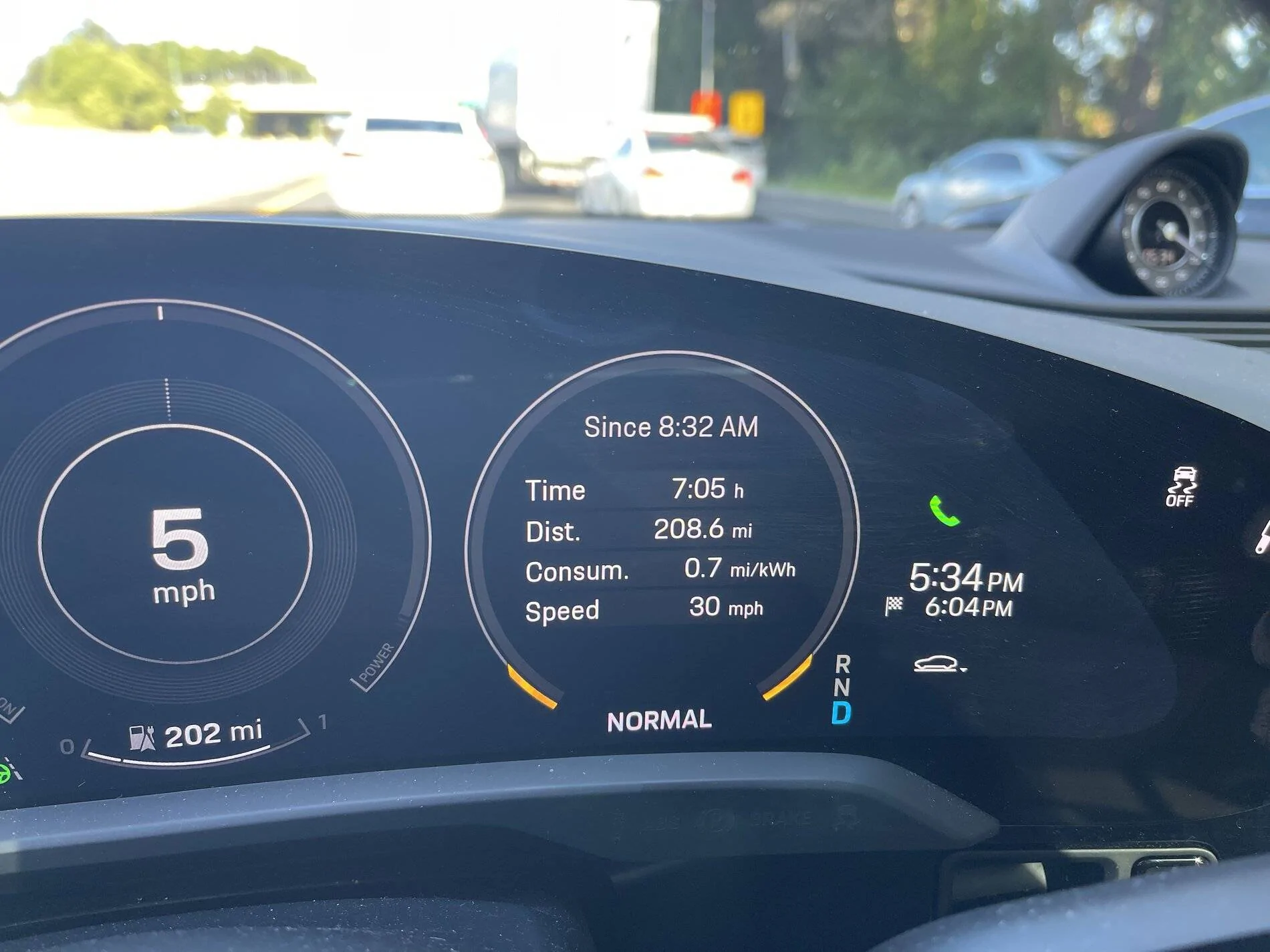

One issues so far post update - the consumption figures in my trip computers are “wrong” - the math it makes no sense…see below for an example - I’ve done a full round of trip computer resets and it “fixes” it for a bit - and then it reverts to nonsense numbers sometimes later
can anyone confirm/deny if their consumption metrics are correct post update?

410.6 mile range is amazing......
I have never had an issue with this. Everything has worked well since update (so far). You have nav going and that now changes the range estimate below the speedo.
