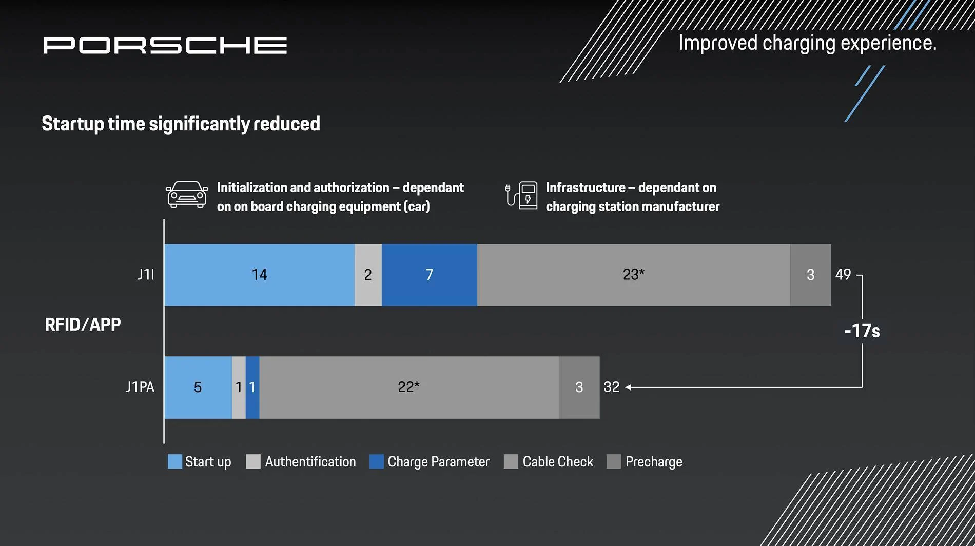

Takes c. 30secs from connecting to charging start.
Porsche says it has knocked 17 seconds off the charging start time when using RFID/APP and presumably similar for plug & charge:

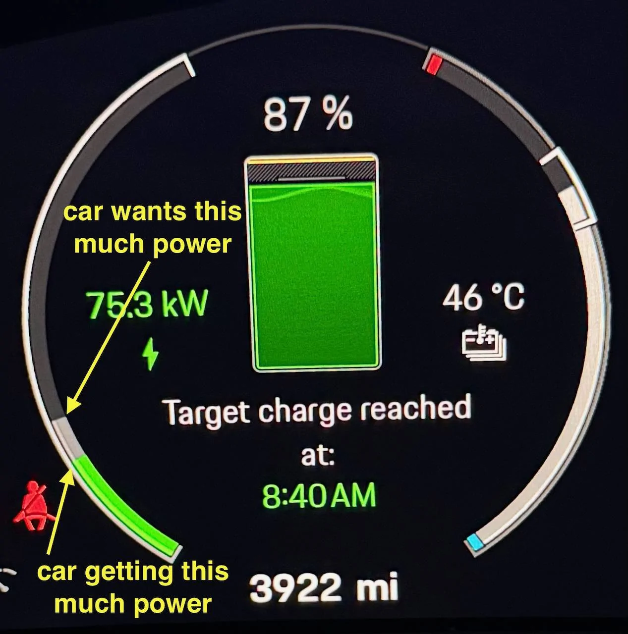

Good to read that one can take advantage of faster DC charging in England.
New England 350kW EA chargers seem to all reduce the curve to fit under ~200kW.
that's a bummer!
The new battery display now indicates if the charger or car is limiting the charge level.
