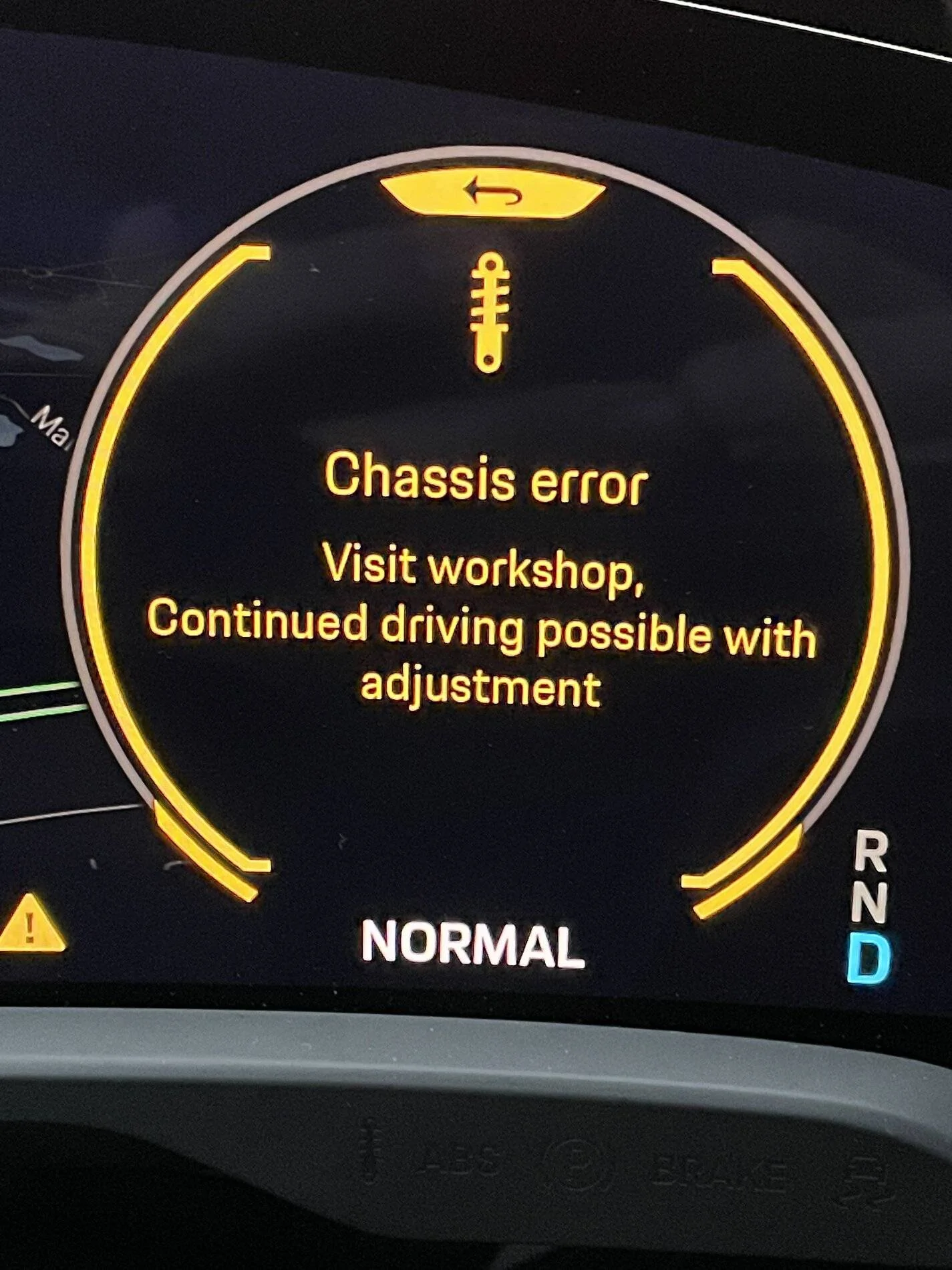

Anyone have issues with their Taycan. Got an odd chassis error issue. Took it to the dealership. Found out wiring harness got snapped as the suspension moved up and down. Apparently it was routed incorrectly during the build. Now waiting on parts :-(

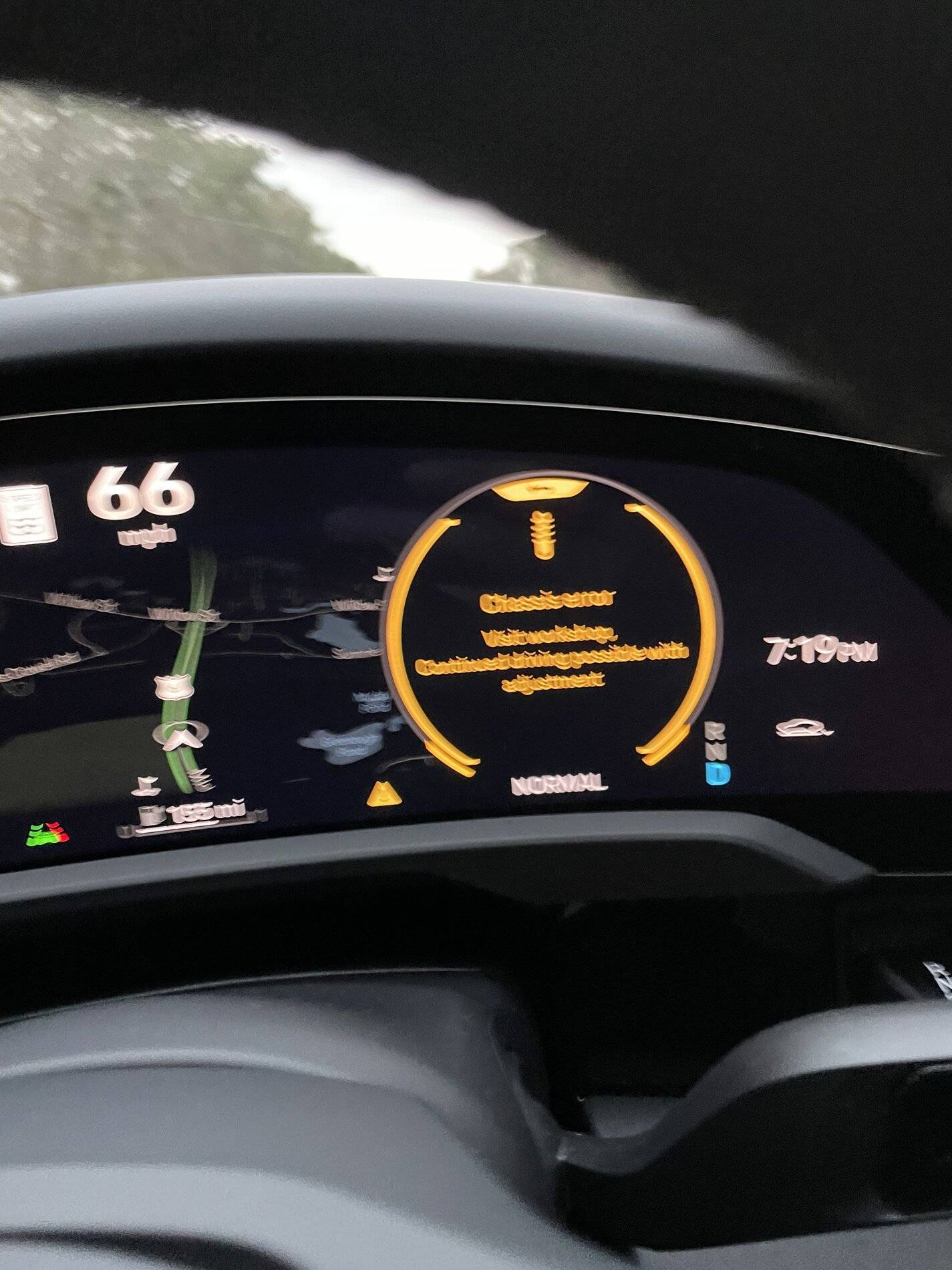

I just had this exact thing happen to me this week. I pulled over and restarted the car and it has been fine since. I have an appointment with the dealer in a week. Sounds like it’s going to be fun.

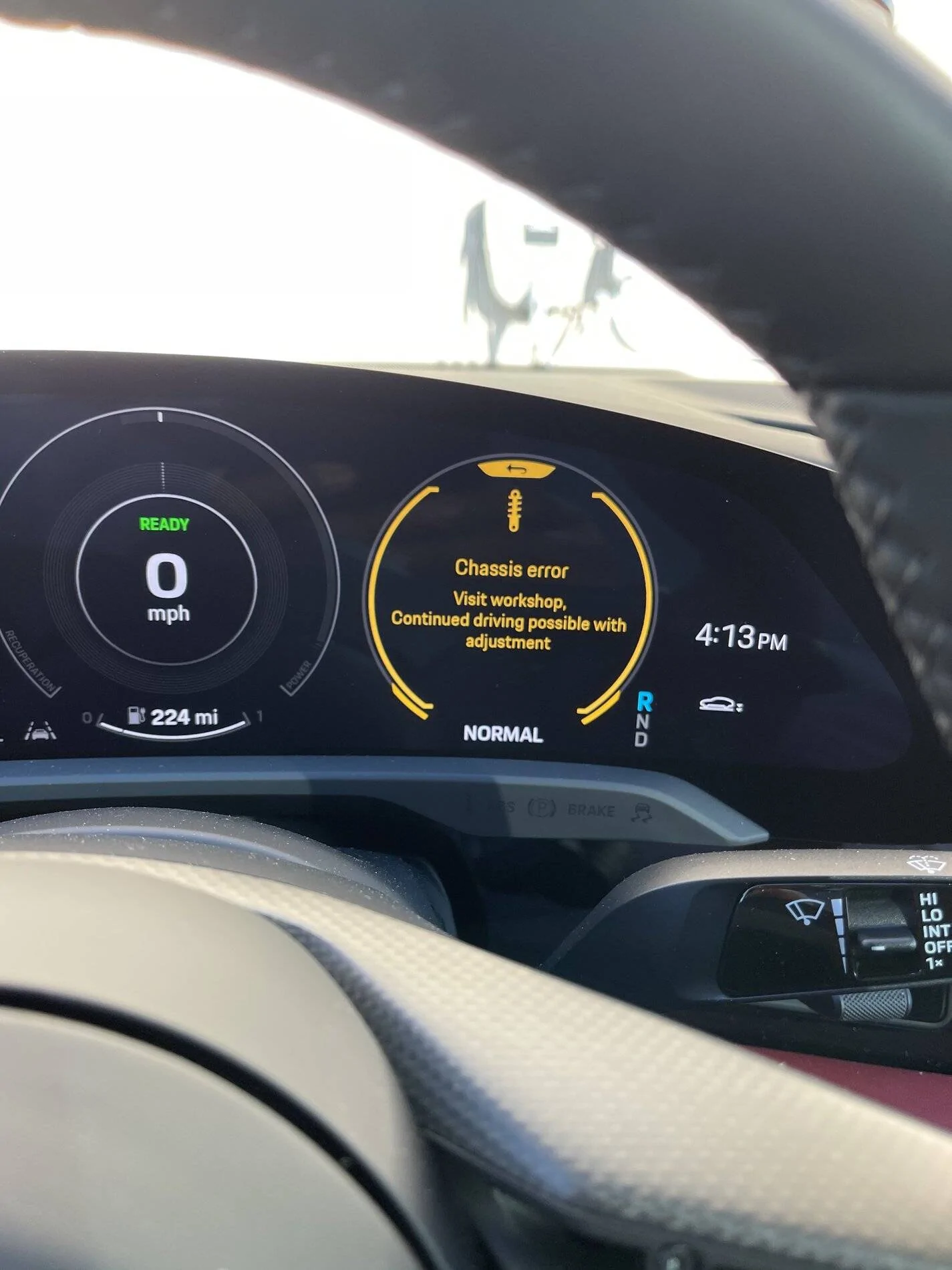

I read something about a Porsche telematics host application trying to talk to vehicles several times a second vs. once an hour - that this may have contributed to this issue. It was supposedly a bug created in an update in their back-end, and they've since fixed it. That was posed as the explanation why a lot of people seemed to have had this same symptom on the same day(s).

Yep, it is allegedly a faulty update that didn't work over the OTA and was canceled by Porsche. Triggered the alert. I got it and it went away after I turned car off and restarted
