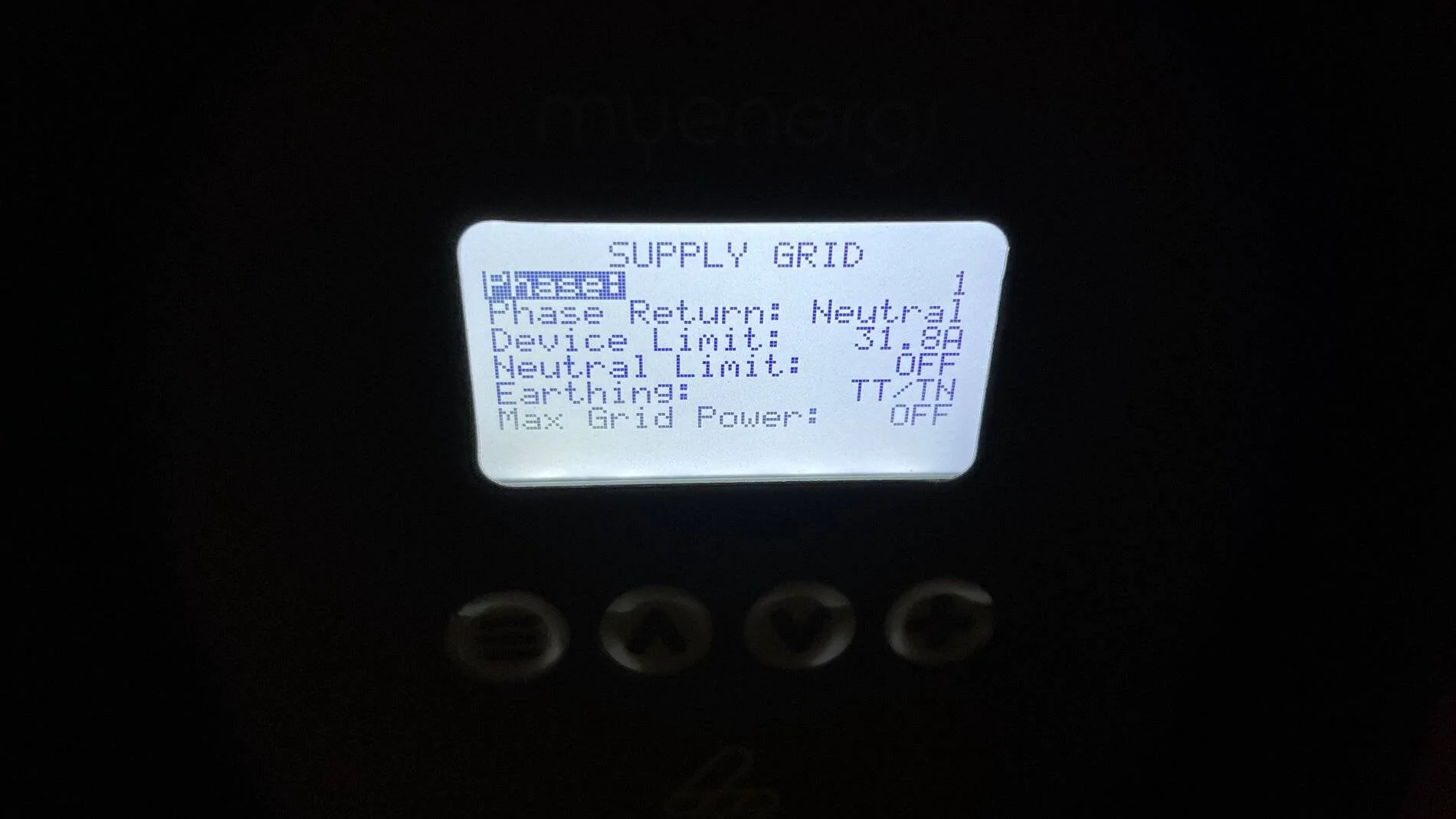

I have a Zappi V2 charger at home and have just set it to pull from the supply gird a maximum of 25A (6kW) down from the previous 30A (7.4kW) based on this info.
I feel like I am being a little reactive, but this reduction won't have that much impact on me – at least until we collectively try and find out more concrete info from our various routes into Porsche.
Before dropping the charger down to 25A maximum device limit, it had been running at 31.8A.
