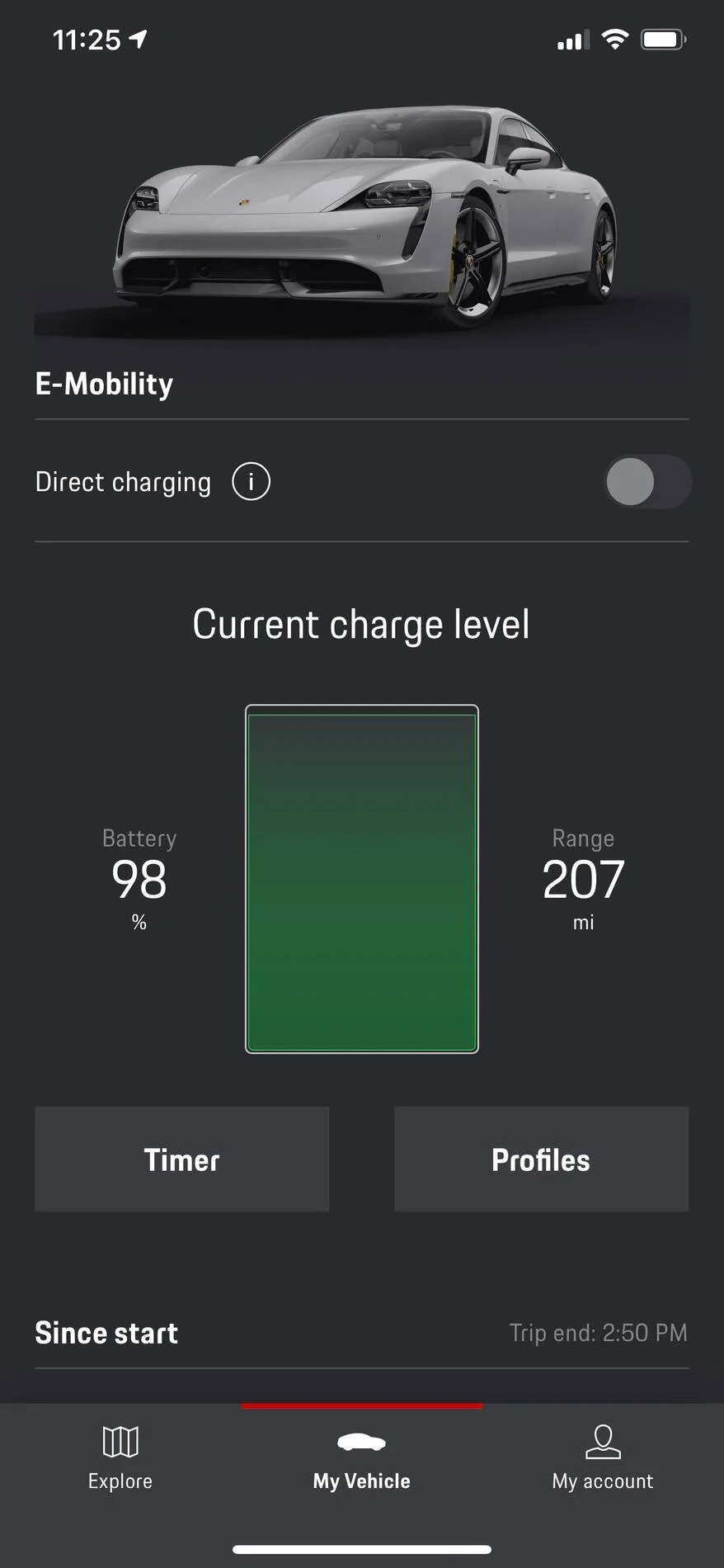

Porsche Taycan 254 miles real-world range at 75 mph around freezing 1614187575289
I NEVER Charge to 100% but the dealership did. It's still at dealer (12V battery dead issue). Here's my "guesstimate" range at 98%....
That is 211 miles at 100%. Looks like progress, no? Particularly with your sense of speed. Too bad about the 12V issues. Ruins the experience...

Your range estimate doesn't look far off for your area, depending on your driving habits.
I think its a function of temps being almost 50 degrees. Will report if I get it back and when I drive the battery down
