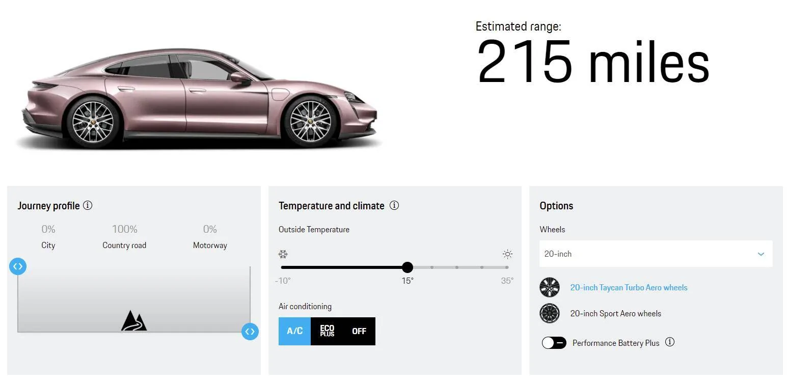

280 miles on Performance Battery in 12C - seems unlikely, are you sure as its way in excess of Porsche's own calculations?
Best you can expect at 15C (1 mile drop at 10C) with 20" wheels and other variation will see the range drop. Appreciate these are slightly conservative but not that conservative!.

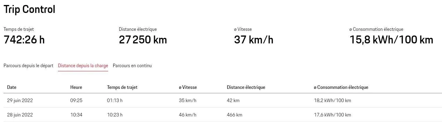

real consumption last trip 100%-5% = 466 km (290 miles) - 17.6kw/100km.

Better if you shared 'Total Since' km /kWh from trip rather than the somewhat meaningless battery range at 100% to get a real world average consumption for your car.

yes that's true, one is theoric and the real autonomy/consumption depends on many factor

dont know how they calculate the whole consumption but here is my stats
