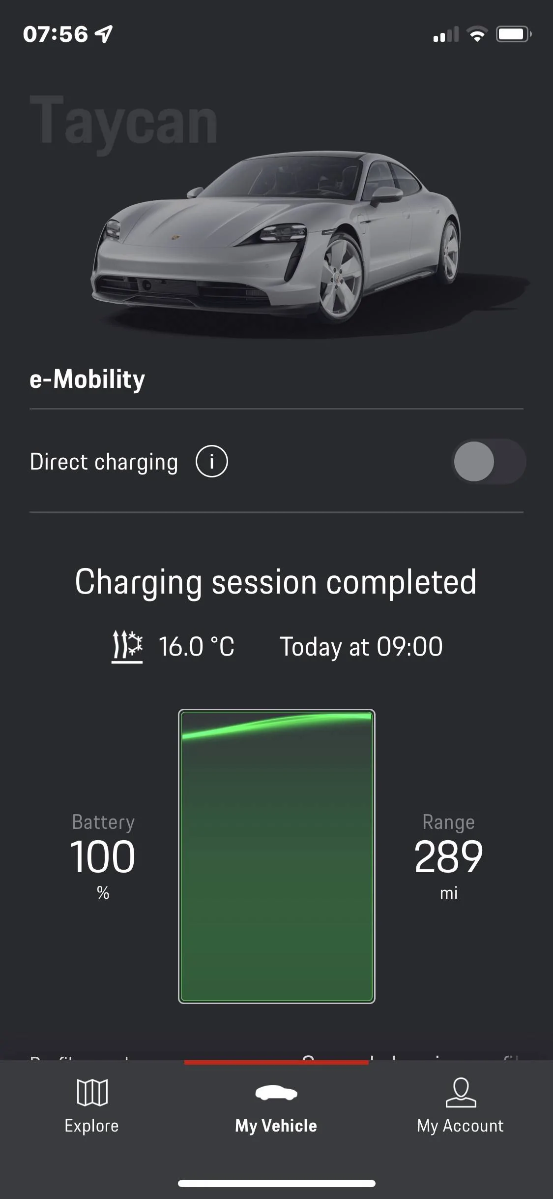

Good morning Folks,
My range on normal driving mode.
Thanks.
Porsche Taycan 271 miles!  100% charged. What’s your range shown? 291AF725-BFD5-4C9E-8A87-F8E4922521AC

Probably but the mystery for me is the battery display for potential range. I just can't see 300 miles ever being displayed.
I once had 280 immediately after a 350kW charging session. Battery was hot and when cooled the range readout dropped considerably to around 250.
This is why I rely on average consumption numbers rather than fictitious readings from the battery display immediately after charging or driving a short distance after charging.
Post AC charging readouts are more accurate in my experience.

Thx - and after 2 miles of driving what did the same display report?
Adrian,
Showed 285 miles. Did 220 miles & had 63 miles left when got back home.
Thanks.

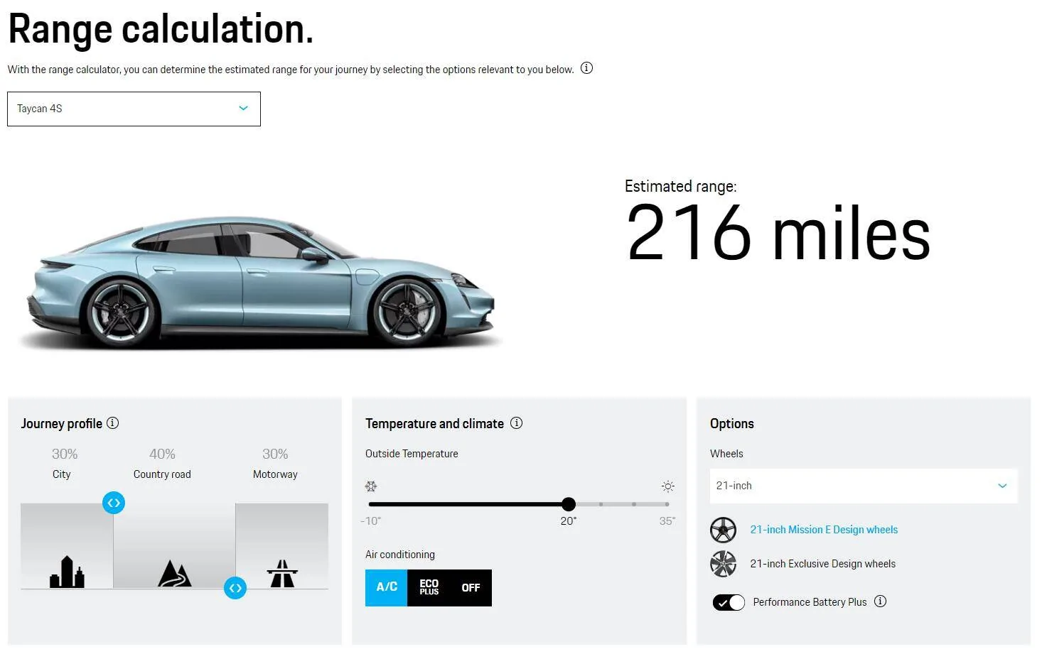

My max is 353 km (219 mil). I have 21" wheels and 305 rear tires. I have considered that I would try to swap them to 20" 2xx tires. Any idea how much this would effect the range?
Have a play with the Range tool on the Taycan web pages where you can play with the different wheel combinations etc to get a reasonable idea.
Don't expect massive gains or losses - 5 - 6 miles or so.
