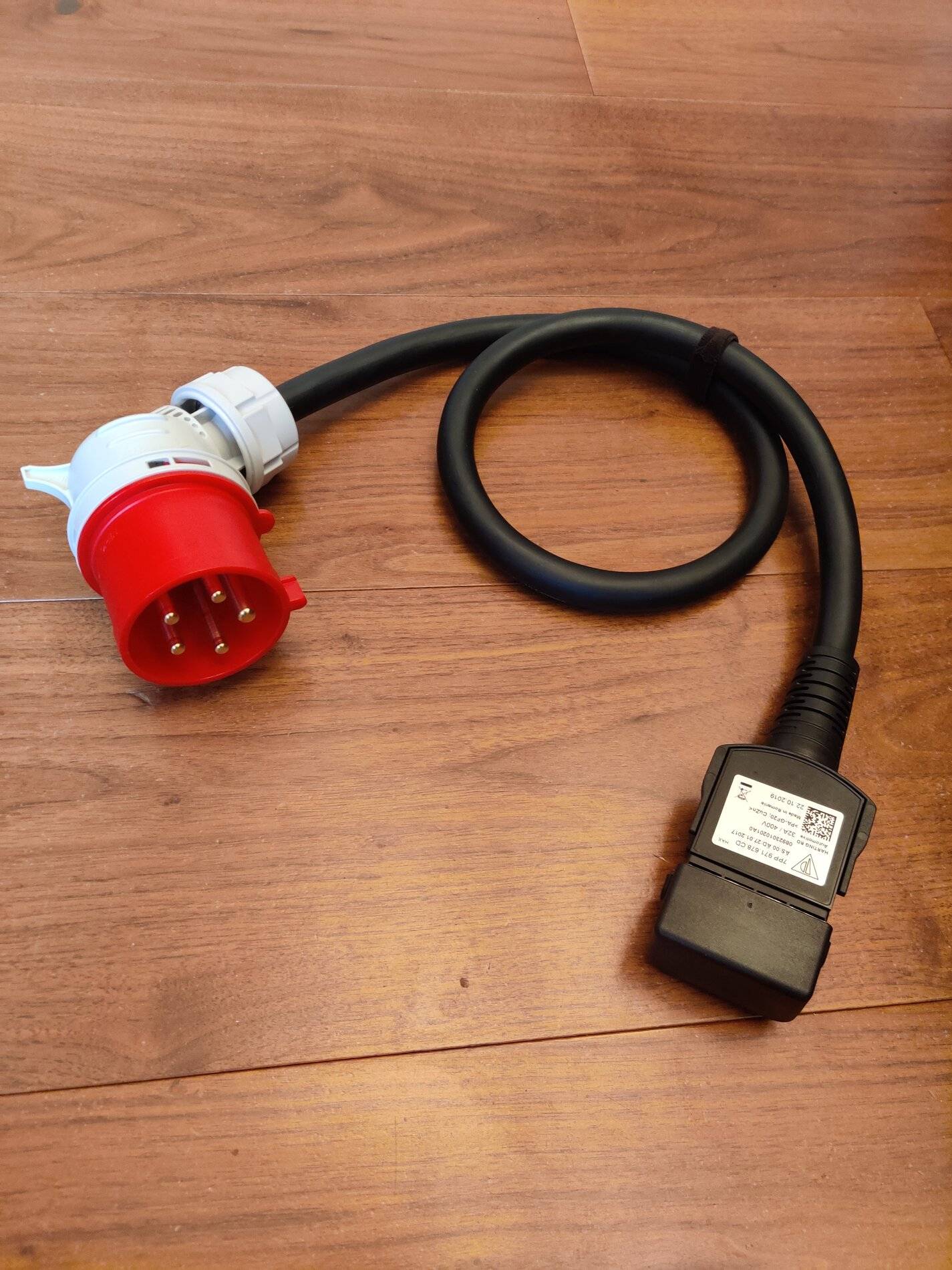

I found the 3 phase source cable for the Prosche Mobile Charger.
Took me a while as nobody understood what I was asking.
Part number is: P9588971678D - B35F charge cable In
It costs £86.22 in VAT
Porsche Taycan 3 Phase source cable for Porsche Mobile Charger IMG_20201210_125628

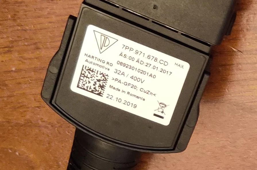

I listed Porsches part number on my original post.
This is the part number on the cable itself, does not appear to be made by porsche or have a porsche part number on it.
I did purchase this directly from the Porsche parts department.

Harting make the official Porsche public charging cable too.

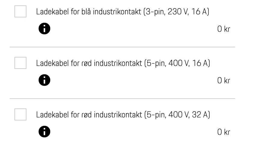

According to the Norwegian configurator, there are actually three of these cables.
Porsche Taycan 3 Phase source cable for Porsche Mobile Charger 1608229551840
One blue, two red (16 and 32 A), unfortunately no parts number given.

You probably want to get the 32A 5 pin if you are going to do 22kwh ac charging, seeing that single phase 32 amp is 7 kilowatt. 3 x 7Kw = ~21 kw
The one I posted a pic of is 32 amp.
Plus its easy to get converters off of Amazon. My house has a 63 amps red socket, so i had to buy a 63 amp to 32 amp converter.

I contacted them again and they found it, £86.50.
They said the part number I gave had too many 8's in it. Should be P958971678D.
Thanks for advise, am looking forward to using PMCC on 3 phase , 11kw
