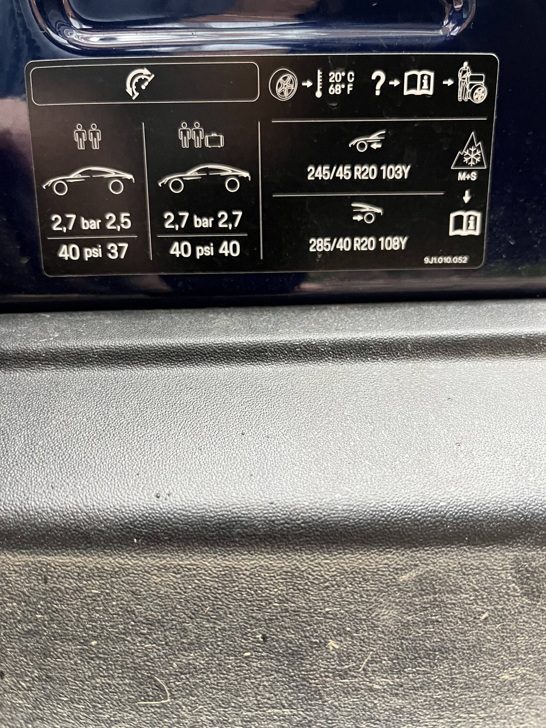

2. Porsche mechanics know more about the cars than me. Any idea why they'd pump all of the tyres (after unconnected warranty work) up to the same pressure when car settings/plate saying the rears should be 4 psi less?

2. Sounds like the person responsible for filling the tires needs training. I doubt Porsche would have its experienced mechanics perform that task.
Hmmm not sure why they even checked them!
Mine are the same on all corners at “2 person” loading.
When it’s “2 person + luggage” then the rears get 4 psi more and the front get 2 psi more:

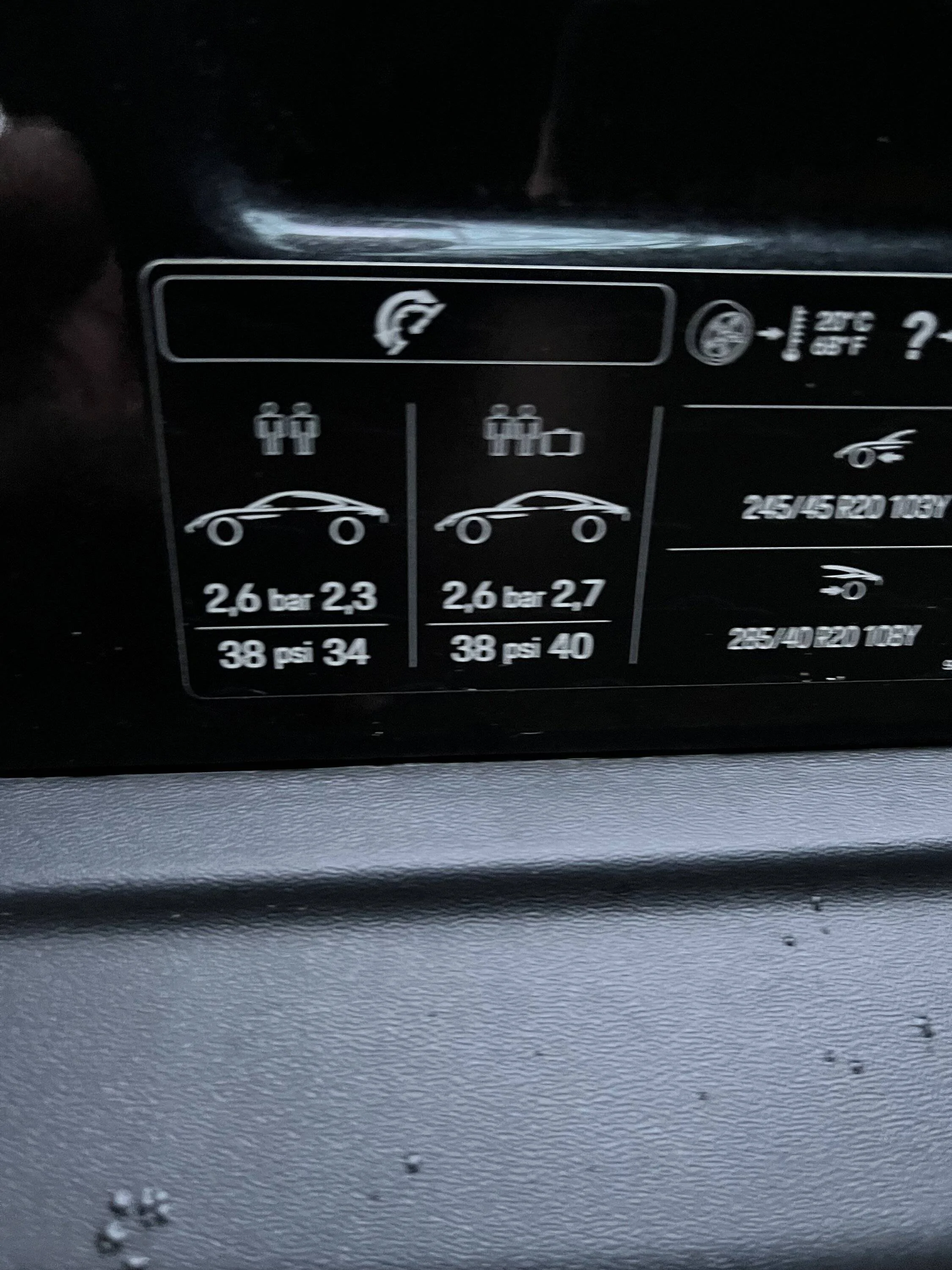

If your inflation plate rating is the same as @Midlifecrisis maybe the garage just go worst case to the full capacity pressures - that is even all round for the 20’s - by default? 🤷
Maybe they decided to compromise between the 2 settings -
38-34 light load
38-40 full load
