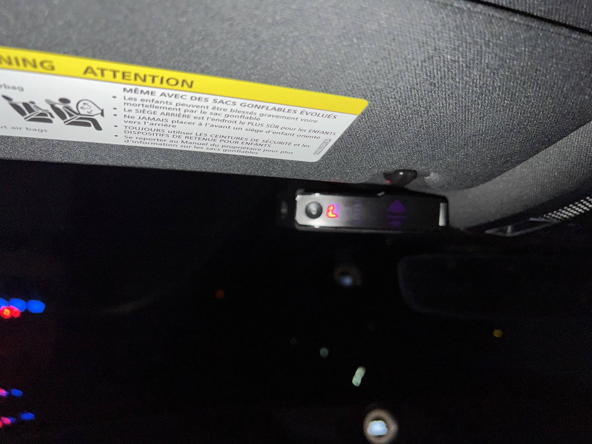

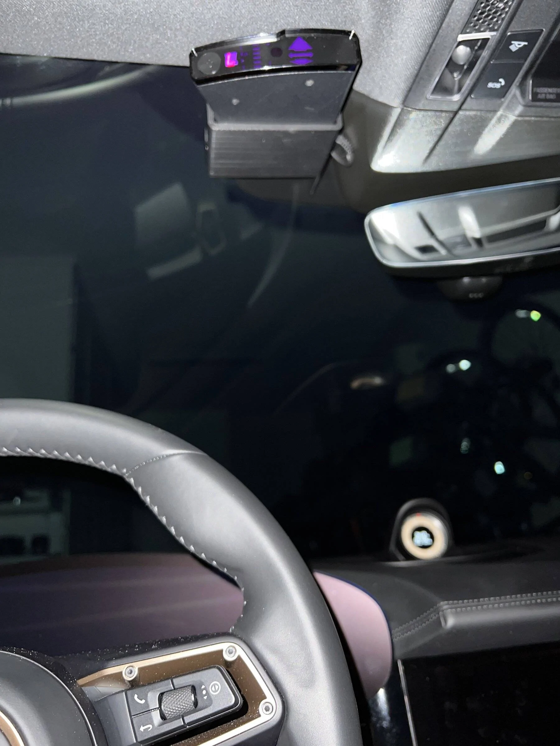

Just got back from my Road Test. Works great! I'm now getting all the alerts I expect. Moving the V1 to the left side of the mirror surely does help put the antenna/receiver into the sweet spot.
I also tested the JBV1 as @wemct suggested. Its a great app! It will likely replace Waze as my goto smart phone app when I have my phone mounted on the console! ...yet another great reason to keep your phone visible and accessible while on the road!

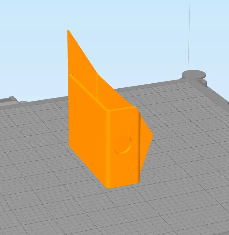

Additionally, I made a small tweak to the mount for those who might be interested. Those little "wings" on the front of the mount help keep the V1 aligned properly with the windshield. They also reduce the gravitational torque which might try and mis-align the detector over time. However, we likely don't need TWO wings. Although I'm a big fan of symmetry, here is another print file with the "drivers side" wing removed to minimize the sight picture of the mount from the driver's perspective. (Take a look at the second photo posted above and you will see what I mean). Its really not a big deal in any case, but might as well, right?

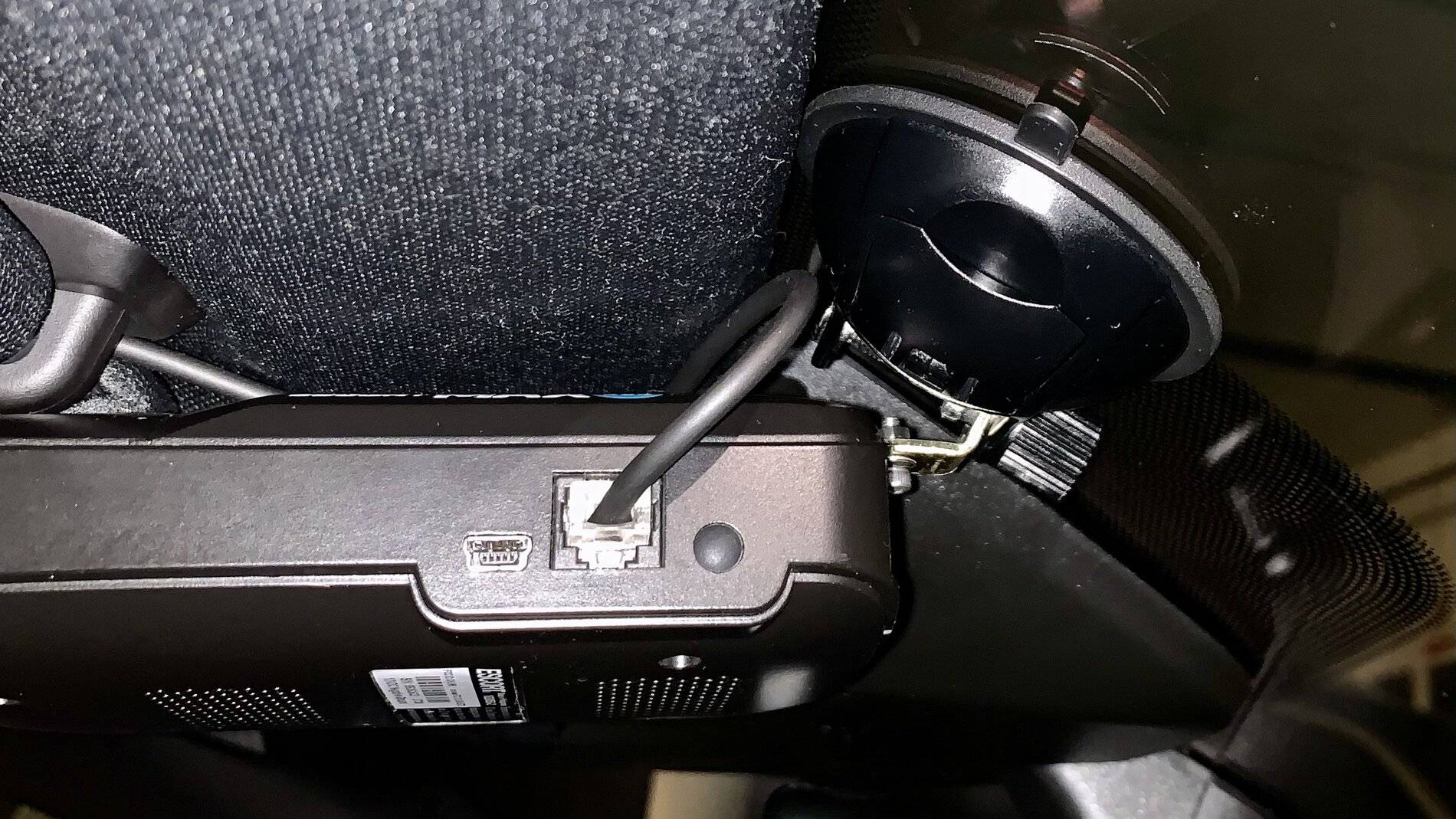

I finally mounted my Escort Max 360. As with the Valentine, the stock setup won’t allow you to mount the detector high enough. I used a brass corner brace to turn the suction cup sideways.

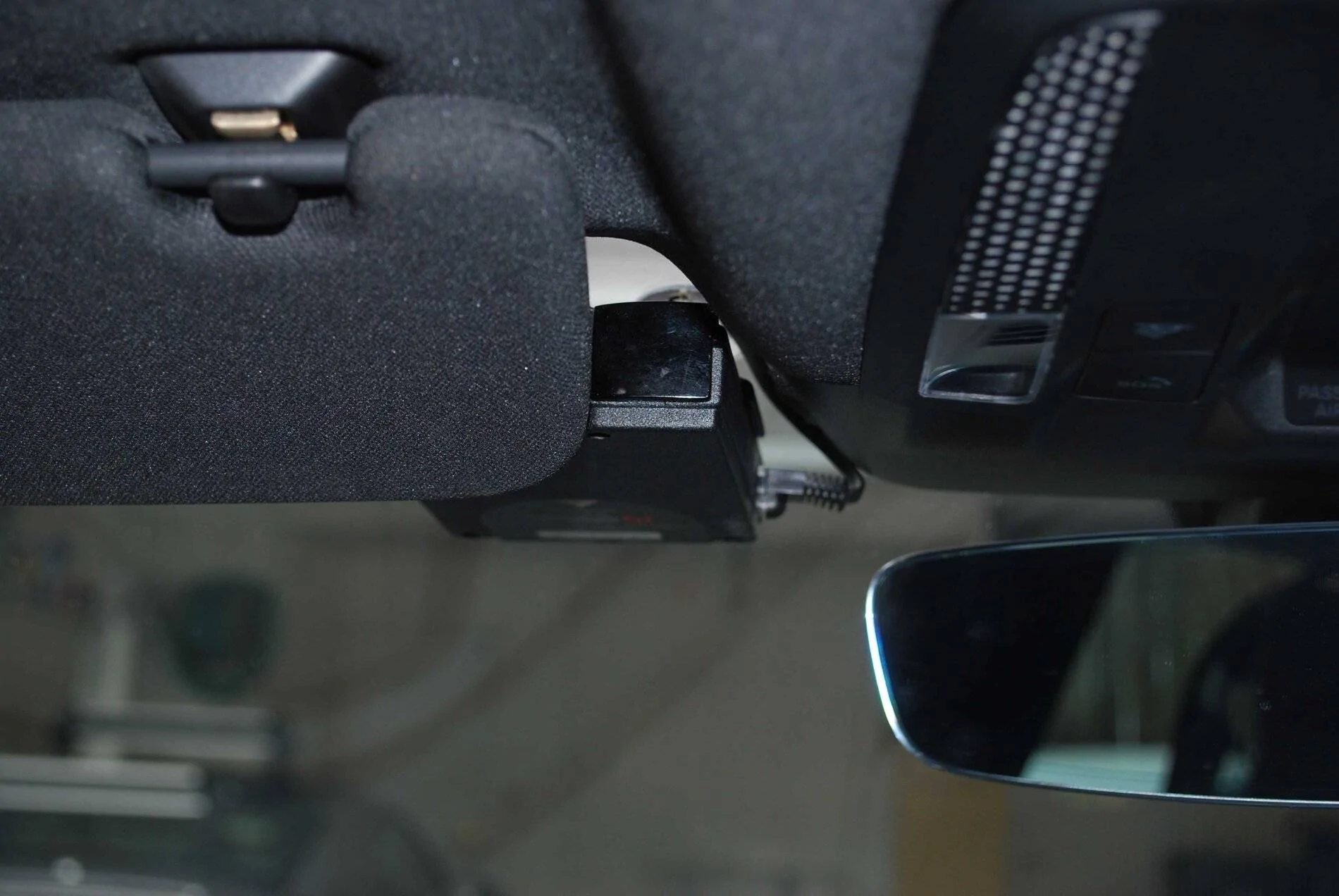

@evanevery I know I’m the idiot that suggested you mount on the driver’s side but I just realized you can’t fold your sun visor down???
Well.....if Gen2 has it's rear 'viewer' on the right side as with Gen1 there should be no problem in it peeking around a down visor. I 'hard mount' V1's on all the cars the same way w/remote on the column. Tay just uses suction cups for now.....no insulated glass.
Personally, I leave visors down always. Sorry to hijack your thread Ed. :) . Kudos on your mount work.
And apologies for poss stating the obvious, but just to confirm when you mount it like this you cannot then use the passenger sun visor, correct?
Actually, the Escort is far enough forward (towards the windshield) that you can partially flip down the visor, enough to block the sun. But it will also cover the rear antenna.
When I place mine in this loc I am having a hard time seeing how it can have a clear view through the recommended area of the windshield - are you getting good hits i.e. does it seem as effective as before when driving (realize hard to quantify).
I also wondered if we could invert this Escort and still have it work correctly? Would present all the controls (facing downwards) whilst placed flush to the roof liner - do you happen to know if this would work (I had not tried it myself as yet)?
Also is yours the std mount or the magnetic? Mine is the mag. and adds a bit of bulk up top in respect placement.
