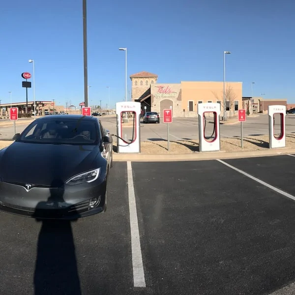

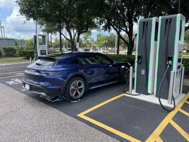

Picture your typical EA station with its 4 stalls. Now picture pulling up your Taycan to this. Granted, it's the only one of its kind, but it would be really nice to have the Superchargers available for our Taycans.
how many superchargers are like that one? this is what I saw almost 100% of the time
Like I said, it's the only one like it :) Tesla actually built a full lounge complete with a coffee bar, nice bathrooms, vending machines, and some tables/chairs for sitting. My main point being that Superchargers have a LOT more stalls than your average EA station.
