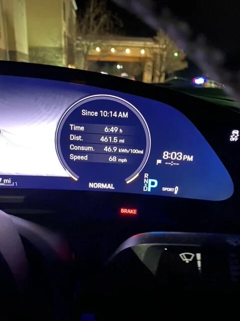

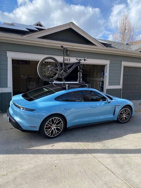

I drove 460 miles from Denver to Richfield, UT today with a 40lbs eMountain bike on the Porsche roof rack. Even though I picked up my 4s in the beginning of May, I am still experimenting with how it performs in all kinds of conditions. Today's drive was done on 20" Pirelli winter tires, and temps were anywhere from 20 degrees at higher mountain altitudes to 50 degrees in lower elevations in the afternoon. While in Colorado, I drove over two very high mountain passes, and in Utah there is one mountain range that peaks at almost 8,000 feet, so there was lots of elevation gain today.
I expected to experience less efficiency with the colder temps, and a size XL mountain bike on the roof - and the numbers bare that out. I would say that the vehicle was 15% to 20% less efficient due to the cold, and the altered aerodynamic profile of the vehicle.

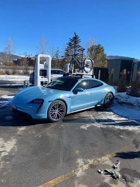

This was how I left this morning.

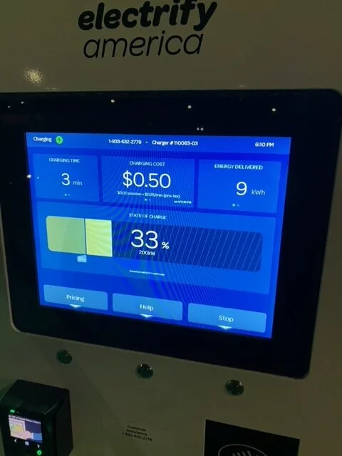

This was my first charge stop in Frisco, Colorado.

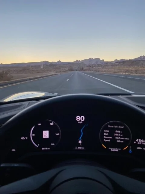

A couple of scenic shots from my drive today.

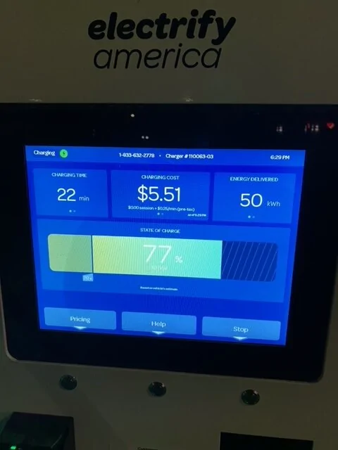

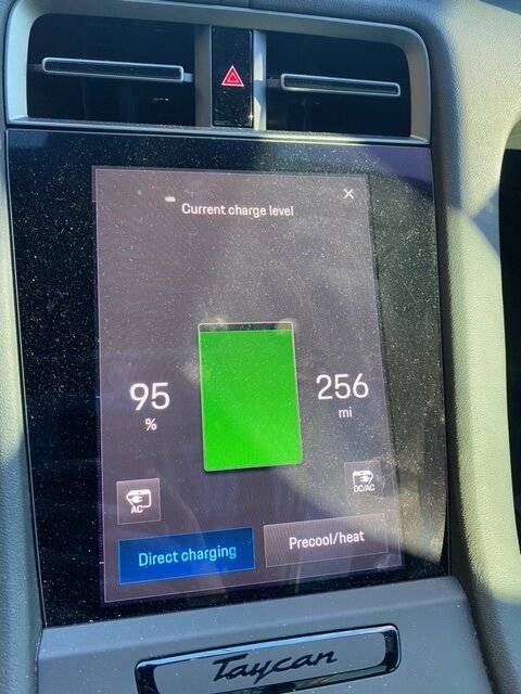

I surprised was the charging speed I was able to achieve when it 30 degrees. Vehicle hit 200kw when I pulled in with 25% battery.
I was able to add 50kw in a little more that 20 minutes in 30 degree temps. Not bad at all.

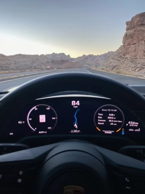

Final stats for my drive today. 47kwh per 100 miles is about 13 kWh more than what I did on this drive in early October with no bike, and 35 to 40 degrees warmer temps.
I am by no means a professional when it comes to understanding efficiency, or breaking down efficiency metrics, but the car handled very well today concerning the altered aerodynamic profile, and the colder tempetkres. As with any EV, these are the two greats impacts on range, so if you are going to make long distance drives in the winter make sure you charge a little more than what the vehicle suggests.

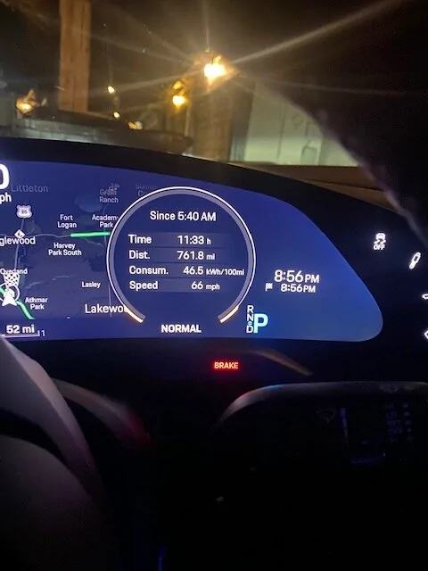

Just to wrap up this conversation, I drove from Vegas to Denver yesterday in one shot - 760 miles, or just a little over 1,200 kilometers. It was a very long day in a sporty EV. Since I had the rack and the bike on top of the car, which altered the aerodynamics of the car, and I was doing decent speeds when I could, I had to stop at 7 different chargers to recharge. Temps ranged from 45F to 10F and there was a lot of elevation gained - multiple mountain ranges in Utah and multiple very large mountain ranges in Colorado at night when it was 10 degrees Fahrenheit.
Just for reference, I have a 4s with 20" inch Pirelli winters tires on the vehicle, I did not turn on the heat, and relied on the seat wormer and the steering wheel warmer. The car was pretty comfortable most of the time except when I was going over the high mountains in Colorado and it was 10 degree Fahrenheit.
I have 10,000 miles on my Taycan now since the beginning of May and have driven in all kinds of weather, all kinds of elevation changes, and now with a very large electric mountain bike on the roof. The car is all Porsche in regards to design, and driving capabilities, but it is still an EV, so, it suffers a near 20% efficiency hit as aerodynamics are altered and the weather drops.

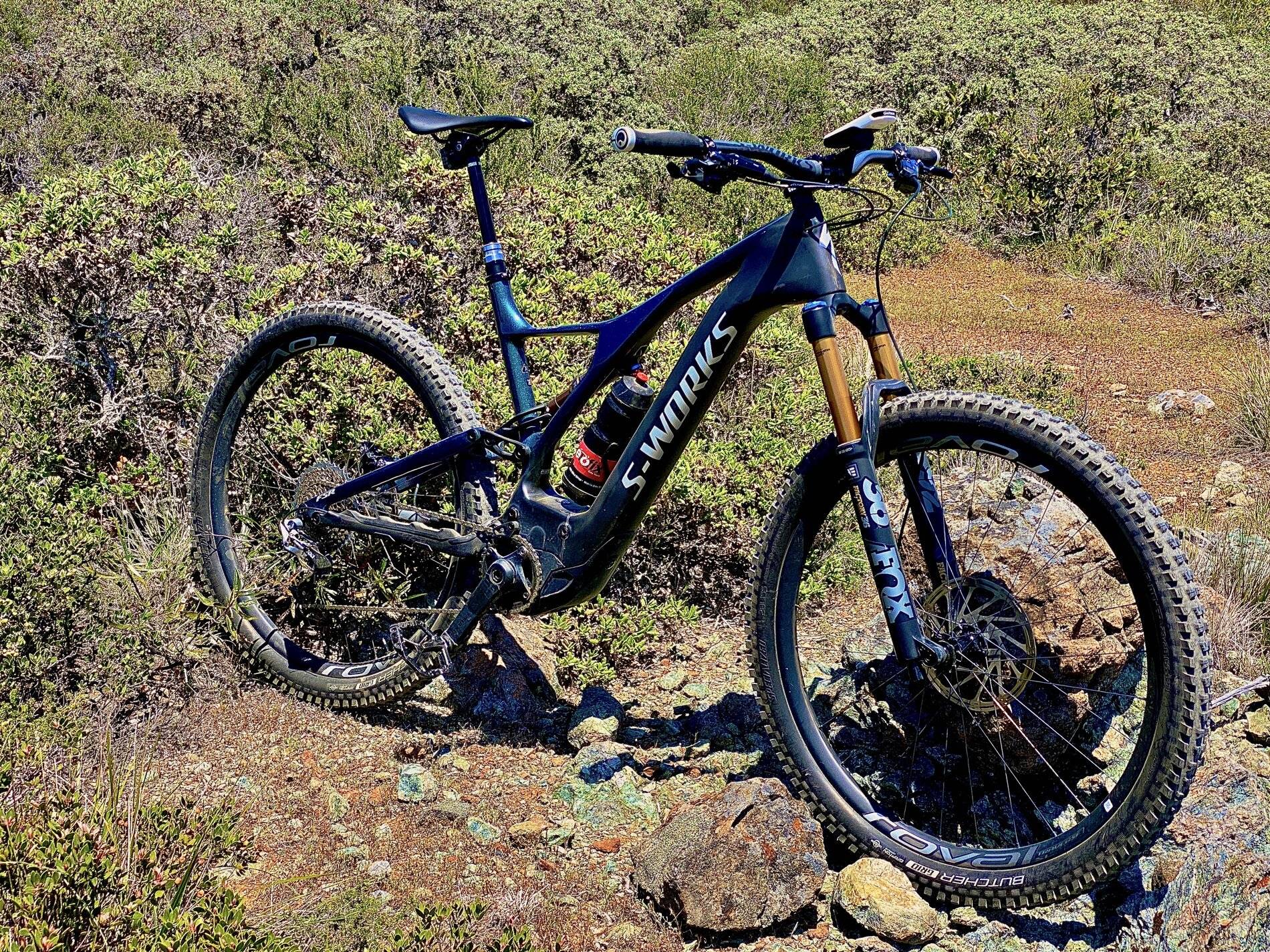

It’s a little hard to tell, but is that a Specialized Turbo Levo on your Taycan? If so we’re nearly twins! I’ve ordered a 2021 4S for March delivery and am looking forward to throwing my Levo on the rack (along with my Tarmac) and hitting the road. One question though: what kind of real world range are you experiencing with your Taycan and what’s been the reliability of the Electrify America network in your experience?
