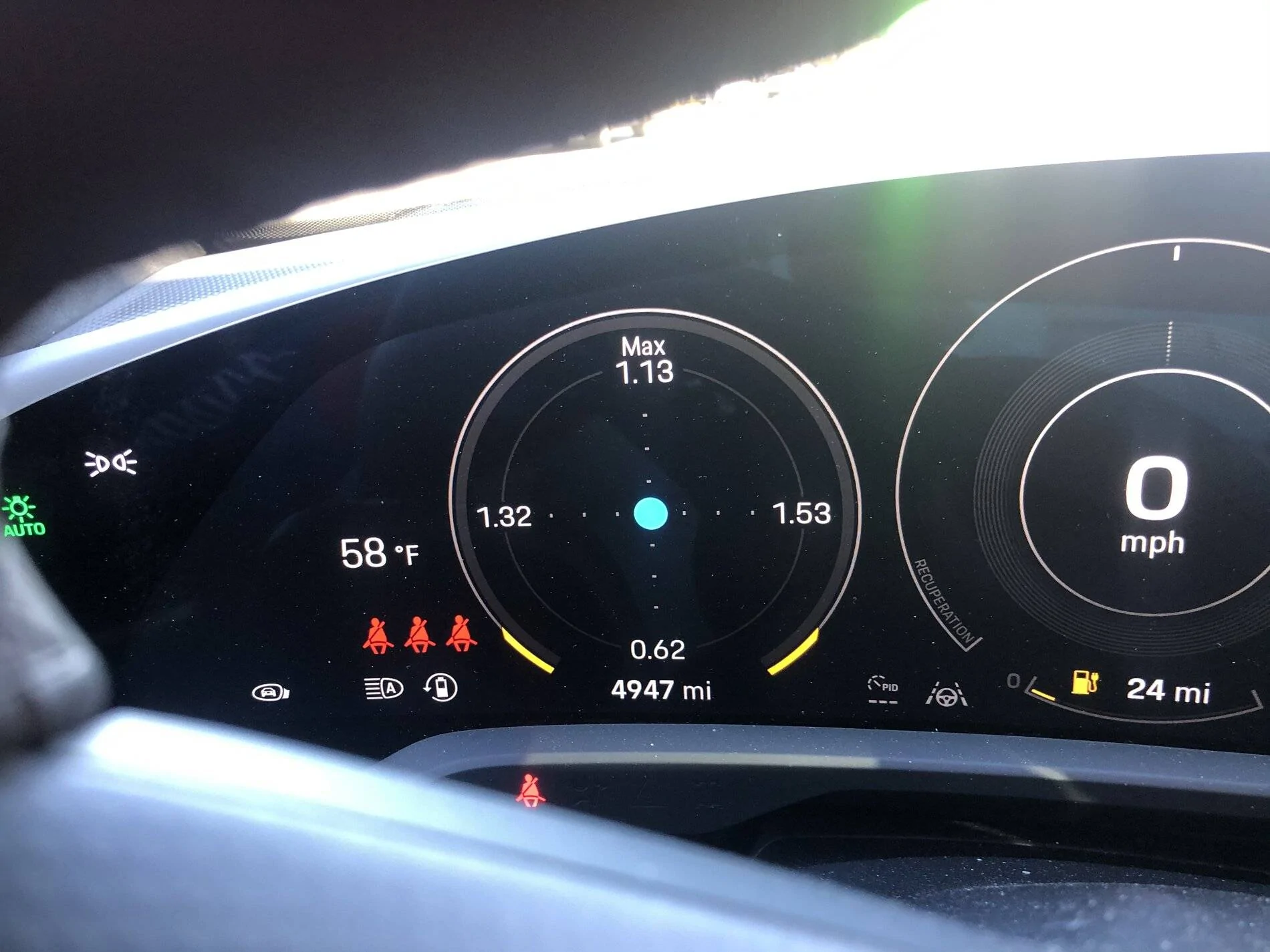

ah thanks.
It's just my feeling when compared with impressions on other cars. if you look at Taycan's numbers posted here by others you see they are pretty good. So we should not worry...
