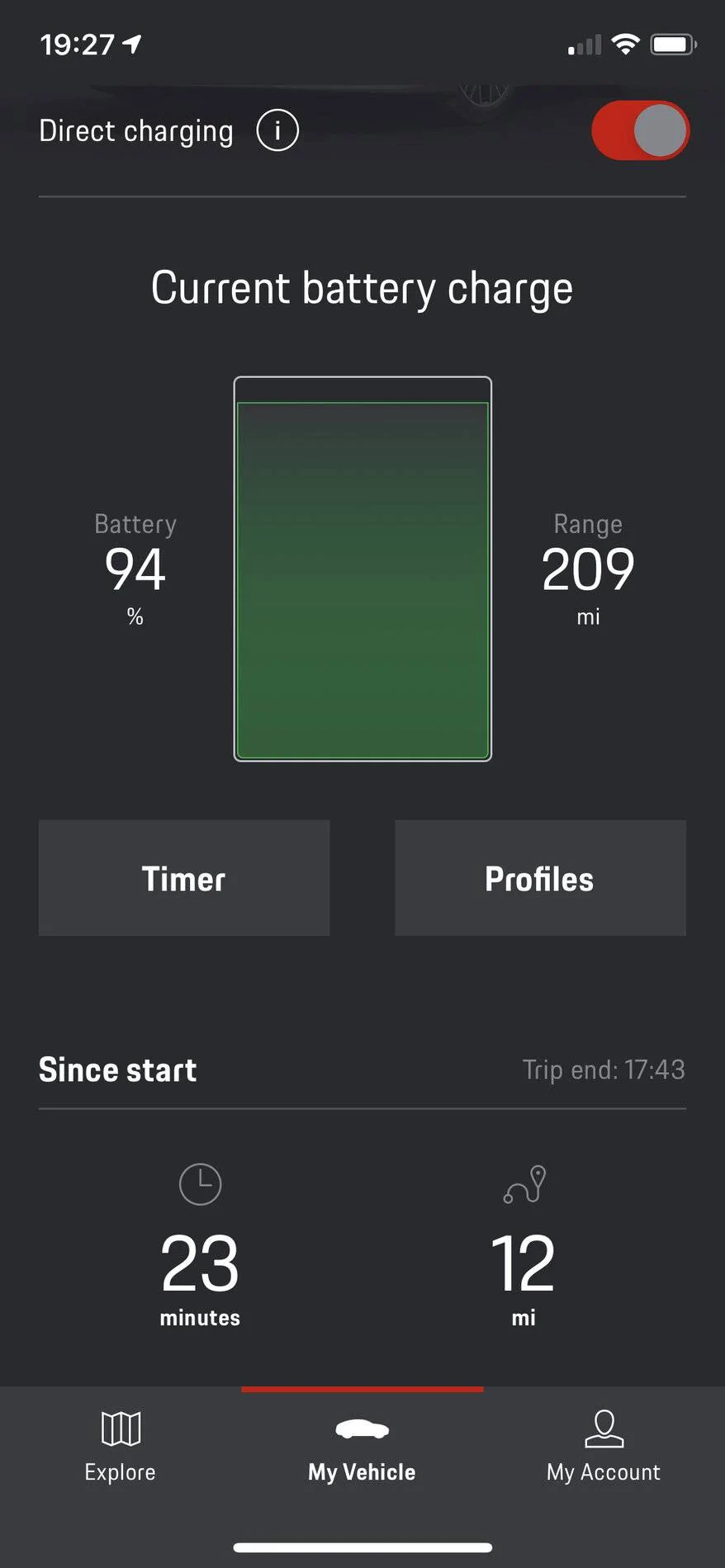

I’ve not seen more than 230 miles on a 100% charge (on the screen). Why could that be? I thought the range for the 93kW was 242-270 ish.

The range in miles is just an estimate. Or more accurately, a guess. It will adapt after you've driven for a bit but it's never entirely accurate.
Track using the trip computer (looking at the kWh/100 metric) and battery %. The 93 kWh battery has about 87 kWh available, so as an example a 33 kWh/100 mi number = about 260 miles of range.
You should almost always be safe figuring 1% = 2.5 miles.

As mentioned, it is simply projecting your range based on your recent activity. And even then, the range you will get on this particular charge may end up being longer/shorter than 209, depending on how you drive and other conditions (weather, uphill/downhill, etc).
Coincidentally, my most recent charge was to 94% as well, and it showed me a 237 mi range expectation.

I agree with frank. I just multiple the percent left by 2.5 miles.

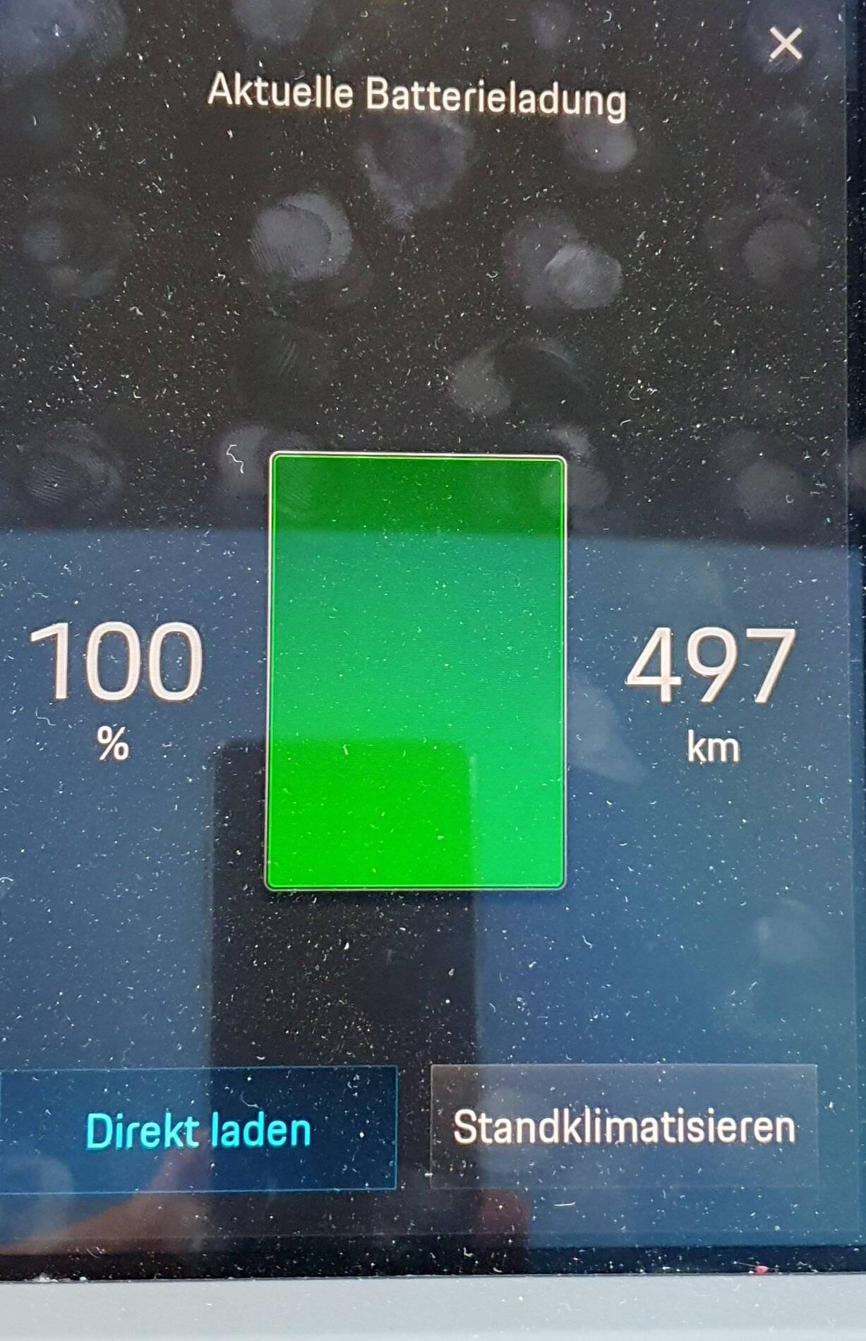

It is possible to reach very long ranges when driving conservatively, see attached picture of my T4S (497 km are 309 miles).
It really depends on driving style, temperature, are the brakes "driven in" (the car apparently does some on-purpose braking instead of recuperating according to a pre-programmed method when new).
I wouldn't worry and just drive on...

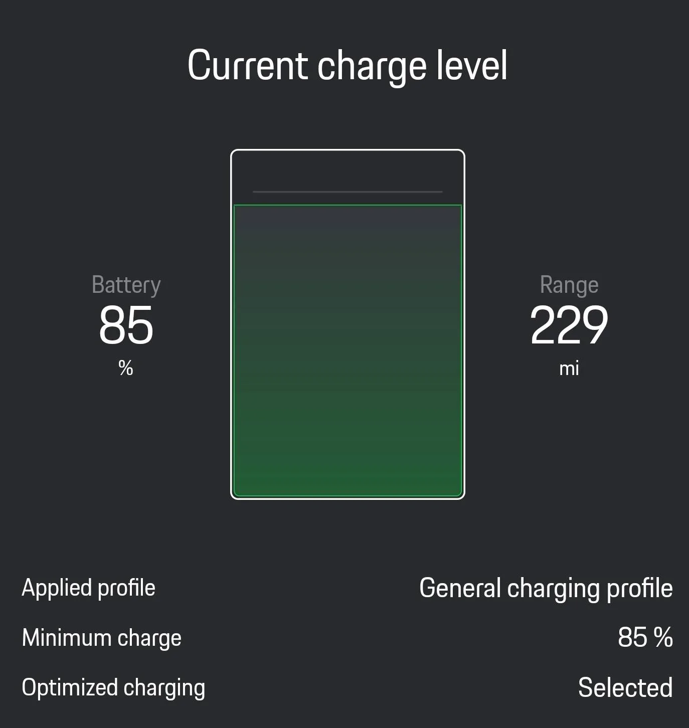

Right now mine is showing 229 miles at my profile-limited 85% charge. Extrapolating, that's a shade over 269 miles at 100%. I have about 2,200 miles on my car now, although i do not know how far back the guessometer considers.
