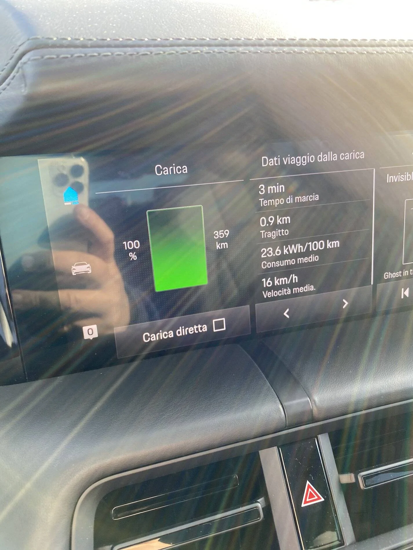

Normal driving not so sport, this is my range at 100%
Porsche Taycan 4S Range is never more than 170 miles on a full charge. C15C1169-EA4C-4C4C-A44E-EC1DB6E84E6B
