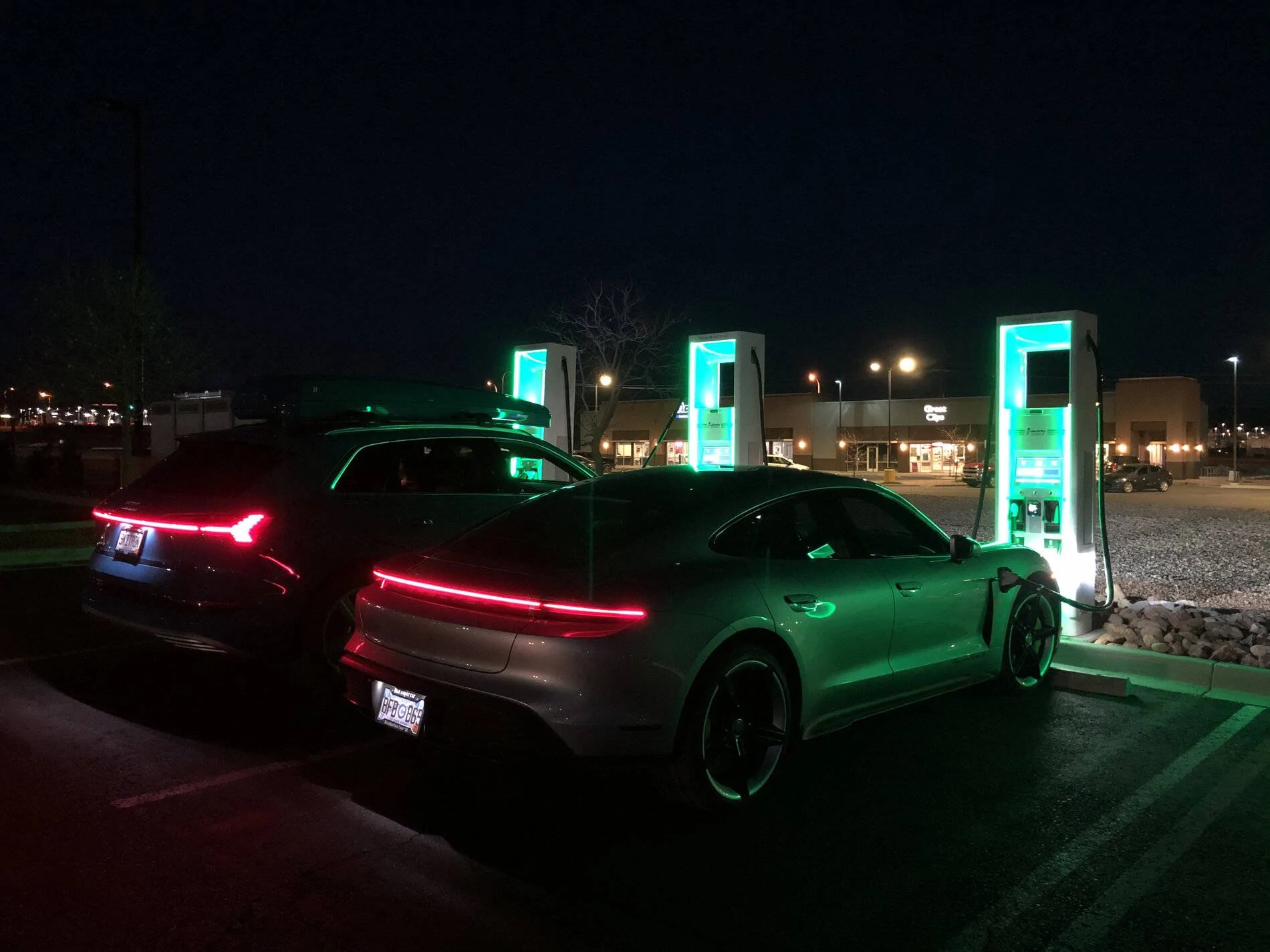

Charing in Santa Fe
Porsche Taycan 880 mile Taycan and E-tron (SUV) road trip - E-tron charges faster IMG_3575
