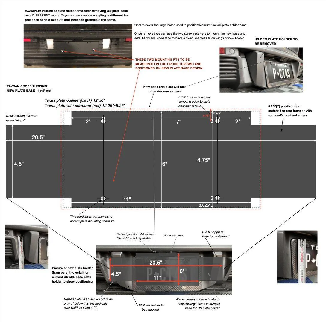

Ongoing re custom plate holder i.e. yet to see what they offer in respect design but may still just go with my own design in that regard - that one pending.
Curious if you had a look at your bumper with the monkey butt bracket removed? I took mine off to have a look and the gaping holes didn’t look too promising to hide. At least not with an ‘OE’ look.
Yes I've seen multiple pics of the holes on sedan and wagon.
Should not be that hard at all imo - in fact I have already ordered the plastic for a first pass and will be a combination of auto-double-sided tape and screws to both fix in place and provide mounting for plate - here is a snapshot of a first pass design I threw together (by NO means final) that gives a feel - the plastic I am experimenting with is Auto grade if you will and testing 1/8 vs 1/4" - I may stick with 1/8 on the 'exposed side 'wings' (they cover the holes) and in the area behind the plate double up the 1/8 to allow better seating of plate mounts etc. Can't really start until I get my car back and again I am also working with the custom shop who have yet to propose their solution (high end business so my expectations equally high:)!).
Porsche Taycan A 2022 Cross Turismo 4S: From Order to Delivery to Mods Screen Shot 2022-01-22 at 3.34.41 PM

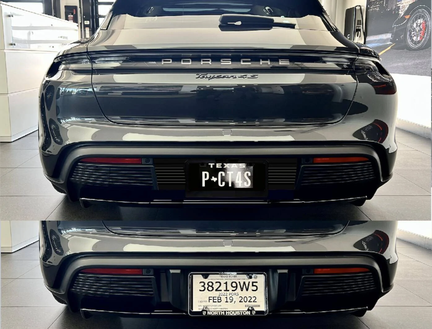

This from my SA Jake taken before I got there :) - EDIT: WRONG!
I just now realized, pretty funny, but sneaky bugger set this pic up on way back from service where they installed the clear side markers on pick-up day whilst I was paying for the thing - good one Jake :)
Hey I meant to ask (to save time fostering around) as I have yet to remove the Monkey Butt, but how is it attached on top? My car again not to hand as in shop but bef I dropped it off, I did pull back on the holder and could see how the 'blocks' click into the large holes to stabilize it but at that time did not immediately see how the top (under the reverse camera) was fixed to the bumper - clipped, screwed, riveted?
Appreciated in advance!
Cheers, C.

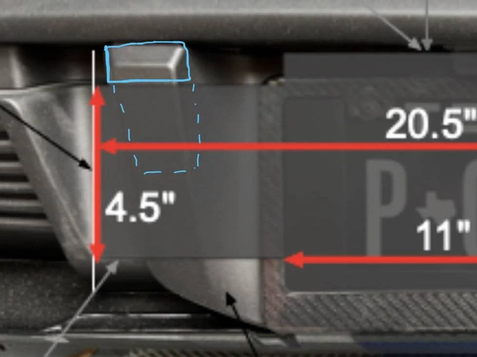

There’s a shallow rectangular dowel on each side that slots in to the surface that the camera is mounted on.
I saw your proposal and one area that you’ll need to consider is the holes extend all the way to the top. Your plate will have to be flush along the top to fully cover them.
Porsche Taycan A 2022 Cross Turismo 4S: From Order to Delivery to Mods 8AC02475-7966-4F47-9F3C-23916CA7308A
Well spotted thx - like I say a quick and dirty sketch-up that needs fixing :), but will get there.

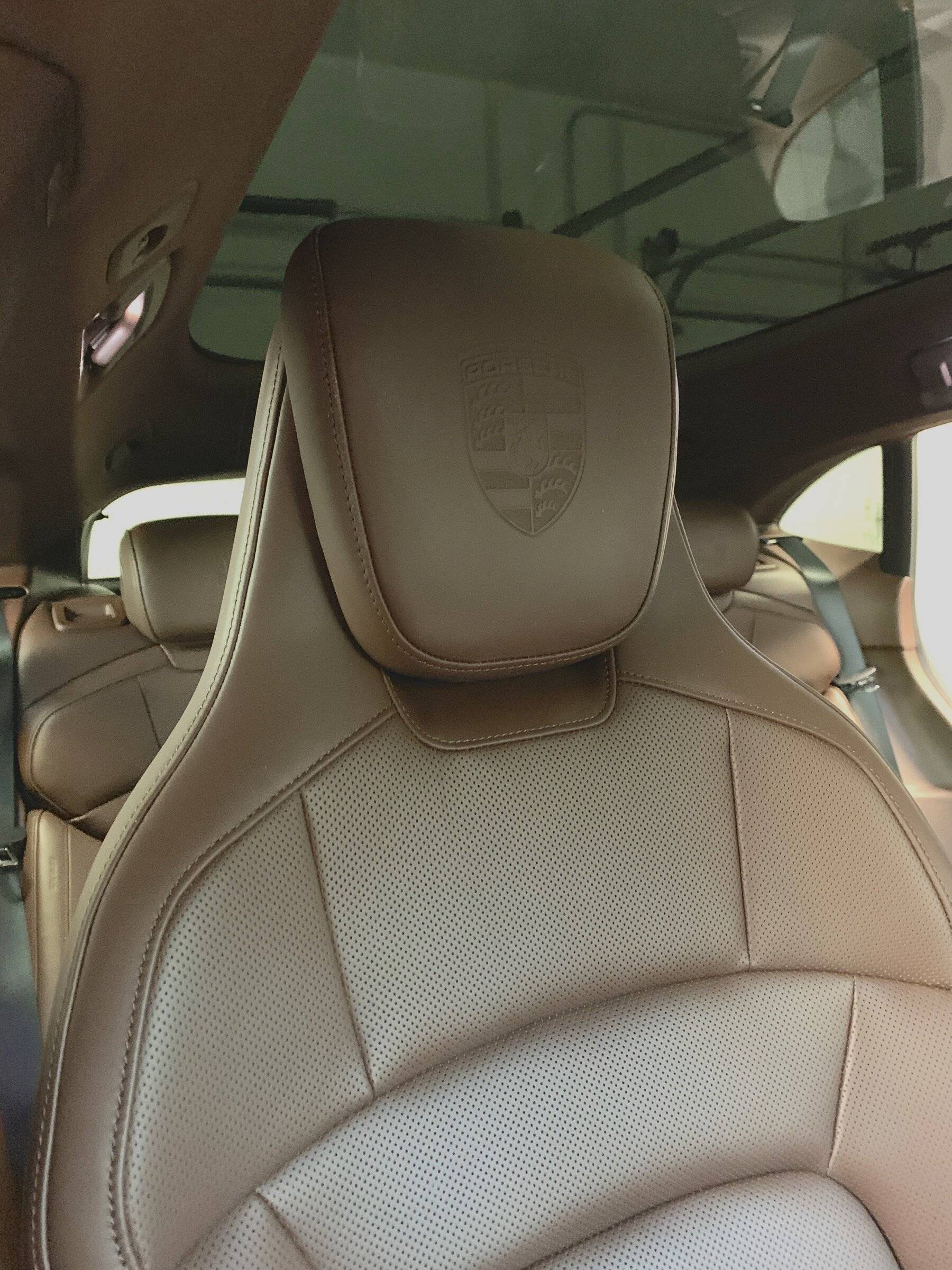

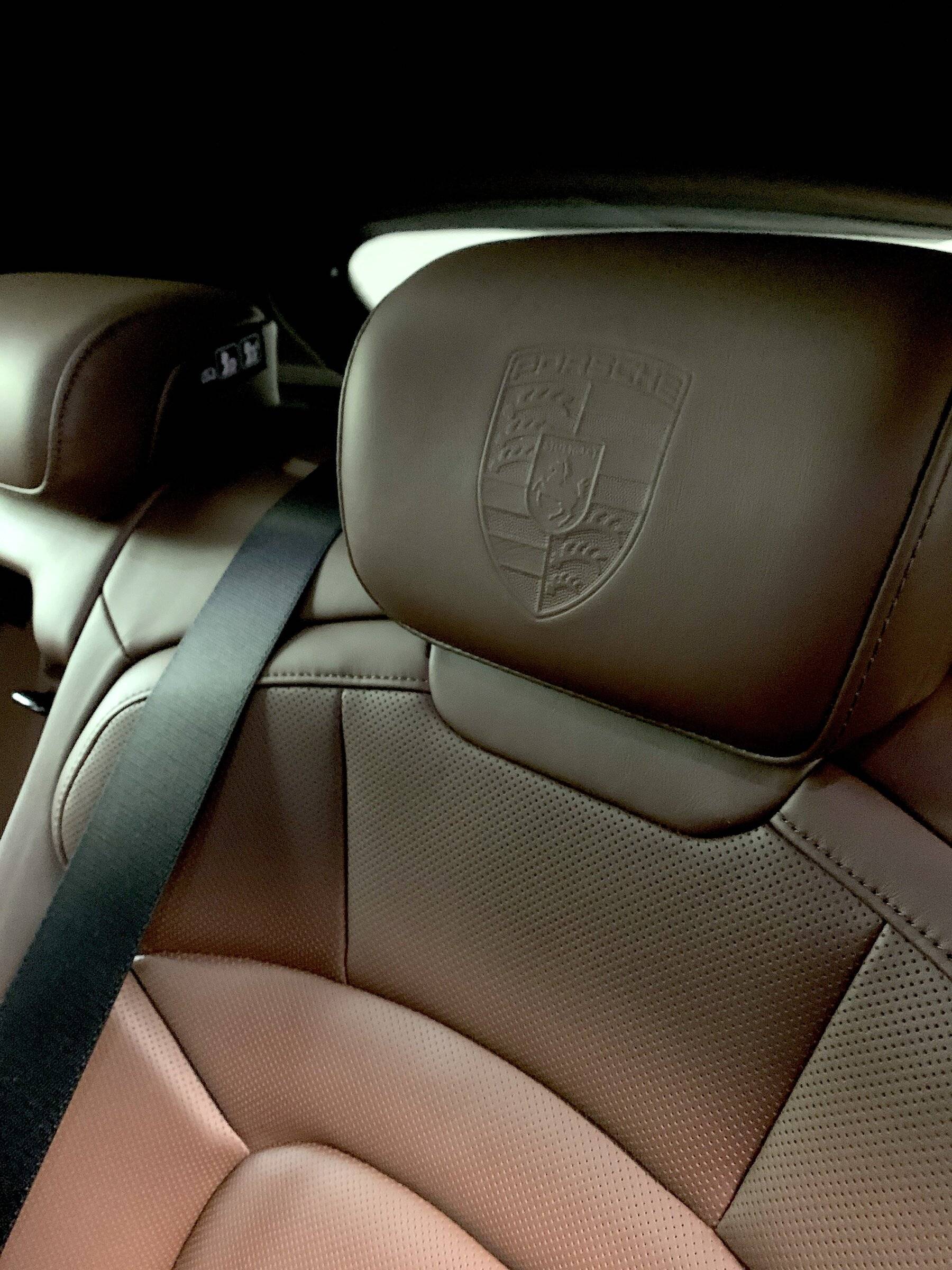

Thanks! I have both optioned in for my build so am curious. I would prefer something subtle, but its a little hard to see the impact of the crests from this angle. I have truffle brown leather though so not sure how it would show up on the darker colors.
I also have truffle brown leather. Here are a couple of shots with the crests.
Porsche Taycan A 2022 Cross Turismo 4S: From Order to Delivery to Mods IMG_1100.JPG
Porsche Taycan A 2022 Cross Turismo 4S: From Order to Delivery to Mods IMG_1101.JPG

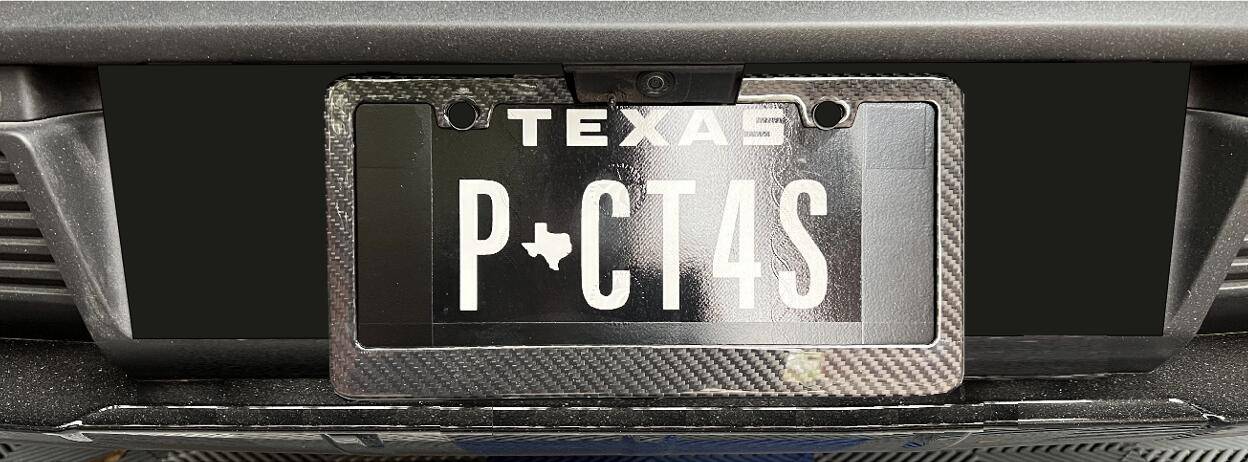

So here is a VERY rough rendering of a possible solution (thx again to bsclywilly for the observation of how high the cutouts go which is indeed evident in the sedan pic I used before!) - this I think could still look way better than the OEM solution - I tapered the cuts on both sides to follow the bumper's lines there - again all rough and ready until I get my car back and can experiment - the color prob won't be quite as dark as show here:
Porsche Taycan A 2022 Cross Turismo 4S: From Order to Delivery to Mods Screen Shot 2022-01-23 at 10.30.06 AM

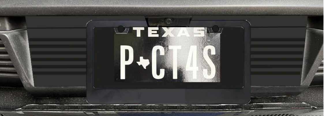

bsclywilly One more for you :)
If we get a bit more creative one could mill out groves in a thicker piece to mimic the styling of the adjacent bumper sections - I'm just showing simple stripes here but could go all in on a 3D effect - with the right gear (routers etc) it could be straightforward enough ....
Sort of look I was thinking of - again this is a fast 2D concept (ignore some of the crappy looking imagery!) - ridging would stop either side of plate recess .... I'm obviously bored right now :)!
I guess to avoid odd edge issues I could make the groves of much lower relief so mimicking style but a more subtle 3D expression.
Porsche Taycan A 2022 Cross Turismo 4S: From Order to Delivery to Mods Screen Shot 2022-01-23 at 4.30.10 PM
