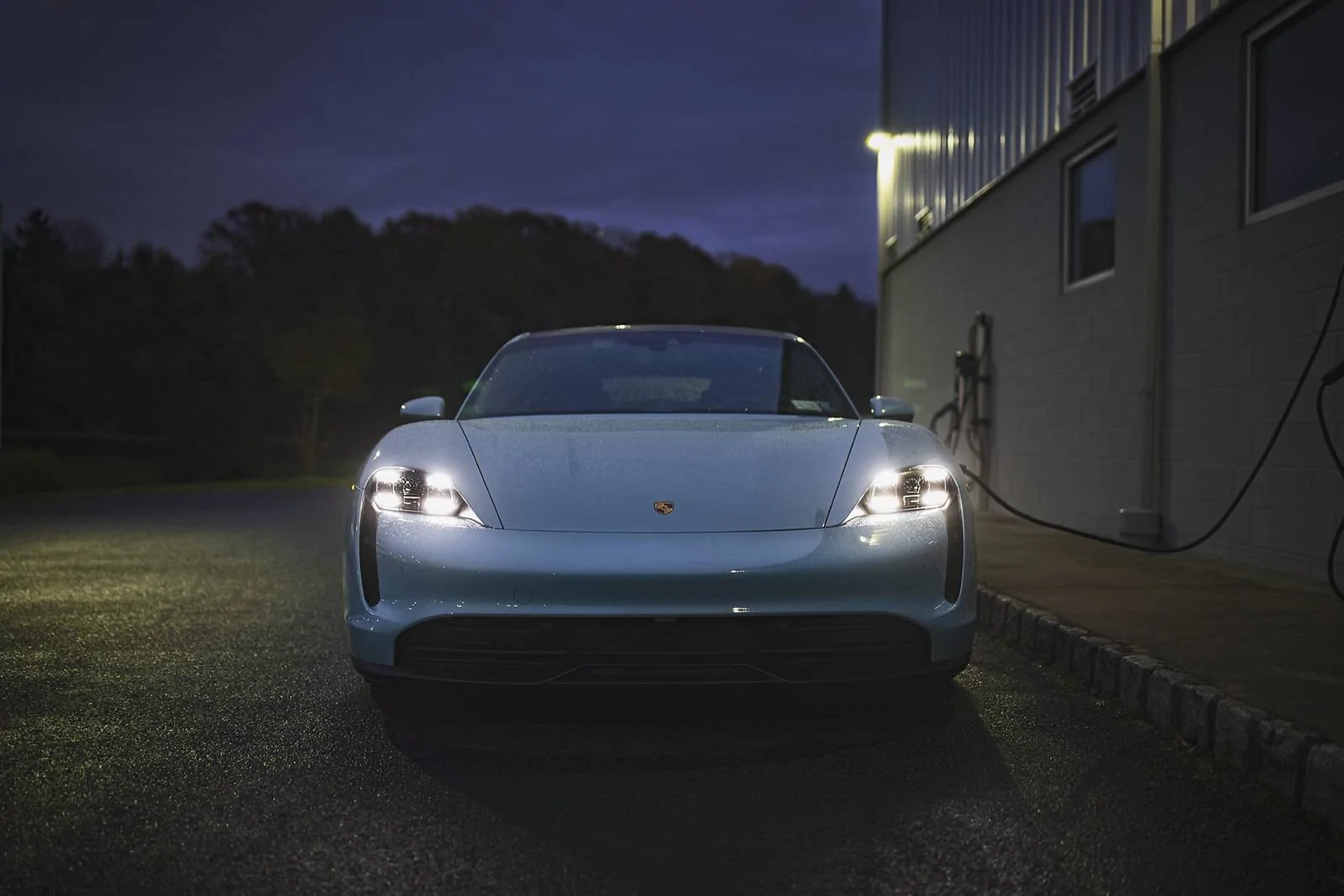

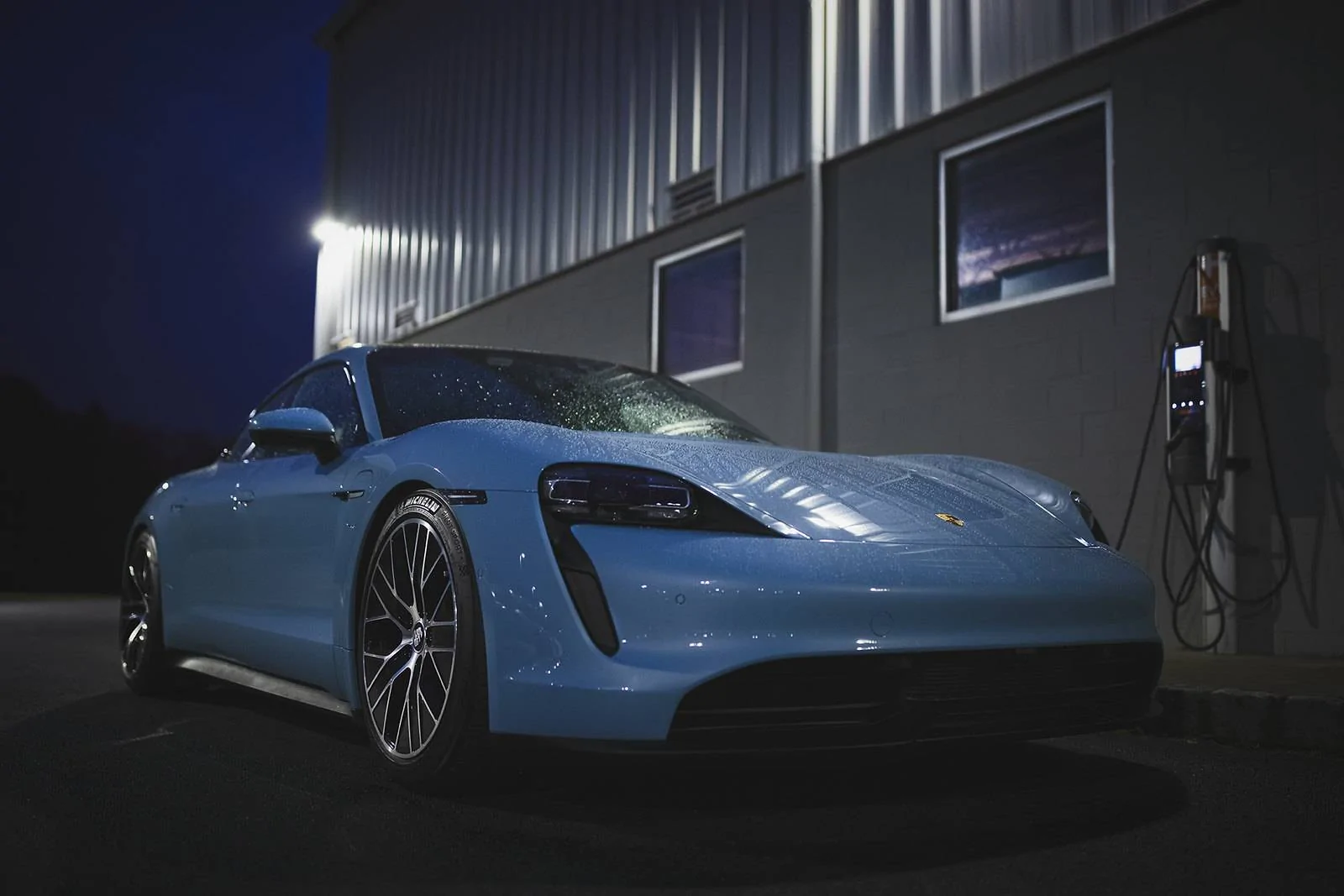

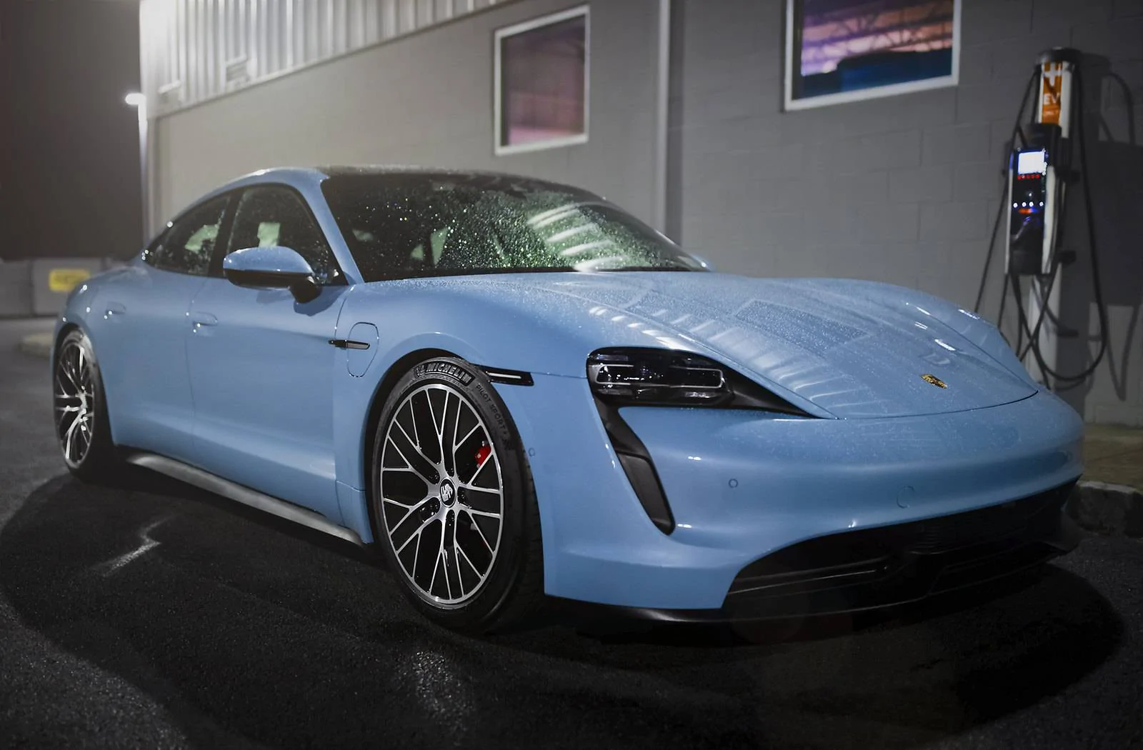

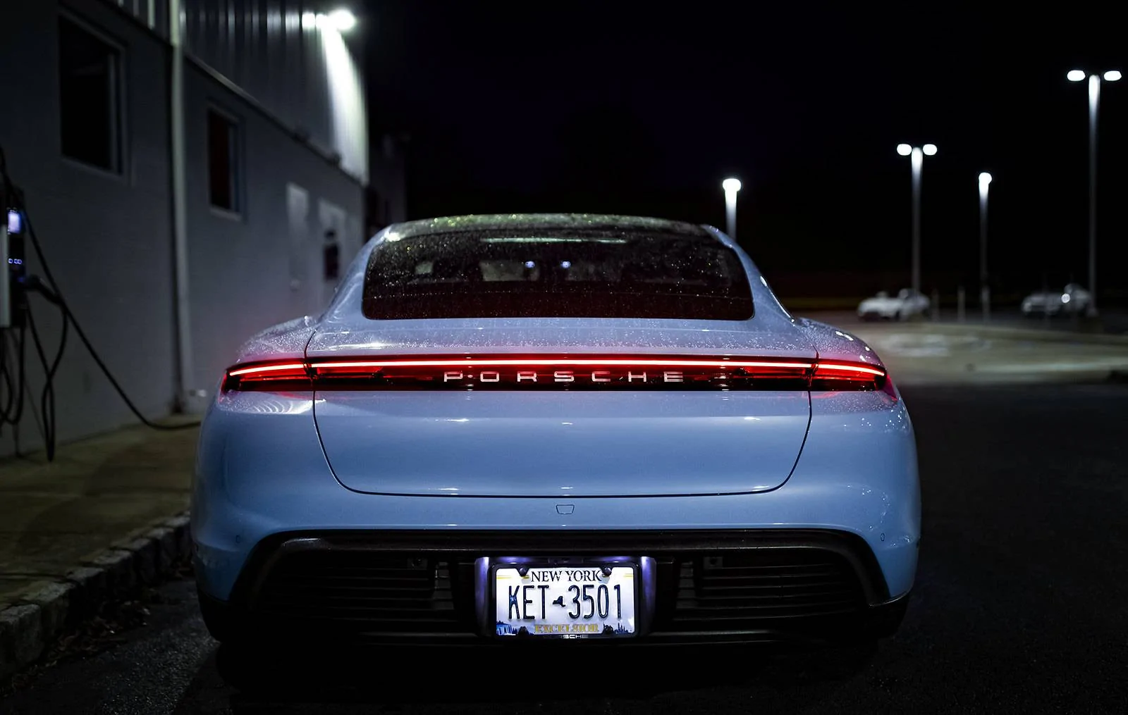

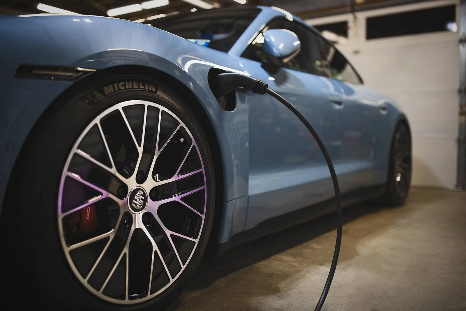

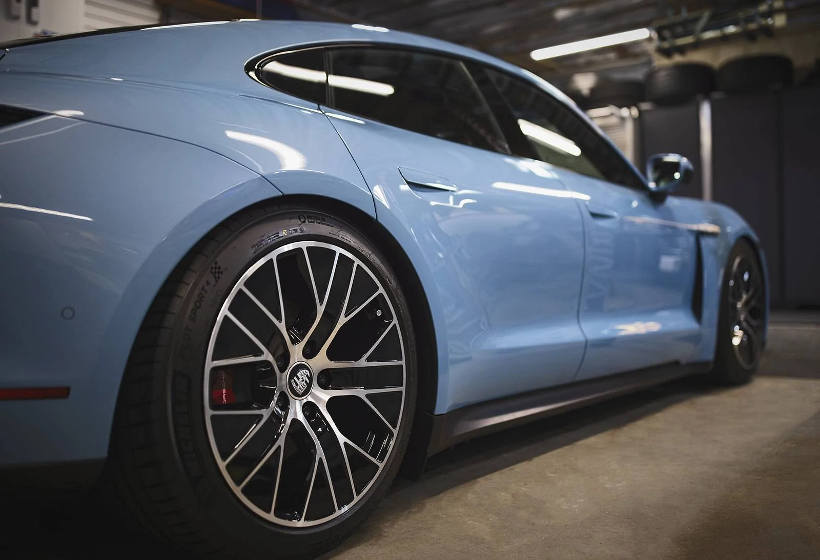

Got my lowering links from FVD Brombacher yesterday as well as some Rennline 15mm spacers all around. The car is only 15mm lower on all settings, but it made a dramatic difference. I'd take it out for some proper photos, but it's pouring out here :(

Looks great. cant wait to see it on the street.
what camera did you use? Those pictures are so clear haha

This was shot on a Canon R5 w/ a 35mm 1.4L :)

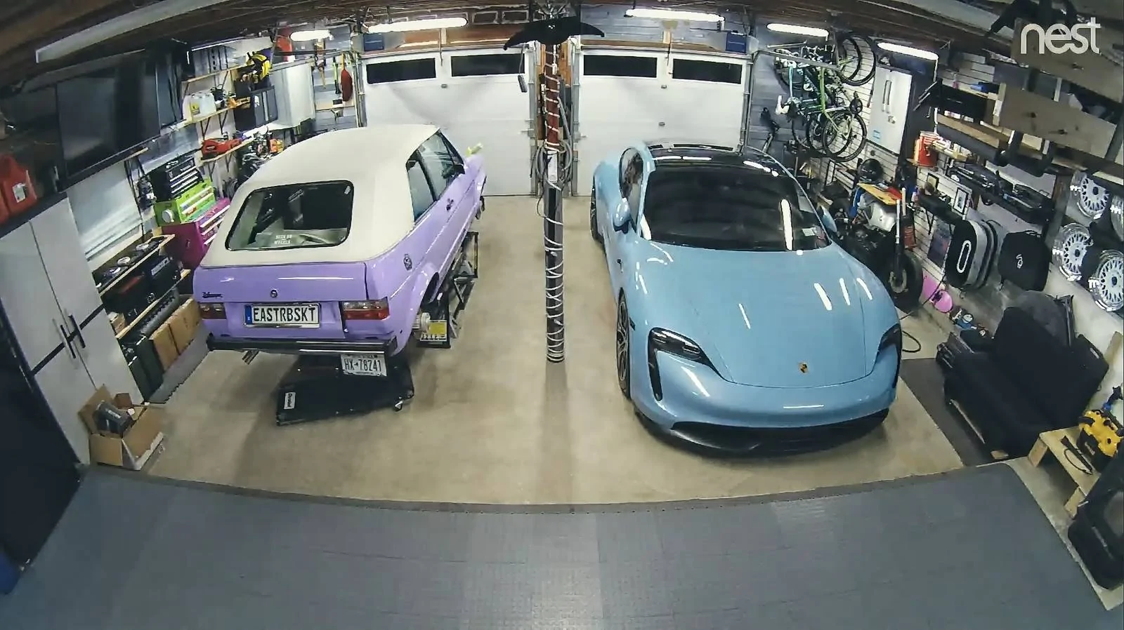

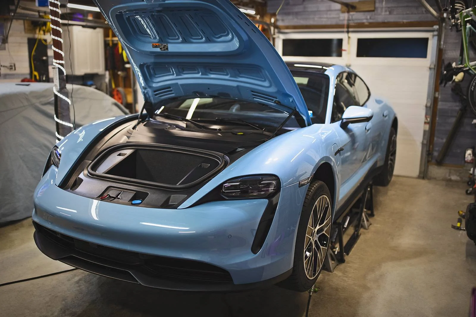

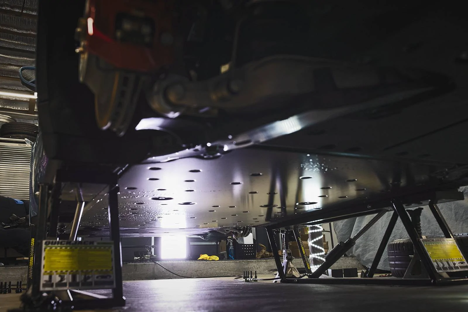

Raec, Which model of quick jack are you using ?

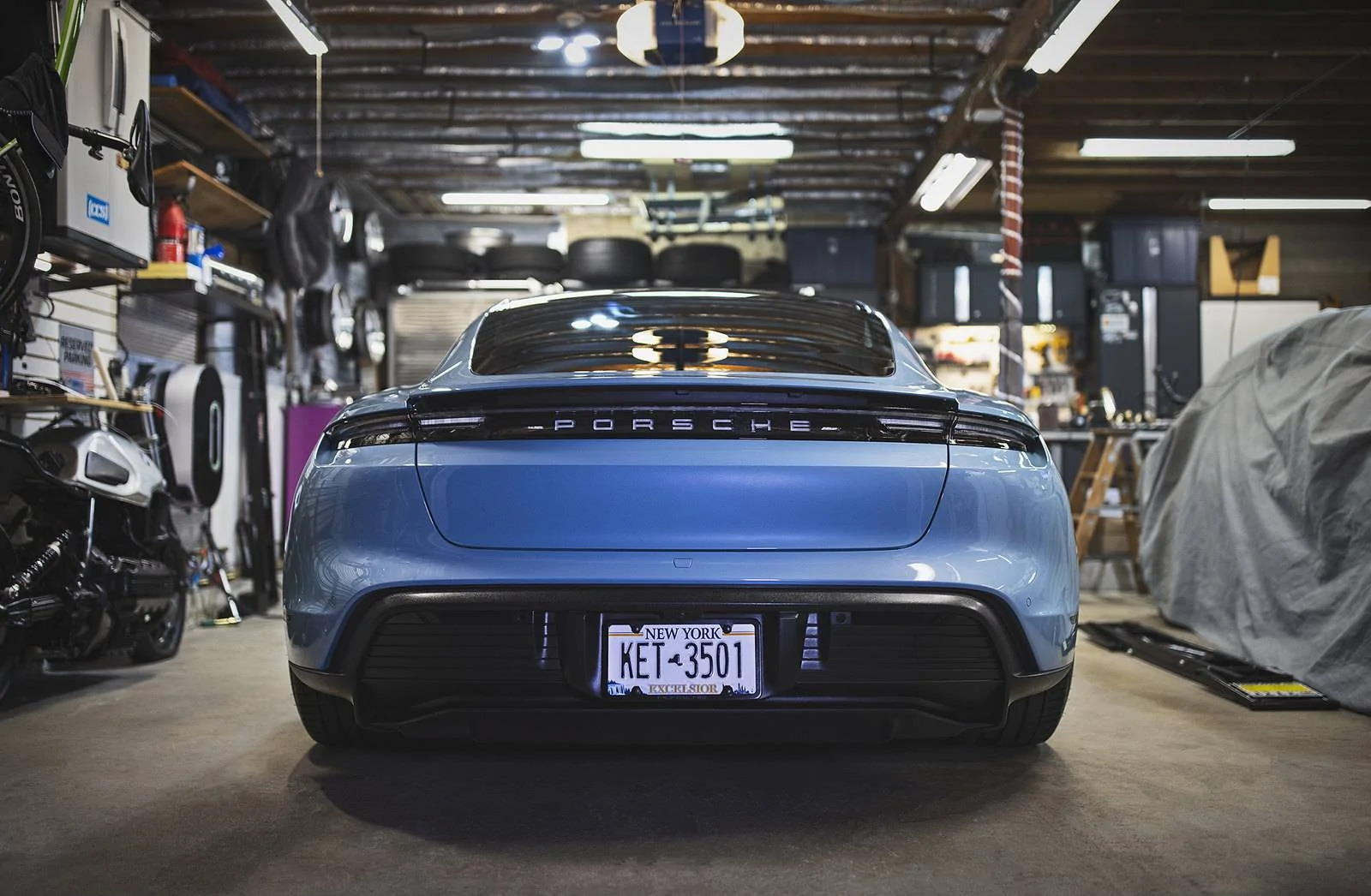

It's been driving wonderfully. Drove through NYC (from Long Island to New Jersey), and if you know anything about the Cross Bronx Expressway...then you know.
Drove it on both normal and 'lowered' settings, which are obviously 15mm lower than factory and it was awesome. When the roads opened up, I naturally switched to sport plus and it was wonderful.
I just can't wait to get some proper wheels, as I'm not the biggest fan of spacers...however, the Rennline spacers that I installed were absolutely without any vibration.
Here's a few more photos, just because:

+1 I've got the bl5000ext - seems like it would be right on the weight limit lifting a Taycan.
Thanks, I’ve been looking at a couple of models. Which of the Taycan do you have, 4s, turbo or turbo S? I have the turbo with 93kwh battery. I looking for using it also with 2017 Range Rover HSE 6td L405 or Vogue as you folks classify it.
putty_thing
Aug 13, 2020
Southampton, UK
BMW F10 M5
I don't have any Taycan yet (Turbo soon!), would be interested to see if Raek has the larger bl7000 or if the bl5000 will lift it OK. I imagine the lift is fairly underrated so it's OK to lift something right on the load limit.
Sorry about the late reply!
It's the 5000 lb capacity version. I've had no issues getting the Taycan or my Macan up on it. Granted, I always reinforce with jack stands...even when my wife's MK1 VW is on it.
