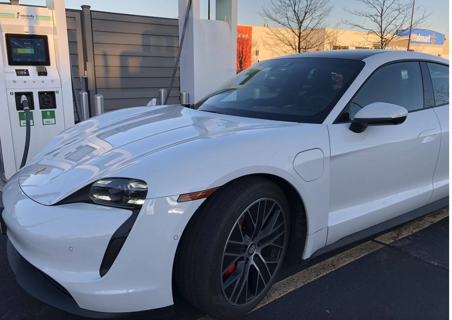

The EA chargers worked much better for us this time. On the trip from Boston to Durham, we never got a charge rate over 150kw. On the return leg, we had 3 of the 4 charges over 150kw. There were two notable differences – (1) about 30 min prior to arriving at the target EA charger, we stopped the navigation and selected the target EA charger through the “Porsche Charging Service” POI section of the nav and (2) we arrived at the chargers below 20% charge.
These were both suggestions posted by @wemct (https://www.taycanforum.com/forum/t...aycan-tips-suggestions.4072/page-2#post-56030)

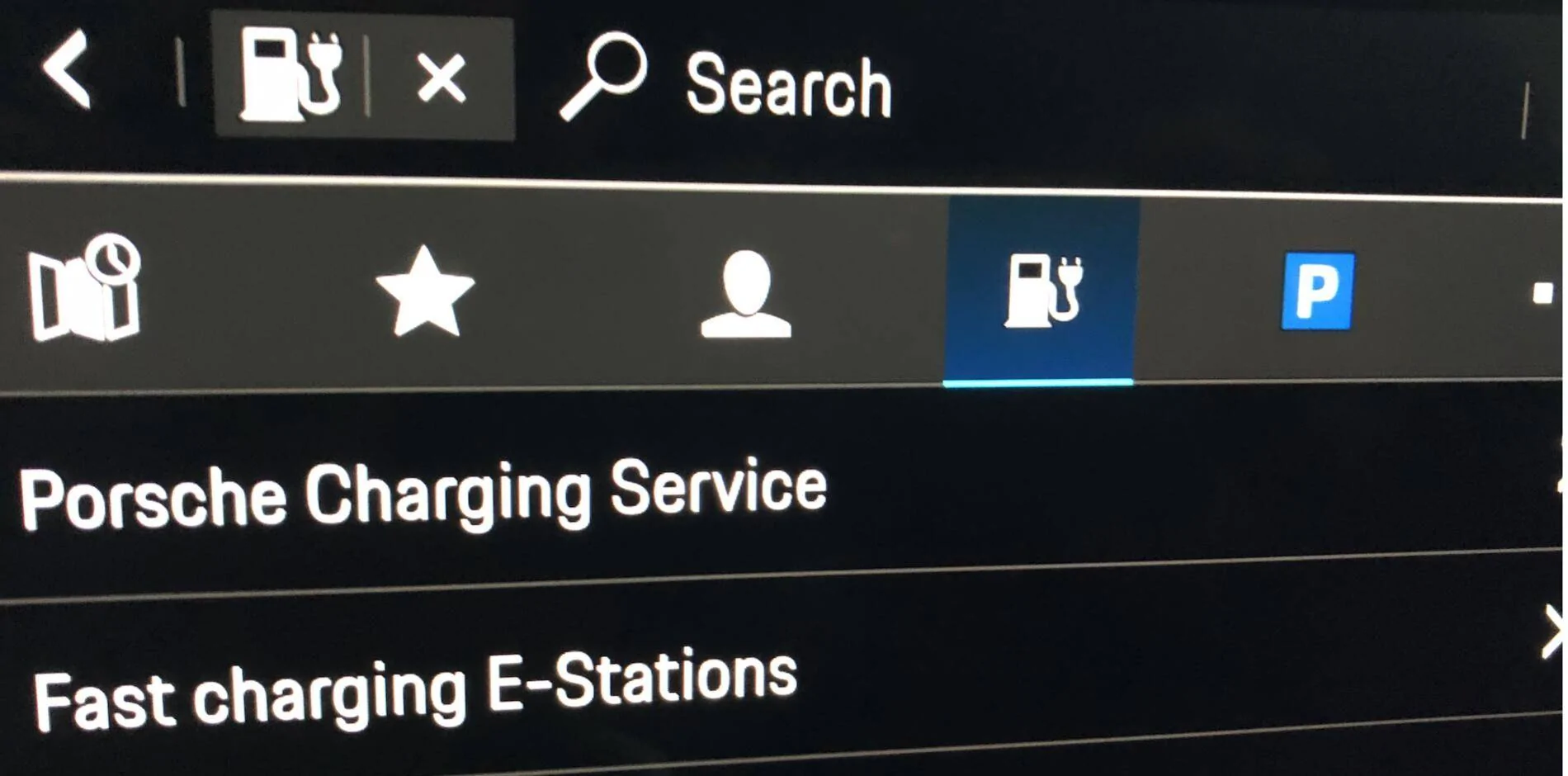

and really make a big difference. By selecting the target charger through the Porsche Charging Service nav menu, Taycan preconditions the battery. In range mode I noticed the battery temp increase after selecting the charger. This really stood out in our first leg of the trip between Durham and Richmond when the battery was still cold. The battery was 61F after driving about 2 hours in range mode. During that 30 min after we put the target EA charger into the nav, the battery temp increased from 61F to 83F and then the charger started out at a whopping 247kw and the total charge there from 9% to 83% only took 22 min .
On the negative side for EA, we had two chargers where the charge rate started out really low and we had to move. At the Walmart EA in Abingdon, MD, the first 350 started at only 65kw. We moved to the second 350 and it ran at 189kw before tapering. At the Walmart EA in East Brunswick the 350 charger started at 59kw. We moved to a 150 and that worked at 120kw. I spoke with EA support and they said the car was handshaking at 75kw for those so maybe there’s a hardware issue or the software for the handshake isn’t robust enough yet. Looking forward to this continuing to get better.
One thing I noticed in the 10 EA stops we made in the past week is that the 150 chargers always got a charge rate close to 150kw, while the 350’s sometimes got a very low rate (like below 75kw). I think that my charging algorithm now will be that if I arrive at an EA location with above 20% SOC, I’ll just go straight to a 150 since even the 350’s are going to charge close to a 150kw rate anyway with that SOC and the 150kw stations seem to be more reliable in their handshake. If I arrive below 20% SOC, I’ll try the 350’s since there is enough upside to make it worth trying them. I’m looking forward to seeing how the MY20 software updates helps with this.

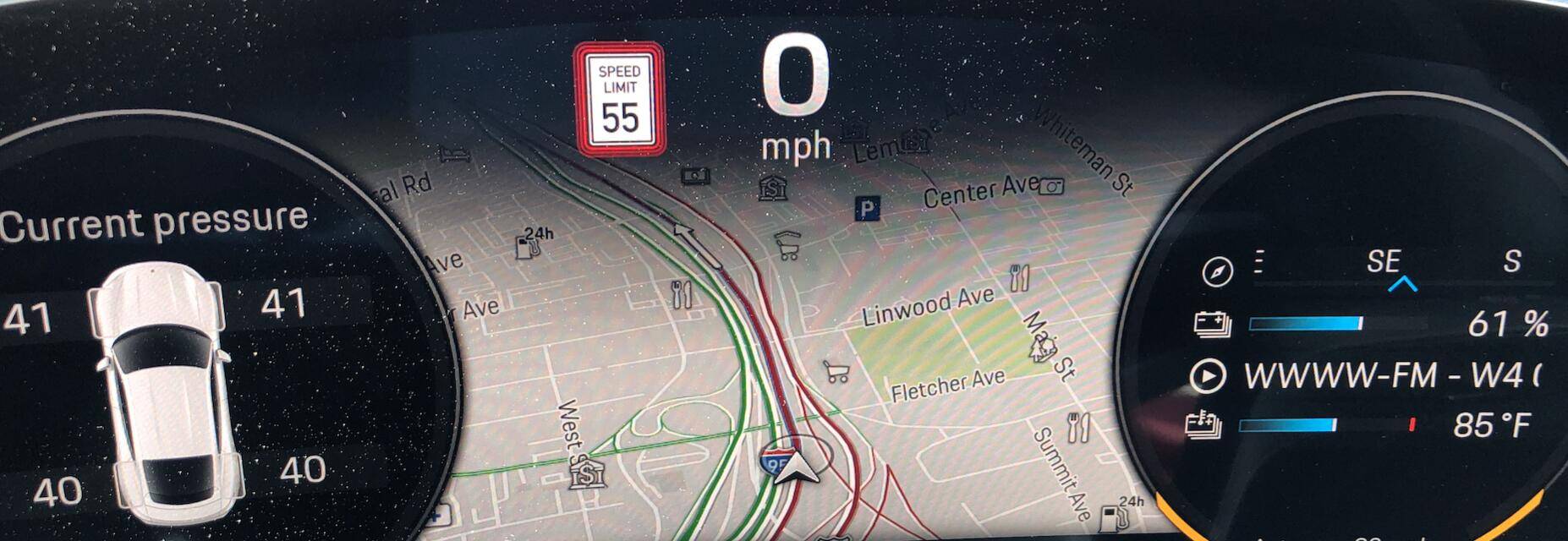

- Speaking of quirks…the speed limit sign got stuck on the display. At some point it displayed 55mph and just didn’t change the rest of the trip. It was actually worse than that because we had it set to warn when we are over the speed limit so the 55mph sign had the red outline indicating that we are over the limit. I’m sure we could have rebooted the PCM to clear it but we lived it for the trip. My wife liked to point out that I broke the speed limit warning haha.

Since we didn’t have a place to plug in at our destination, we started at 6am from Durham at 85% SOC, but with a cold battery of 55F.
LocationArrival SOCArrival Battery TempDeparture SOCDepart Battery TempCharging Rate / Time
Walmart EA
Richmond, VA
350kw charger
9%83F83%108F247kw / 22min
Walmart EA
Abingdon, MD
350kw charger
21%88F91%100F189kw / 37min
(including move to 2nd charger)
Walmart EA
East Brunswick, NJ
150kw charger
36%85F74%100F120kw / 35min
Walmart EA
Manchester, CT
350kw charger
15%89F75%112F247kw / 18min
