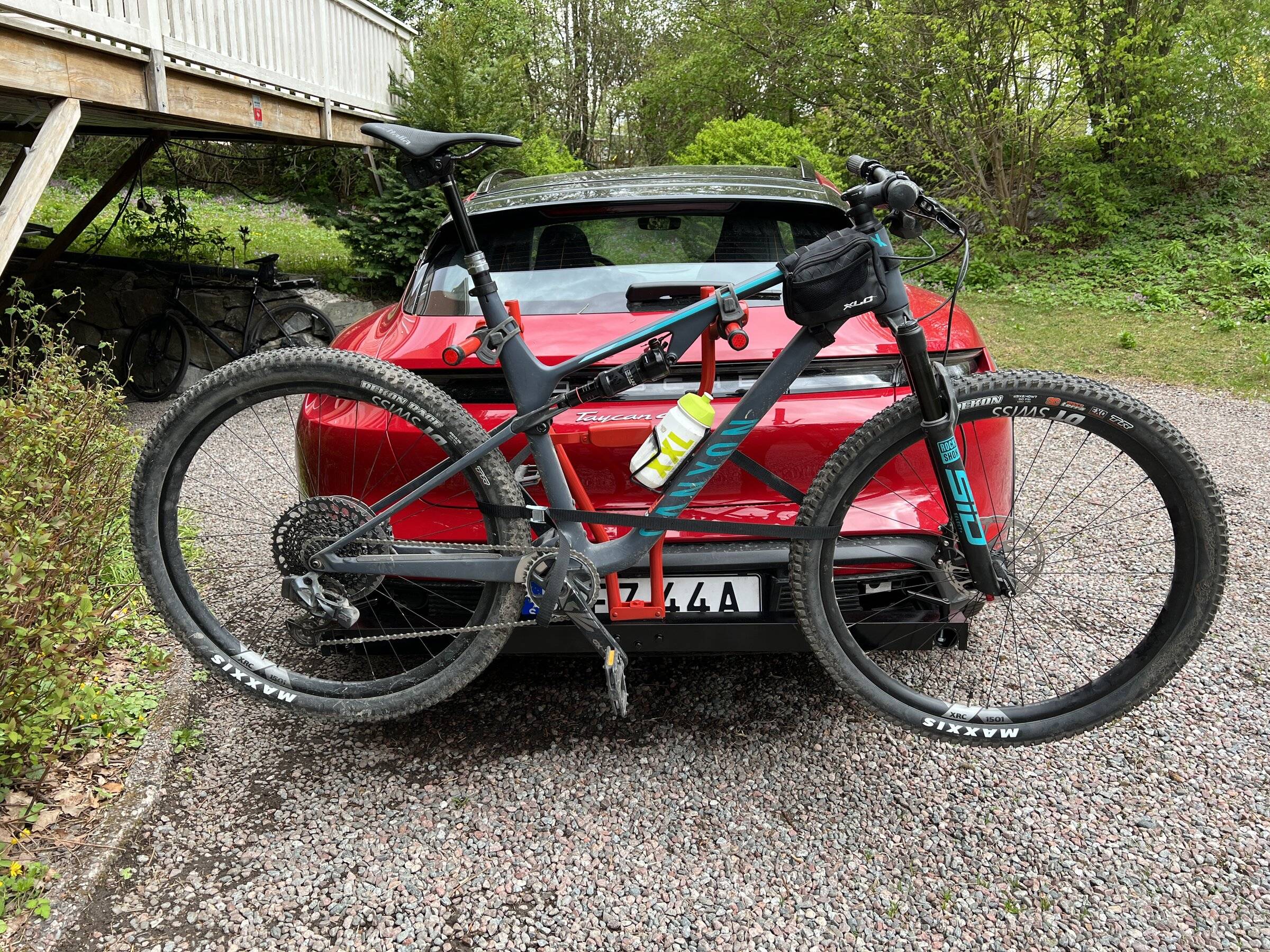

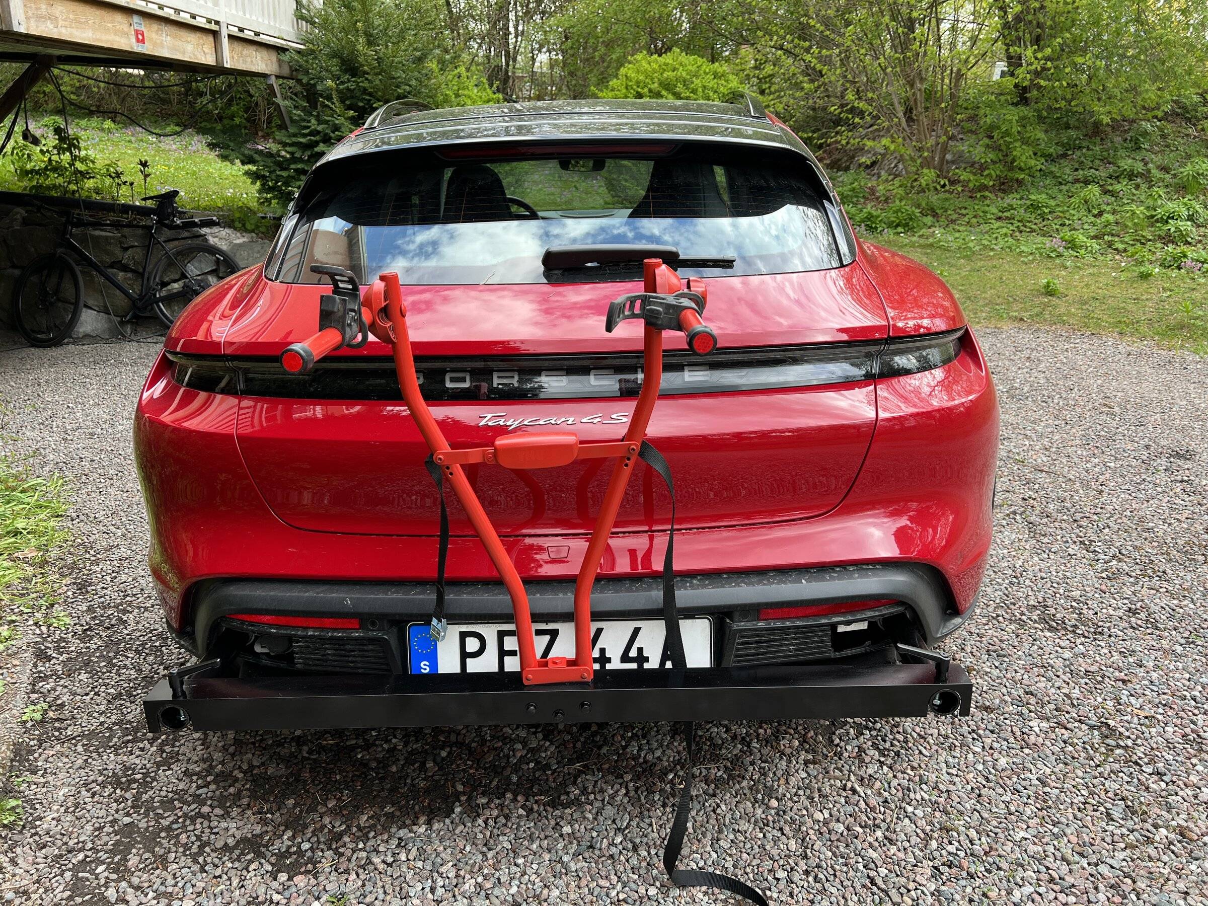

Waiting for the Porsche rack* I decided to make one myself. Since I already had a basic Thule rack that I used on my previous car (with towing hook). I thought I could use it to simplify things. It turned out to be relatively easy and I only used a drill and a saw. I used two 48 mm aluminum pipes and a 130 cm long aluminum bar plus the bike rack. I removed the clamps for the hook and drilled holes for the rack in the bar.

Two tips if you want to do something similar:
- If don't have a Thule rack buying a new one isn't too expensive. Removing the rings for the clamp doesn't destroy it irreversibly. The rings are attached with rivets that you have to remove, but you can reattach them with ordinary bolts.
- Since the rack not is attached to the car at the top it will exert a rotational moment on the horizontal beam. You, therefore, need something with high torsional stiffness, otherwise, it will be pretty wobbly. You should not use something with an open cross-section like a U-beam or an I-beam. The best is probably a round pipe, but you could also use a box beam as I did.

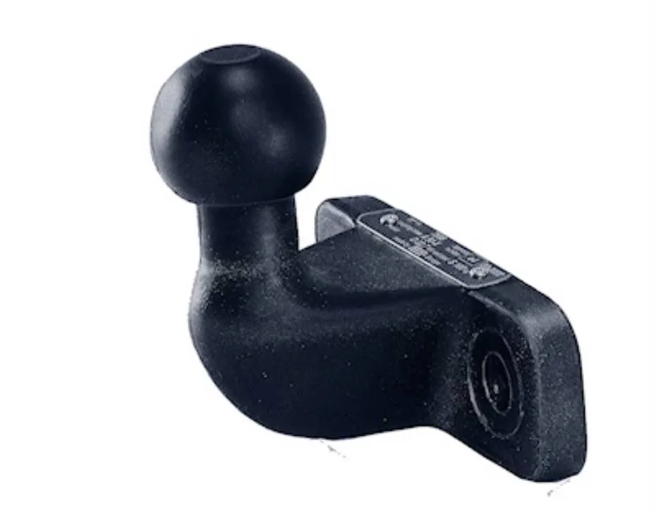

Nice, should be able to bolt on a normal European tow-hook to the horizontal bar? , like the one below:
Porsche Taycan A simple bike rack for the CT 0E3E6FC1-70E3-4809-9177-1EAEEB292A4C
that way you don’t need to cut up the Thule and can use different bikecarriers.

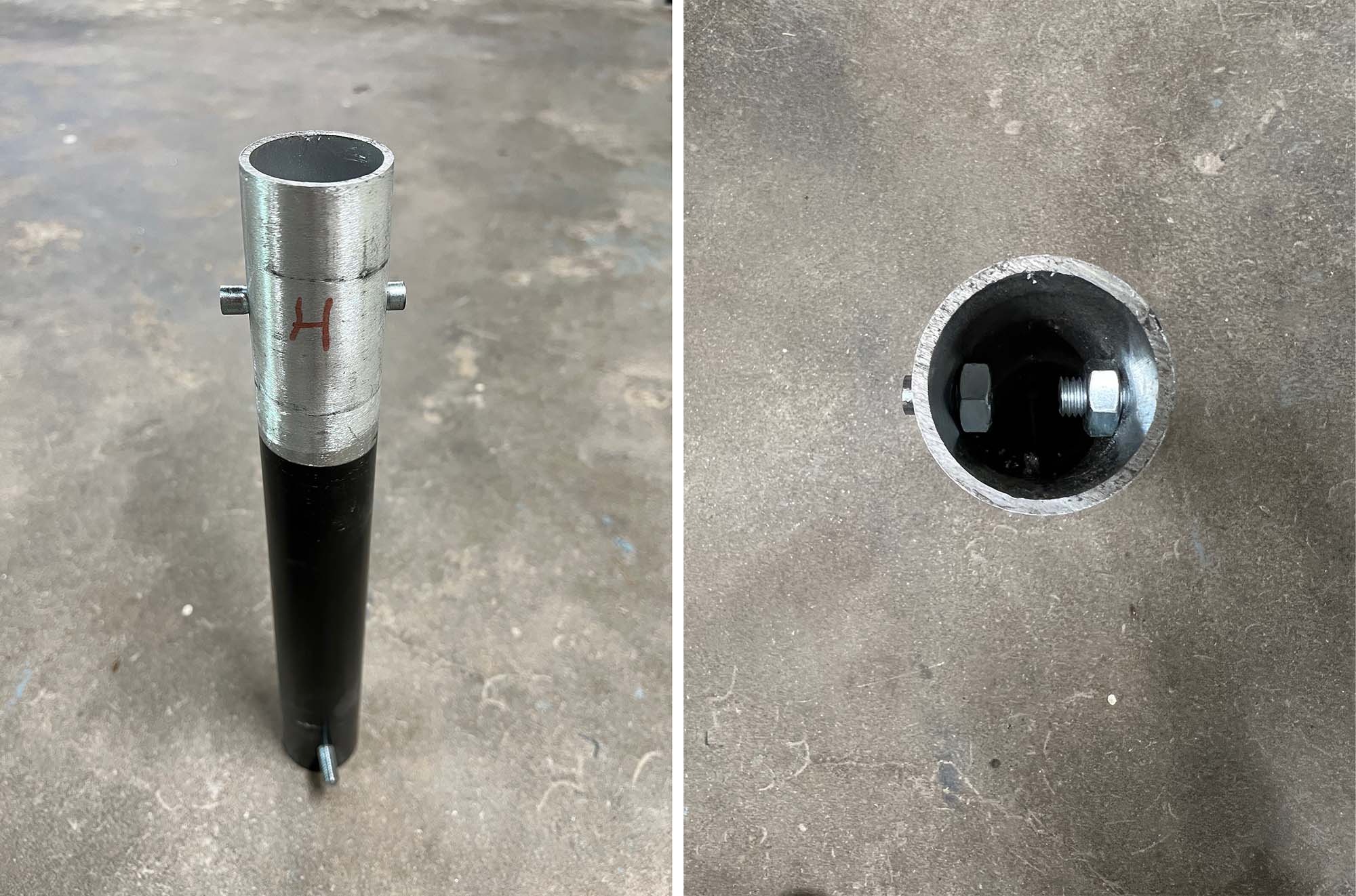

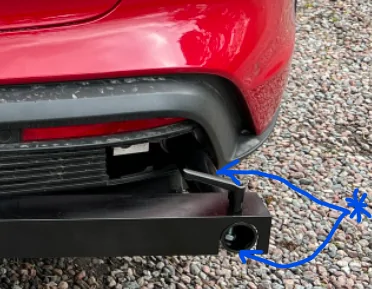

This is
I used two 48 mm aluminium pipes and 130 cm long aluminium bar plus the bike rack.

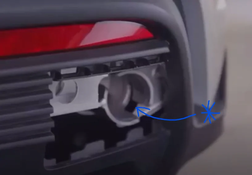

Great option here! Do you have any more specifics on the pipe that fits into the Porsche Bike Rack receivers and how it locks is place?
Porsche Taycan A simple bike rack for the CT 1653297022181
OEM
Porsche Taycan A simple bike rack for the CT 1653297246966
@bsclywilly solution below:
Porsche Taycan A simple bike rack for the CT 1653297465800
Yes, that might be an even better solution. In addition to keeping the Thule intact, it will also be easier to disassemble into smaller pieces.
You might even be able to use it to tow light loads shorter distances :)

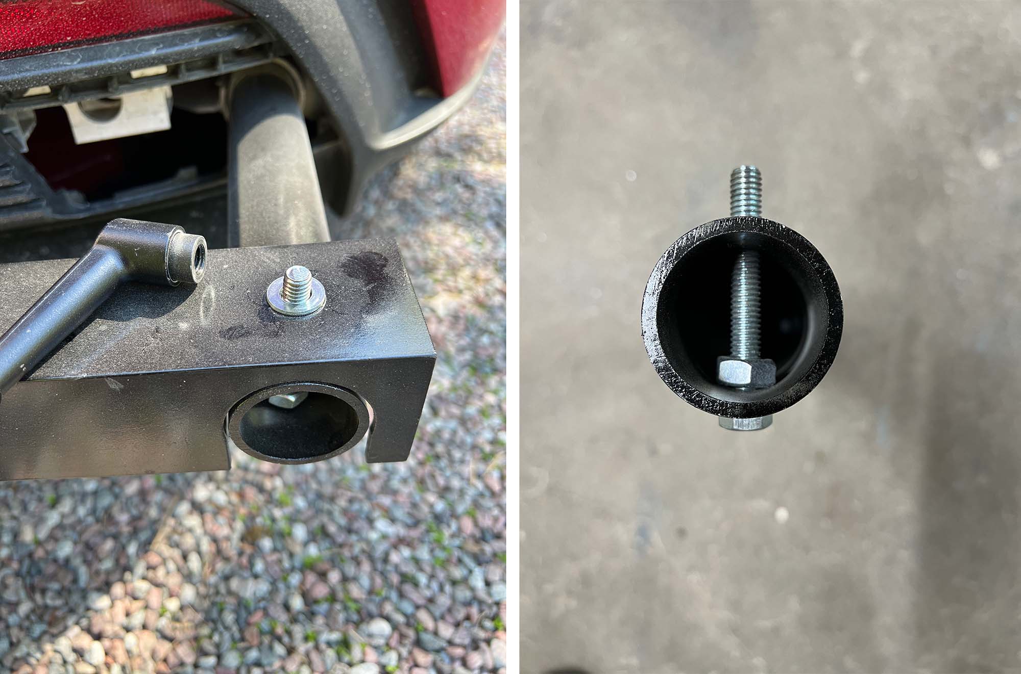

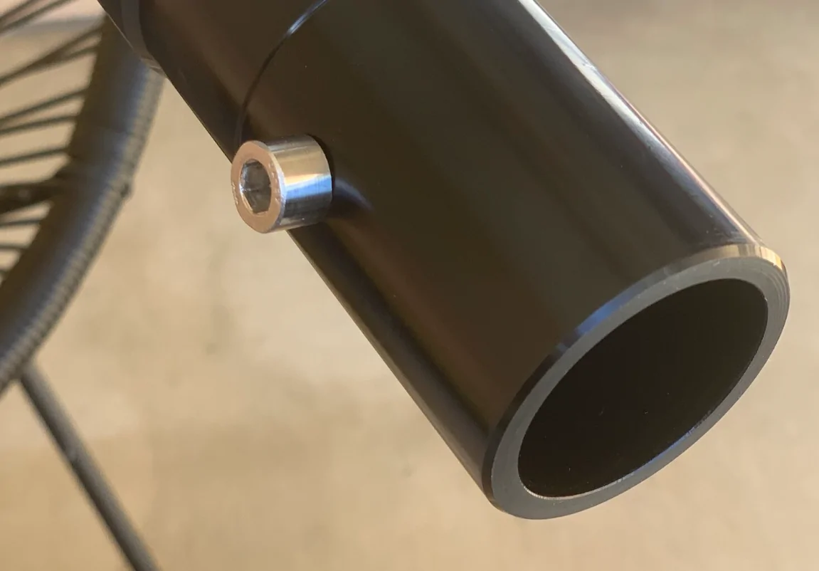

As mentioned are the pipes 48 mm in diameter. I had to reduce the diameter by a few tenths of a mm with a belt sander to fit the receivers.
The outer part is just a M10 bolt through the pipe that locks the horizontal bar. You can use a standard nut to fasten it. But the handles are more convenient and didn't cost much.
Porsche Taycan A simple bike rack for the CT bike_outer
The inner part utilizes the groves in the receiver in the same way as the Porsche rack. I used M10 bolts that had a short part without threads. I drilled holes on both sides of the pipe and made threads in the holes. I screwed in the bolts and locked them with nuts on the inside. I then cut off the heads of the bolts. The lower had to be a little shorter to fit in.
Porsche Taycan A simple bike rack for the CT bike_inner
To assemble I stick the pipes in the receiver and twist them about a quarter of a turn. I then place the beam with the rack on top and tighten the handles. There is not locking mechanism on the car side, but since the pipes are fastened to the beam they can't rotate and fall out.

This is
The socket dimensions are a bit nuanced, as the OP found out. They're 48.0mm initially, open up to a larger diameter in the center section, then necks down to 47.5mm at the deepest section. Hence, the reason my bars have a step next to the pins, in case anyone was wondering.
I was, actually :)
