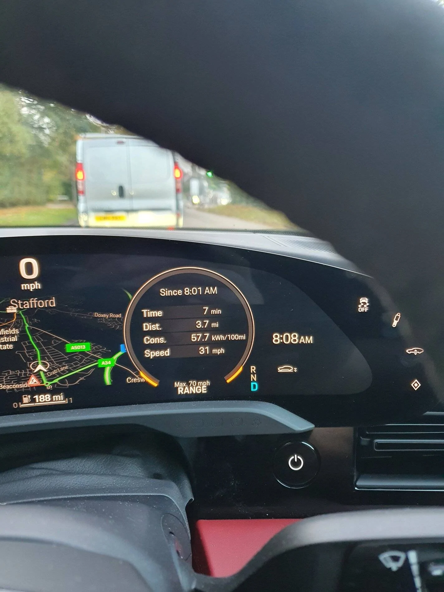

I was going to ask about that. I'm sure it makes no difference to the kwh per 100 miles which size battery I have.
I've attached my dash after a few miles on a slow road this morning. Seems really high to me. I'd be interested to see other people's examples. I don't think I've ever seen it below 42 but I'll check.
Your kWh consumption is exceedingly high, but for a very short distance so not so important. Where you just starting a trip and heating or cooling the car or the batteries?

No pre heat/cooling. (how do you heat the batteries?)
I've turned the A/C off and done the journey in reverse and hardly touching the accelerator.
It's now mid 40s.
Temperature is around 65 outside.
My tyre pressures are 2.7 Bar on 21" wheels. What's everyone else running at ?
KensingtonPark
Jul 1, 2019
871
685
New York, NY
Agreed. For very short trips around town, I can get numbers like this, but for trips longer than 10 miles I usually get in the 33kWh/100mi range.
I would tinker with the Recuperation settings to see if that changes things. I usually take short trips with Recuperation OFF.

If I'm trying to stretch out the range I always put recuperation on. I don't see any settings though, either On, Off or Auto. However you have to remember every time to put it back on as it doesn't save. I can actually live with 190 miles as a range but its when you hear about such better results then I think something isn't right.
I run with 40 psi on all four wheels, about halfway to recommended fully-loaded pressures on the Turbo S (2.76 Bar, nerd engineer with racing tire pressure gauge).
They heat or cool if it is too cold or hot, or if you program a charge station as a destination.
