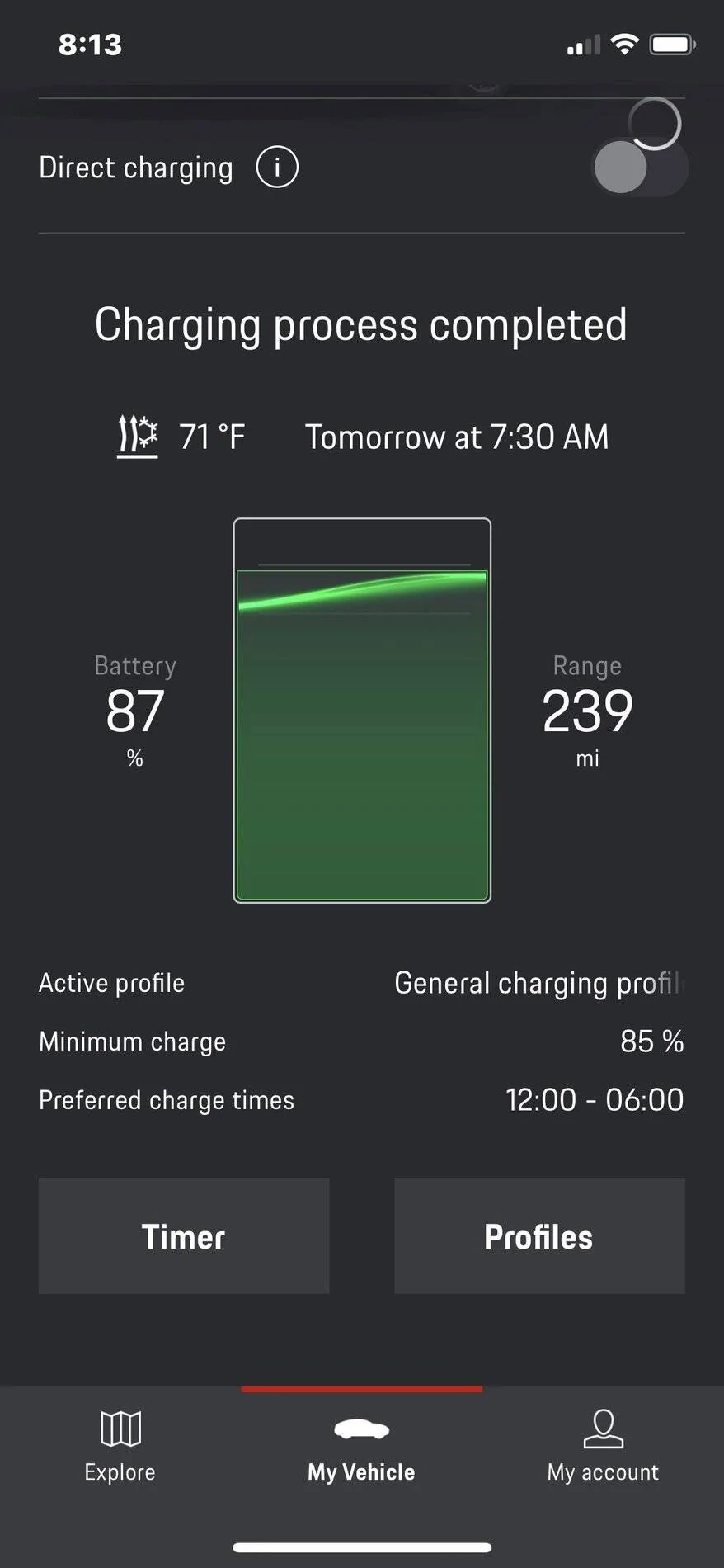

Same happens to me too - most of the times the charging stops at slightly above 85%. I don't think this is an issue but I am curious as to why not 85%.

That sounds like you have a "Profile" set to a 25% minimum charge, and a "Timer" set to 85% at some time in the morning.
Short Answer:
Yes, the variation of a few percentage is normal in my experience. Nothing to worry about.
My assumption is this: The car negotiates a power level when first plugged in. It then calculates how long it will take to reach the requested level (85% in your case). Now, it calculates when it should start charging so that it reached your target at the time set in the Timer. (in your case, maybe it starts charging at 03:00 to reach 85% by 07:00) But maybe the voltage was little higher at night due to less resistance "upstream", and with a higher amperage it charged a little faster than expected, and it keeps charging up until 07:00, and so it overshoots the target by a percentage or three.
