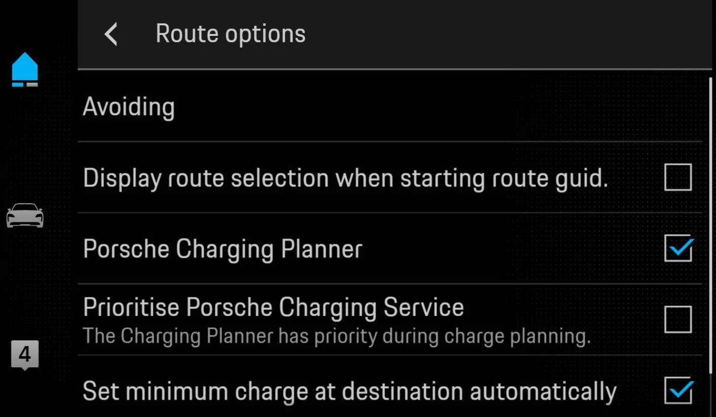

Do you know how it is possible to check if PIRM is active and activated? I have ordered it but I can’t see in PCM if it is active. My screen looks like the one you show. Thx.
8,733
5,213
GTS ST, Macan T
It's an extension of Porsche Charging Planner and only comes into operation with Range Drive mode.
There is an option / configuration - "Always allow optimisations by PIRM" but if not standard with the car then check your list of Porsche Connect services to check activation. It is not specifically listed on mine but it is standard equipment in UK.
With PIRM active you should see the Range Speed with 'Auto' displayed in the digital cockpit and alternative routes when selecting a destination.
Thanks a lot. Really useful. I don’t see it in my connected services but the manual say it should be activated. I ordered it. It shows in the option list in my app and it doesn’t show as FOD. ALK and PID do show (will install for the free trial). So I presume I have it.

The tell tale sign will be Auto speed setting with Range Mode active when Nav is active.
The simulator doesn't show this or the config option.
I'll check my own PCM today and post a picture.
It is frustrating trying to establish these things!
