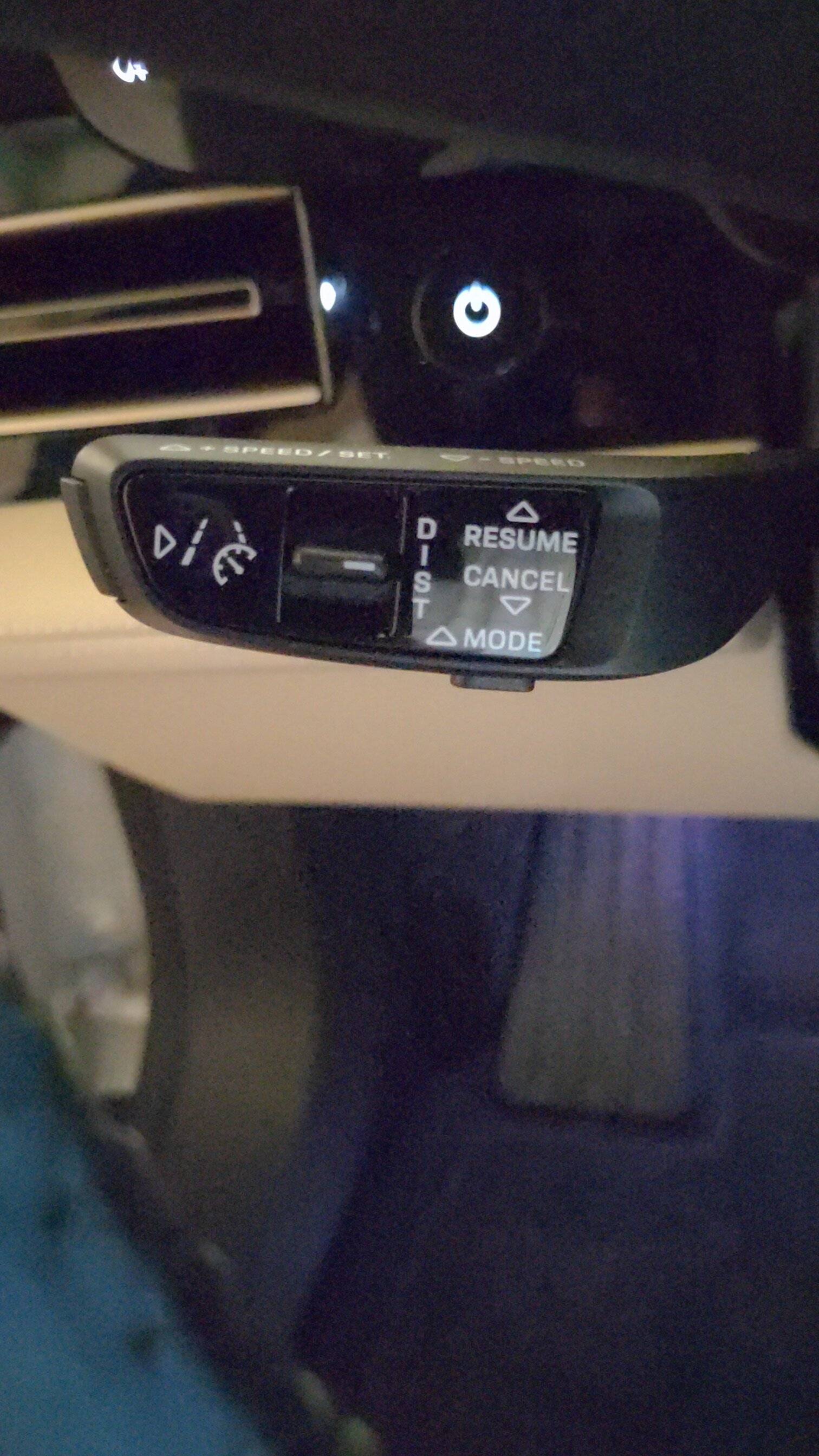

Sorry for what may be a stupid Q, I tried to use due diligence and search but after combing thru a half dozen search results, couldn't find the answer to my question.
Porsche Taycan Active Cruise Control (ACC) question 🤔 IMG_20220714_082410
When using ACC on the freeway, I can figure out how to adjust the following distance to the car in front of me. I think the current max following distance it defaults to is a little too far but I cannot find the option in the settings menu or the steering wheel controls to adjust this.
In my other cars with ACC this adjustment is pretty straightforward, with my Kia SUV having it as a dedicated button on the steering wheel.
Tia 👍🏼

You can adjust the distance with the small 'DIST' lever on the cruise control stalk.

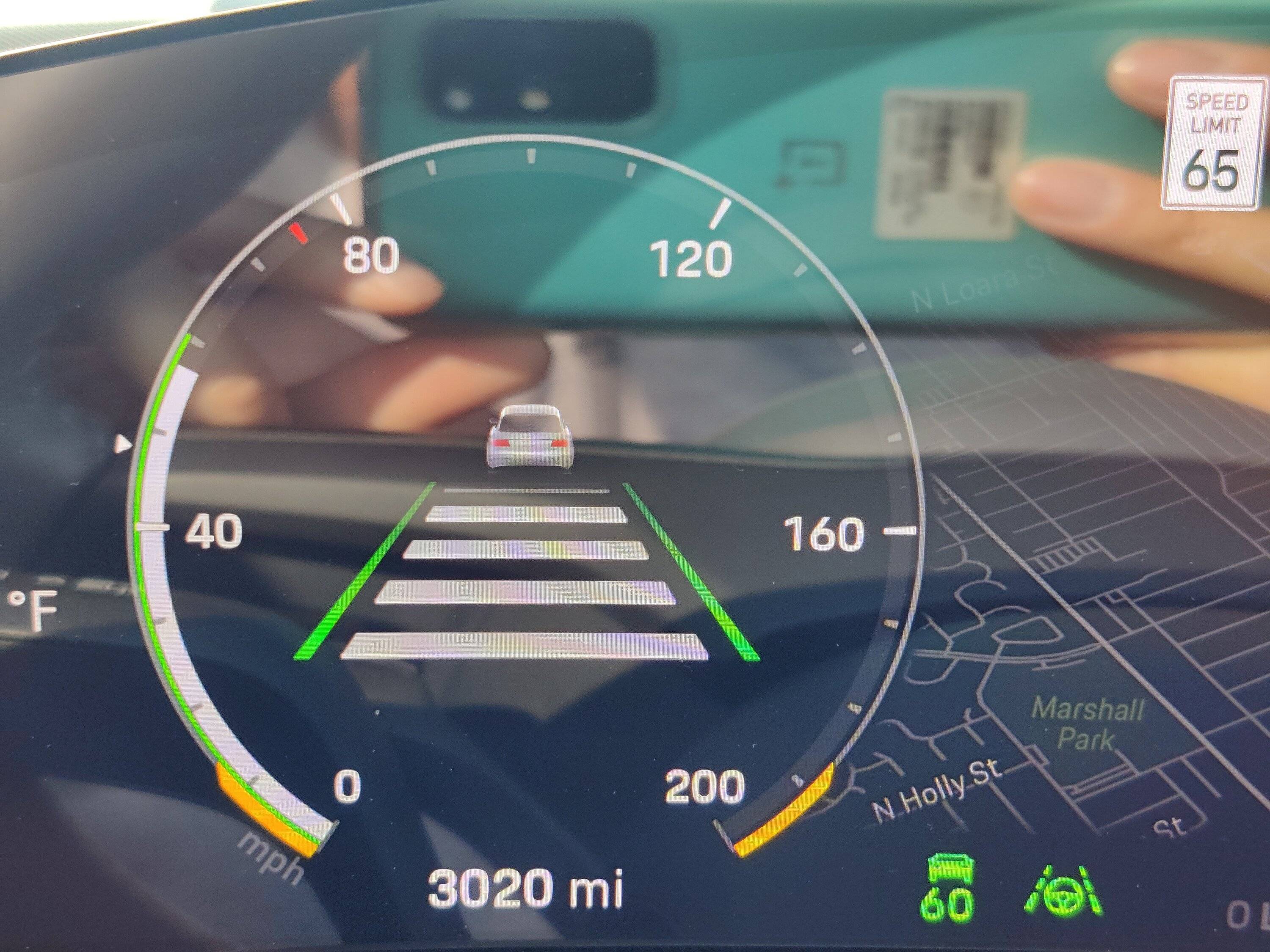

PS I don't recommend taking pictures while driving 58 mph when the car in front of you is doing 48 ...

*cranes neck to actually read the writing on the cruise control stalk* I see it now thanks.
My excuse for not knowing is my two previous Porsches had cruise control without ACC so I generally knew how to operate the cruise control stalk by muscle memory so I didn't bother to look at it too closely in my Taycan 👍🏼

Related but off topic question for those that have the option - how close is the following distance at minimum distance? I do use ACC often in our Lexus for highway commuting, but find the min distance is a bit too far for my liking, leaving open space in slower traffic that welcomes people to cut in (~2 car lengths), and people to tailgate at speed since they feel I'm impeding traffic, when actually just following the car(s) in front but at a larger distance
The distance is speed dependent. Closest is roughly 1-second behind the vehicle and furthest is just over 4 seconds behind the vehicle in front of you.
So think of it more in terms of time and the distance increasing slightly as your speed increases.

I find 2 bars works OK most of the time but sometimes have to reduce it to 1 to stop people cutting in if it’s busy. 3 or 4 picks up cars too far away and slows down too early. It’s also good in stop-start traffic.

Do what works for you. I do two bars for speeds 40 mph and under, three bars from 41 to 64 mph, and four bars over 64 mph. If there's a truck on the interstate in front of me, I increase it to five bars. I'm probably more cautious than most, but getting to my exit two minutes later is worth not getting a cracked windshield no matter how many people cut in the space in front of me.
