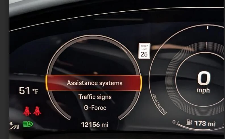

Find Assistance systems in the left tube.
Porsche Taycan Adaptive Cruise Control 1732919703227-zo

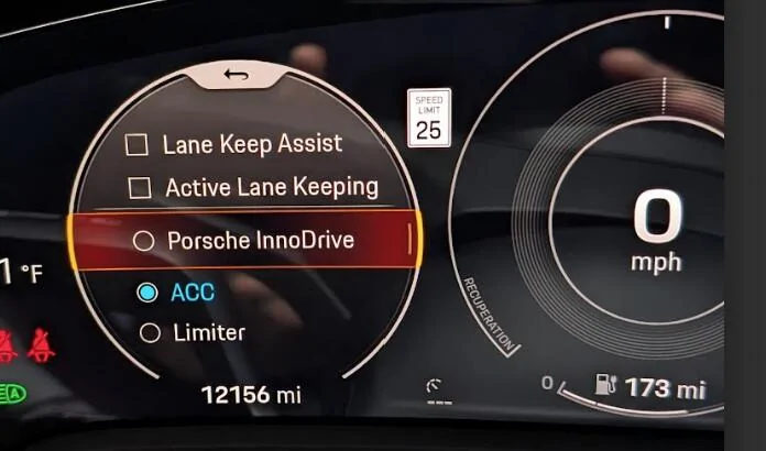

Click into it, make sure Assistance is turned on via the left button on the assistance stock.
Then you will see what you have as shown below. ALK is what you are looking for.
