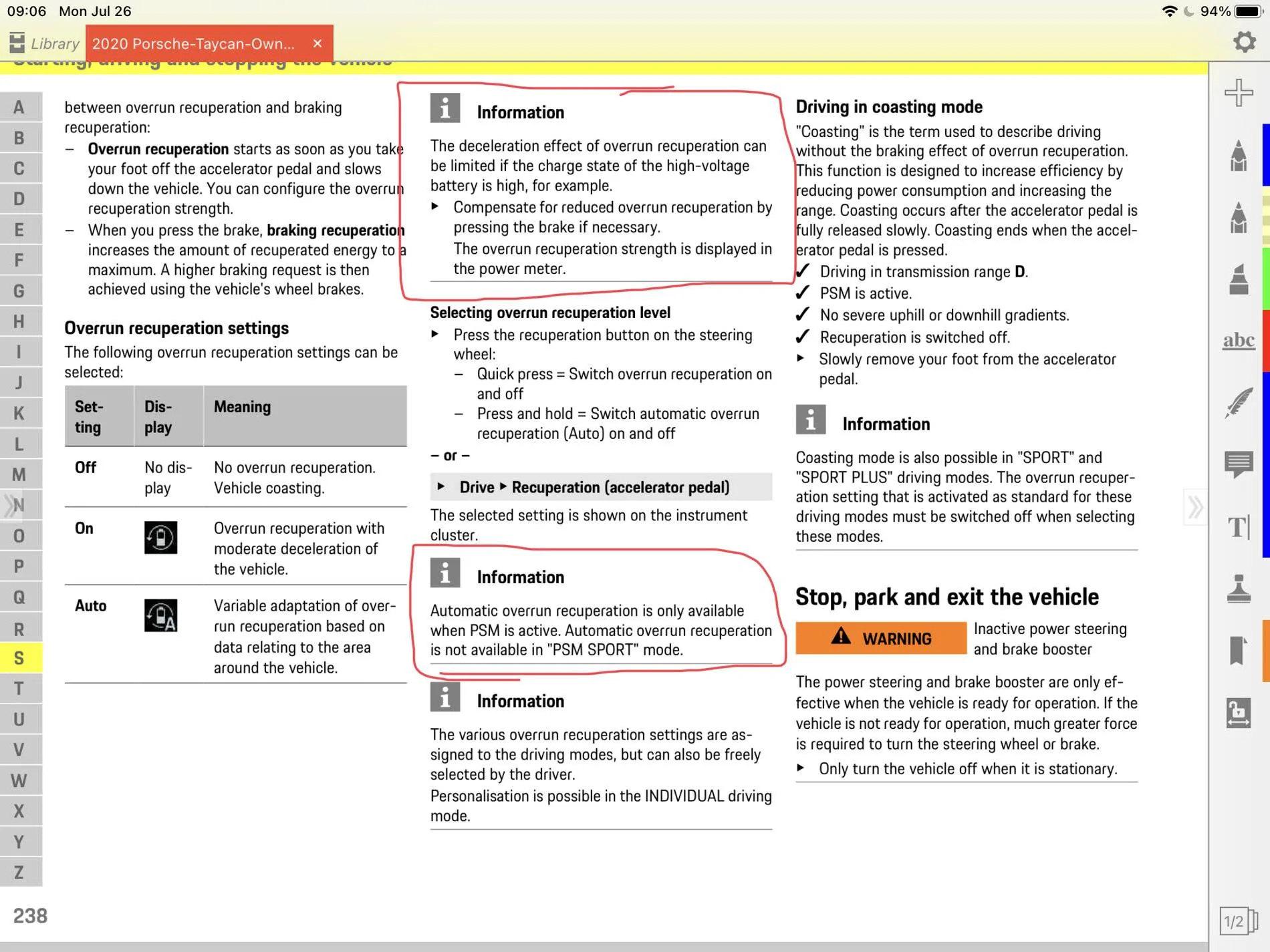

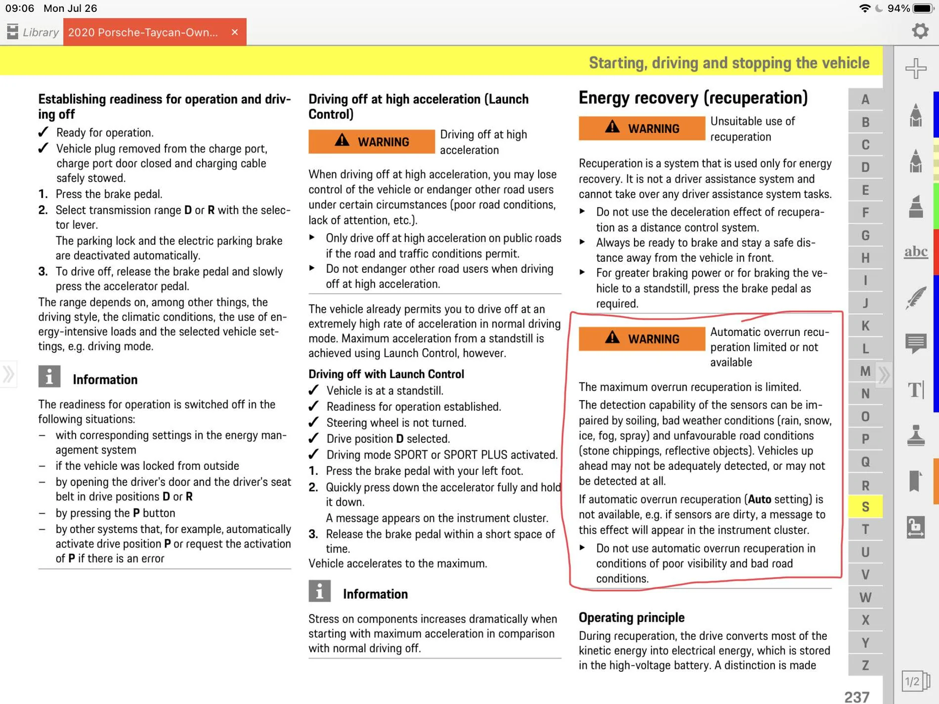

@KensingtonPark
If you are referring to Overrun recuperation in Auto, I found a couple of interesting notes page 237, 238 US manual.
Dirty sensors, battery SoC and PSM Sport mode.
Hope this helps and is what you were looking for.
Porsche Taycan "Adaptive Regeneration Not Available" F400D21E-12D1-4D56-8891-82C64854B1C3
Porsche Taycan "Adaptive Regeneration Not Available" 7B16ABF5-BDAD-43B2-95FD-4875B53D6F44
