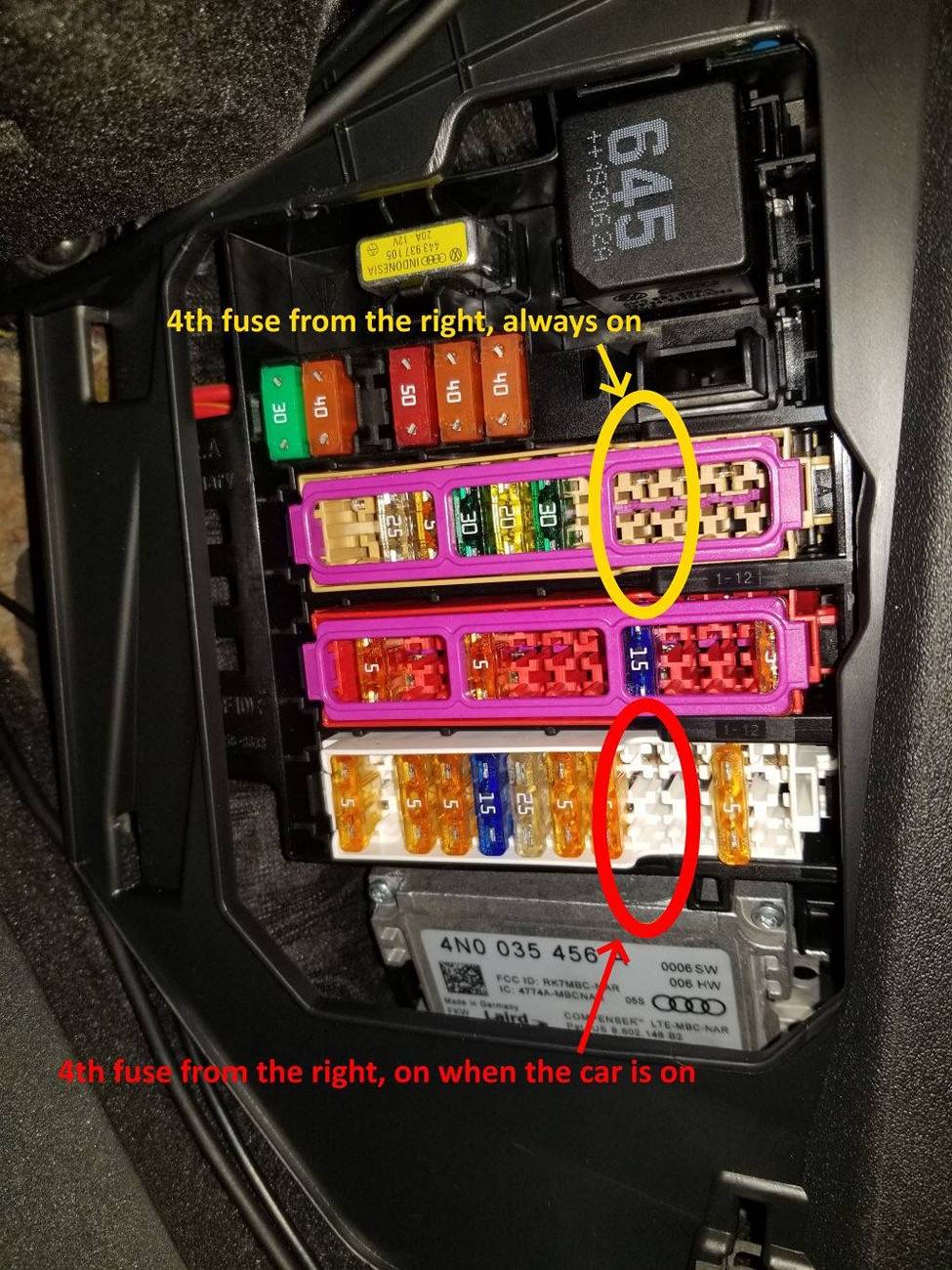

I am looking at adding a tracker to my Taycan (Bought in 2022) for insurance purposes. I can't find that the PVTS is recognized by insurance companies so I can't use that.
Anyway the models that I have been looking at mostly need a 12 volt positive and negative that is on all the time as you would expect, but I am not sure where to get this from. Instruction videos show directly connecting to the battery. Which just doesn't seem like a good idea.
Any thoughts on where to tap in that might be fused but on all the time and where I can hide a smaller tracker?

Someone did an install a while ago and noted these power sources that you can use:
Porsche Taycan Add a tracker where to tap 12V Taycan Fuse Locations

Thanks for answer. Found out that it already had one, but will run out in 6 months and it's old tech (2G). So will see if I can find it and swap it out.

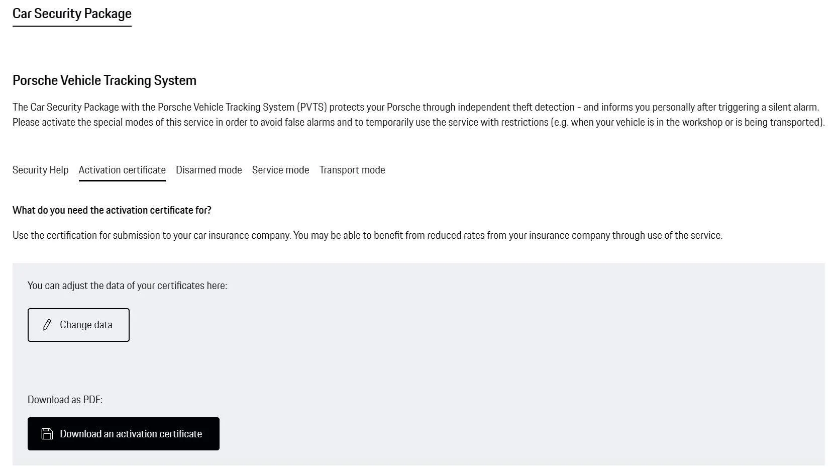

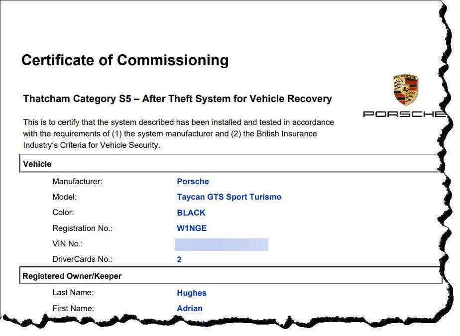

This is the cert download I mentioned:
Porsche Taycan Add a tracker where to tap 12V 1730118825654-td
Porsche Taycan Add a tracker where to tap 12V 1730118915508-x8
There is an S7 variant which adopts automatic driver recognition but not available on Porsche currently.
