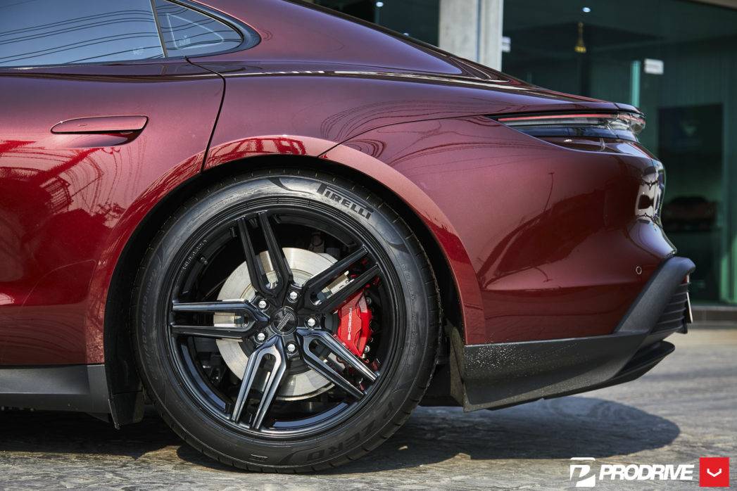

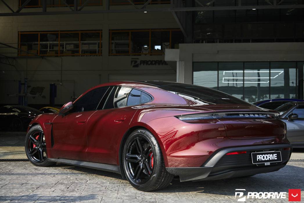

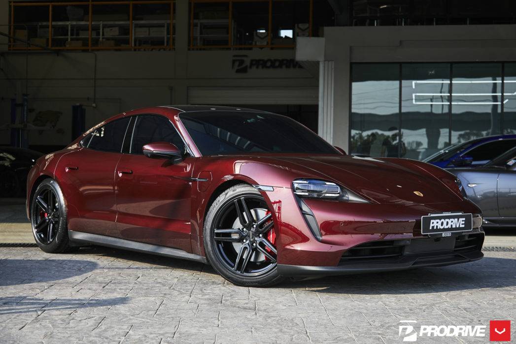

You and I both! This isn't my Taycan, but these are the pictures the Vossen gallery that sold me. I love them. My fitment will be gloss back on a black Taycan and I will certainly come bac with pictures when it's in hand.
