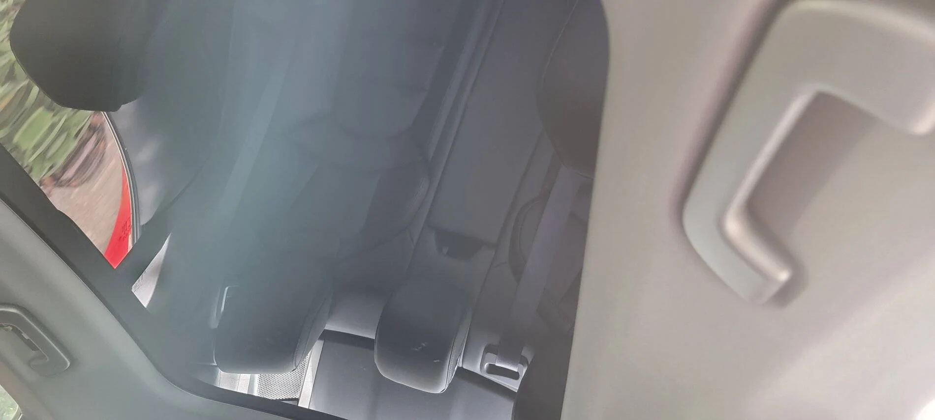

To help the AC and to solve my problem with the panorama roof, I put a black completely light blocking foil on the outside of the glass roof.
Porsche Taycan Air conditioning and panorama roof! 20210630_125638
Visually there is no difference on the outside, but on the inside I have now an interesting mirror effect which makes the cabin feel even bigger. Even though the glass still gets very hot on the touch it does now blocks all sunlight heating the top of my head. This is so much more pleasant particularly now, when the sun is 90° in the sky. :like:
