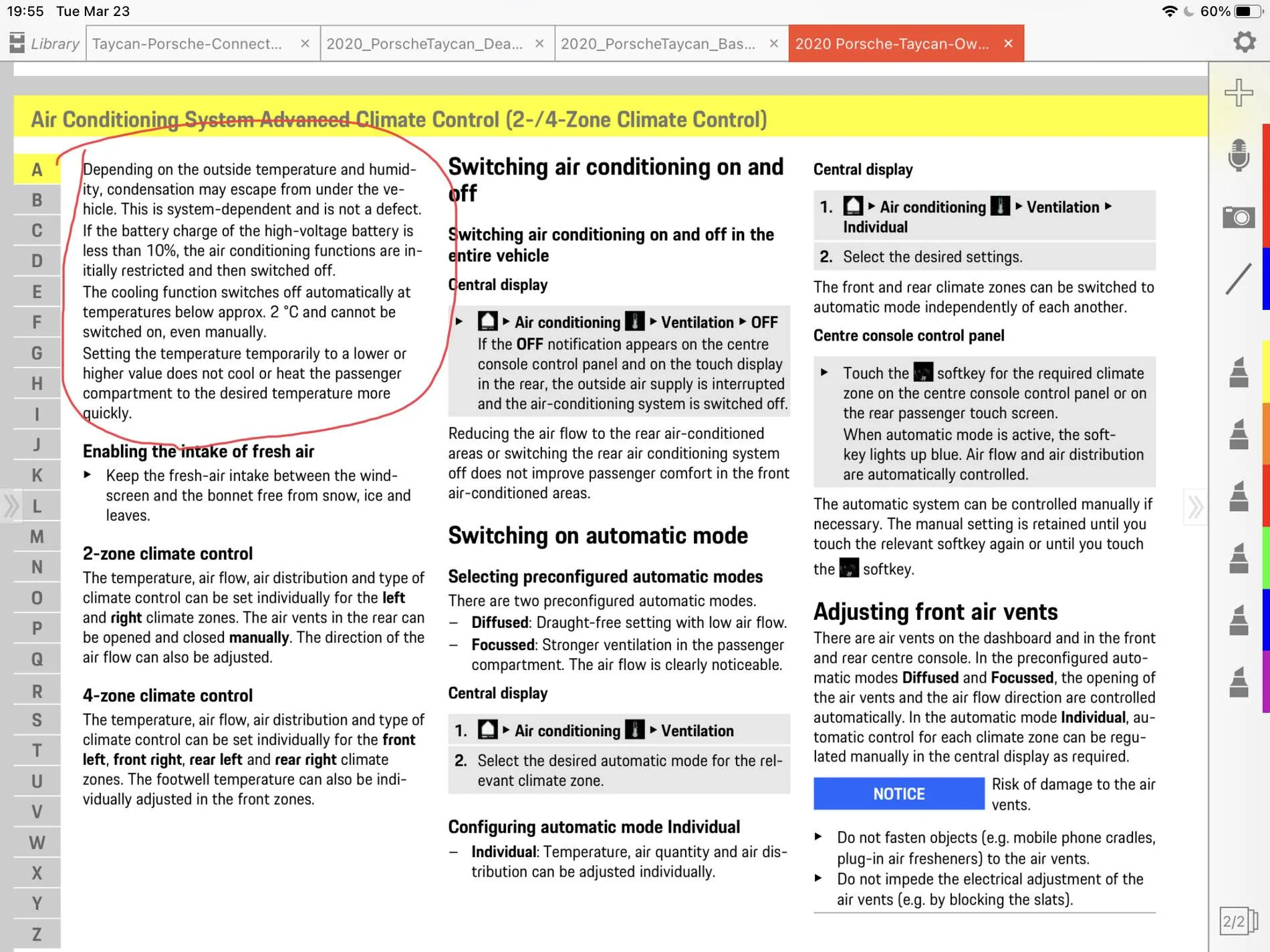

I realize you probably have warmer temps in Australia right now, however, page 46 US manual discusses that at approximately 2C the AC cannot be turned even manually.
I think @chrisk comment about your vehicle having had the reduced power warning previously may be linked.
