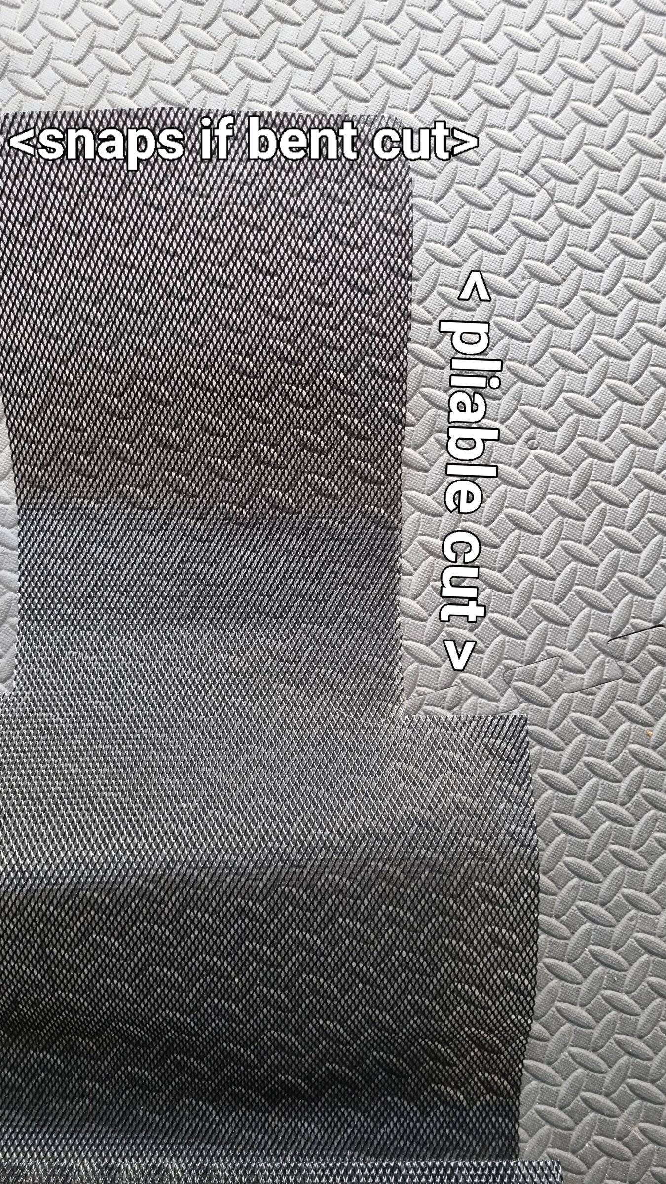

Funnily enough I was doing a similar thing today with the same kind of mesh.
It was only near the end when I noticed the groove behind the fins and was wondering if it would fit.
I also discovered with the mesh, there are 2 ways to cut it from the roll. Cut a strip from the short edge and it will snap when bent, but cut a strip from the long edge and it's far more flexible.
If you have any luck please let me know. My mesh just came, but I’m not seeing any place to slot it. I can feel the lip and understand the finished product, just unsure how to insert it.
