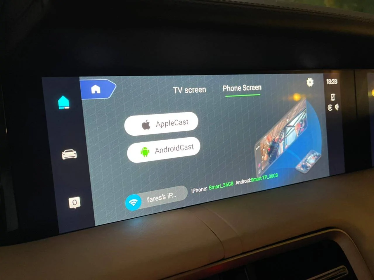

Just to get you guys to know my setup
in USB port one i have the Wireless Apple Carplay Dongle
Carlinkit 2.0 Wireless CarPlay Adapter U2W for Factory Wired CarPlay Cars, Compatible
https://www.amazon.ae/Carlinkit-Wir...ds=Carplay+wireless+2.0&qid=1614282796&sr=8-2
_____________________________________________
For my Second USB-C port i have the Carplay Box
i use my phone to connect the WiFi & it has built in Android software that broadcast from the Apple Carplay protocol. Technically its not a hack but more like a loophole.
Its useful for charging sessions or Traffic and if you want to watch some videos
It also has a USB port if you want to have music in a USB if needed
it also has a play store (Google) and can download Many other applications
here is a video on Youtube about it

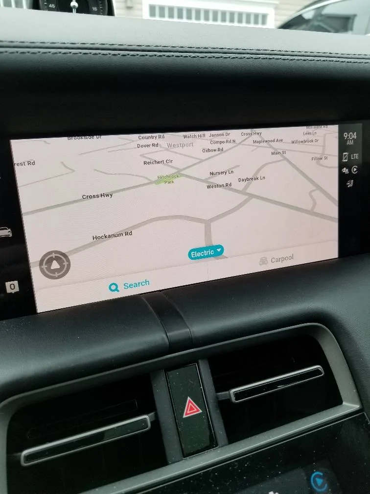

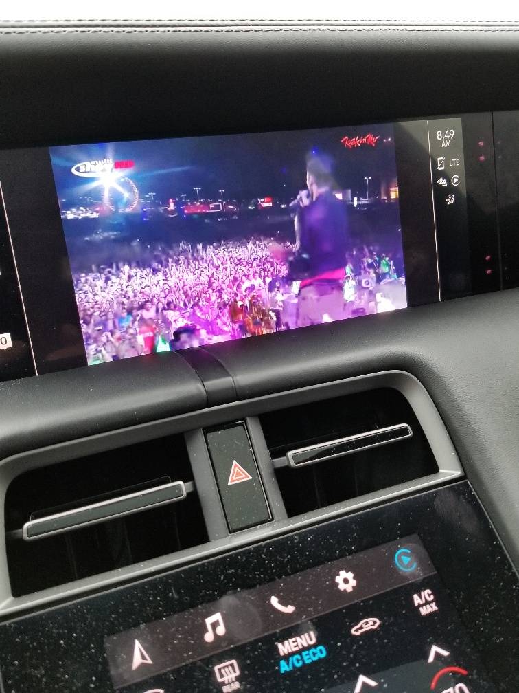

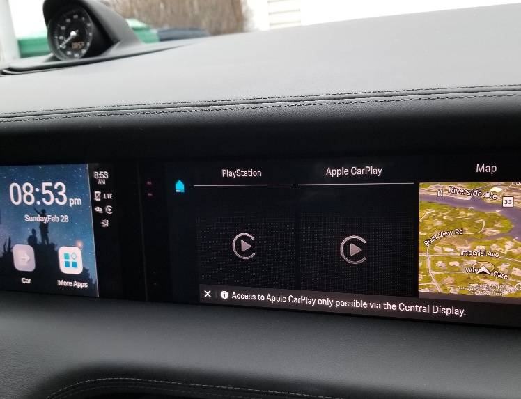

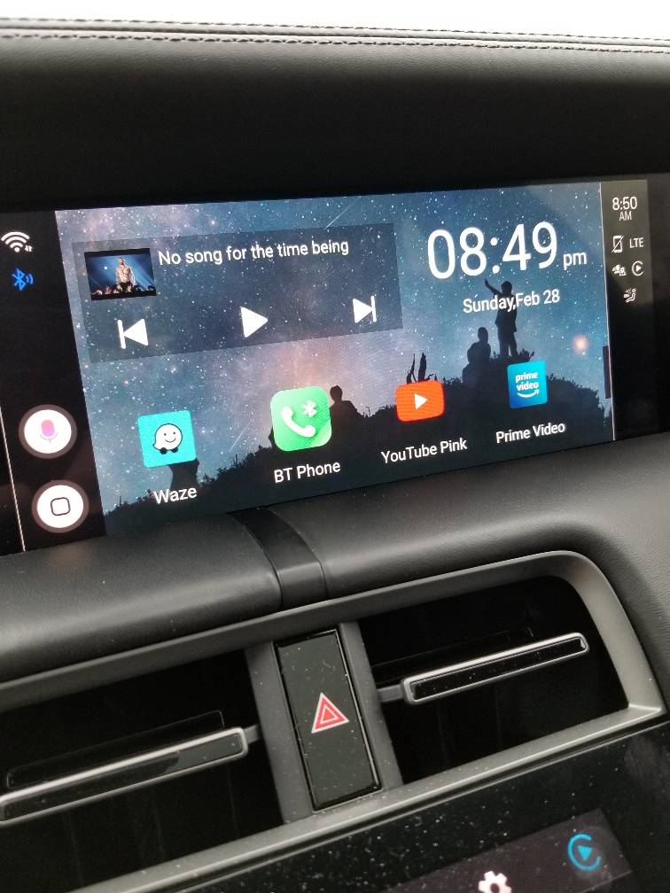

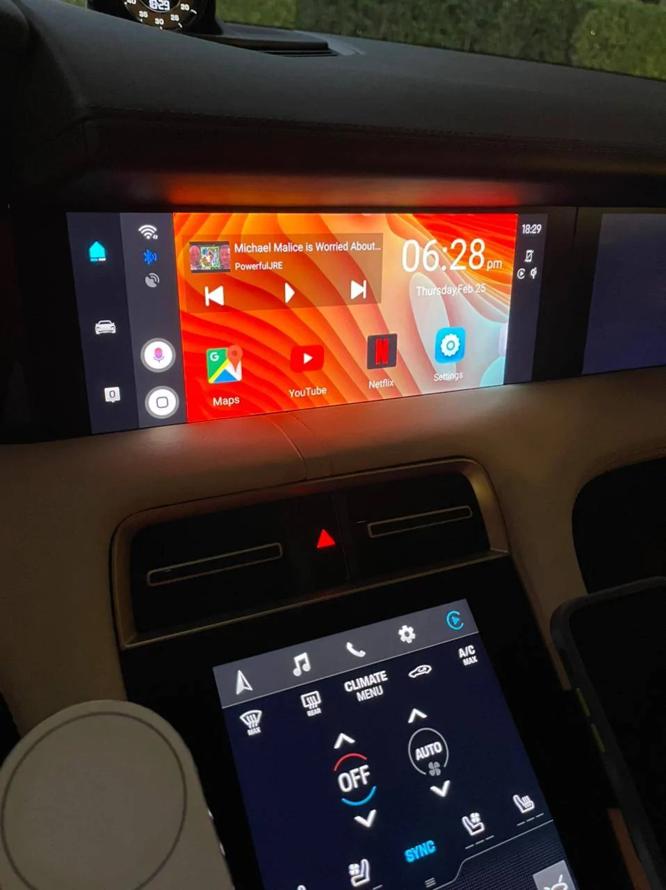

I received the CarPlay AI box last night. As a reminder, I do not have an iPhone so CarPlay doesn't work with my Samsung Android phone on the Taycan. The purpose of this Box is to use the wired CarPlay interface in the Taycan and to replace the Apple environment with the Android platform that is built in the box. Other than the hotspot from my phone it does not use any of the apps on my Samsung phone.

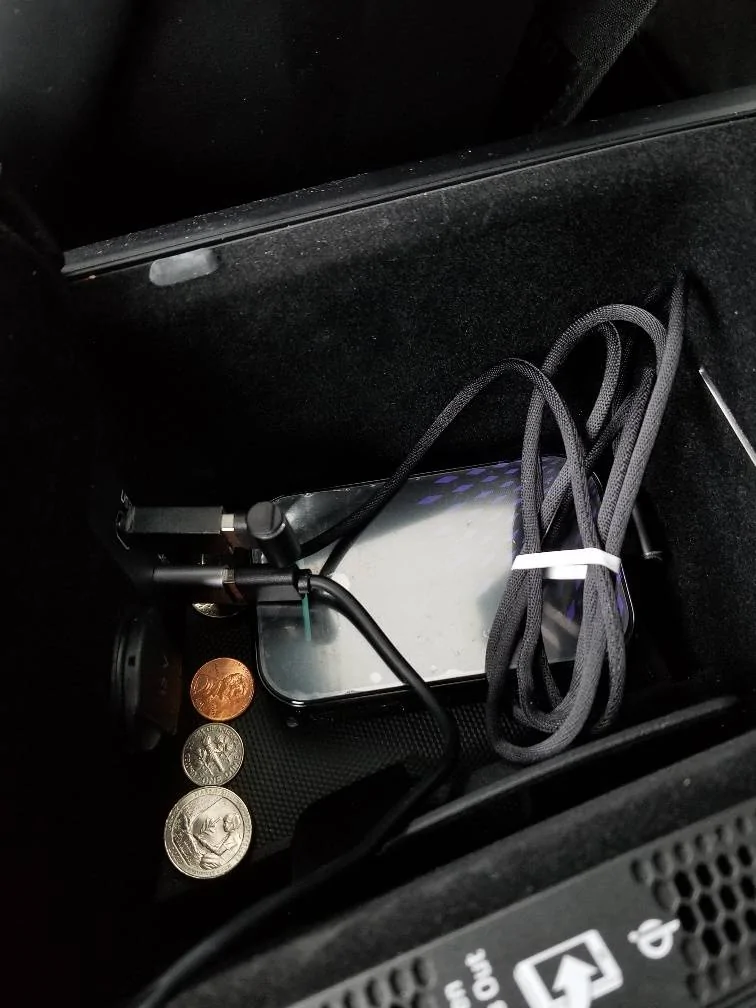

I used the USB-C connector under the center armrest (with an adapter for the USB-A connecter that was on the cord provided with the box). Once connected it starts CarPlay on the Central Display and lauches a screen with a handful of Android versions of apps. The box has access to the Google Play Store to download additional Android versions of apps onto the box. I downloaded Waze, Amazon Prime Video, Youtube Kids, and Tubi. The downloads take some time because it uses the Hotspot on my phone to access the internet and I have only two bars of cell strength at the house. The hardest download was an update for Google Display Services.
Bottom line - It works.
Pluses:
  1. I can access apps on the larger PCM screen instead of my Samsung phone (Waze and Google Maps)
  2. Video plays on the PCM screen both when parked AND in motion.
  3. Fairly easy install.
  4. Inexpensive (less than US$230 on Amazon).
Minuses:
  1. Screen casting is limited to iPhones. I was going to try to use the apps on my phone to screen cast in lieu of downloading apps on the box.
  2. Compression rate of video and audio are high due to sources.
  3. Some buffering when using Amazon Prime Video due to reliance on cell signal for Hotspot. I did not have buffering of videos on Youtube.
  4. Touch sensitivity is inconsistent on the PCM when using the box (I switched to using Google Assistant Voice instead of typing when possible)
  5. Some of the system settings are wrong (e.g., time display is off by 12 hours). I thought it might be a problem with the GPS signal, but Waze seems to work. (fyi, it comes with a separate GPS antenna that the manufacturer says is not required for Porsches) FIXED in Settings by choosing time zone.
Thoughts: I will try a similar box from MMB to see how it performs compared to the UBISHENG box. The MMB box will screen cast for both iPhone and Android phones. The main reason I ordered this one was because it uses Android 9.0 vs Android 7.0 (MMB box) and this one was a little cheaper.
