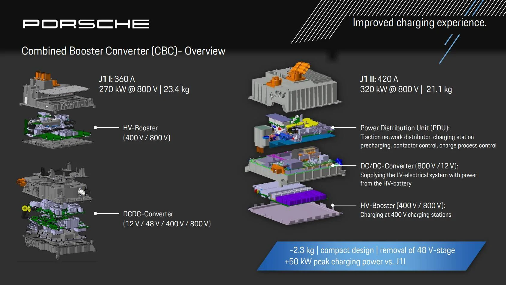

Anyone know if the old battery pack is swappable with the new one in the 2025 Taycan, Hopefully never need to upgrade it, would be intresting to know if it's possible though.
" Porsche says top Taycan models can be had with a larger 105 kWh Performance Plus battery pack, up from 93 kWh on the last Taycan. "We increased it 12% [in size] and we changed the chemical density, therefore it's more powerful than before," Taycan program director Steffen Christian told me recently. "It helps with the performance and it helps with the range as well."
Most likely not, since the cooling system is totally different and designed specifically for the new battery pack, plus the battery controller hardware is brand new. The most likely scenario is to have the same battery pack enclosure with a different chemistry cells assuming they can adjust the software to its new properties. This is a long shot, but for them to keep making the same battery for a long time to have enough to cover warranty can also be more expensive.
See the graphic below. For example, the new battery is controlled by a totally different hardware (PDU), and the engineers keep saying that the cooling system is completely redesigned, such as it now captures residual heat from the battery to warm the cabin. However, in this major of a design change, although a simplification (i.e., no 48V bus), new things can go wrong until tested at scale.

Definatley not going to happen based on that information, Only hope is like you said they upgrade the compisition of the current pack some time in the future.
