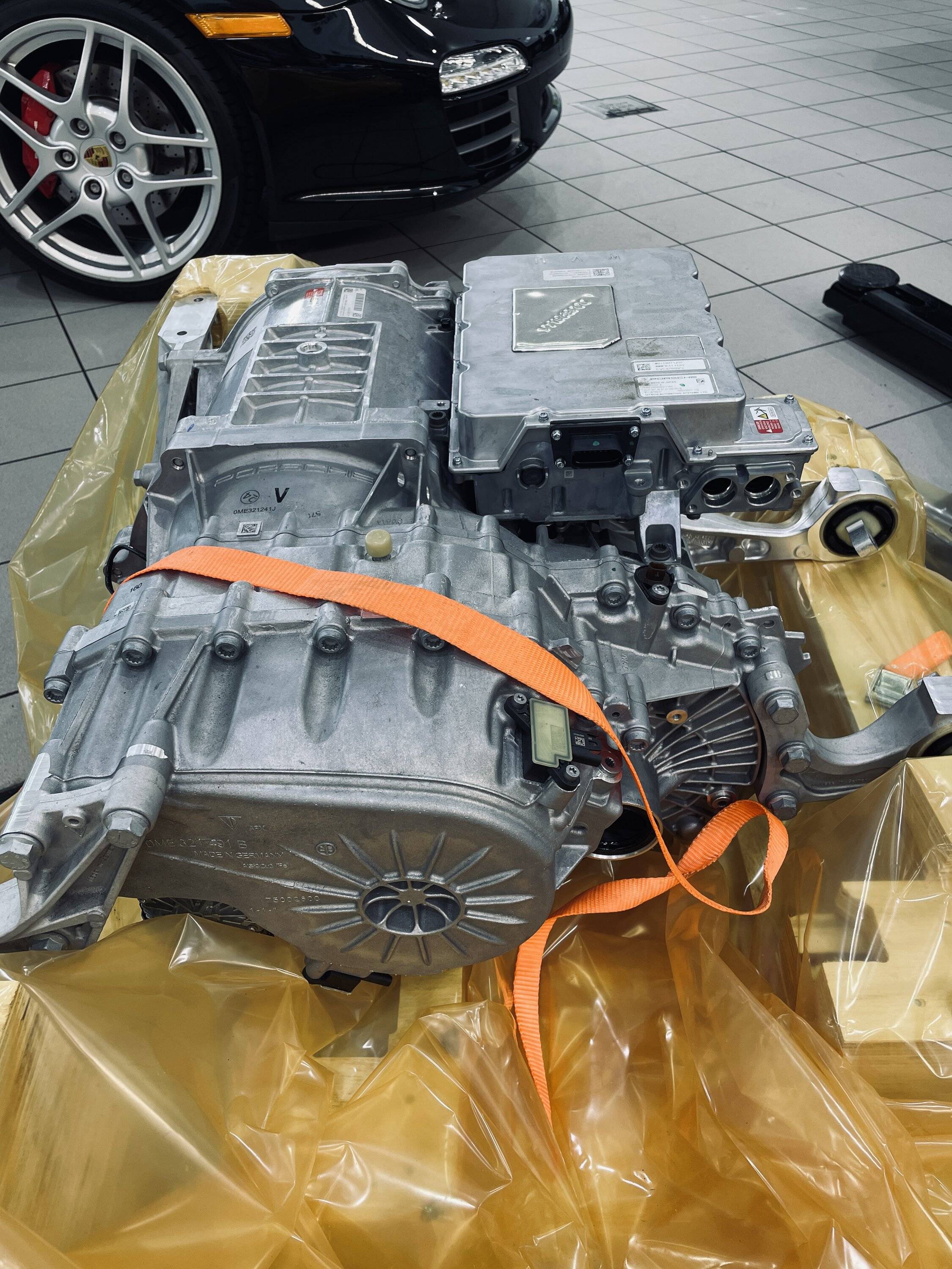

OP you're not alone. I had my drive unit replaced in 2021 for a noisy first gear.
