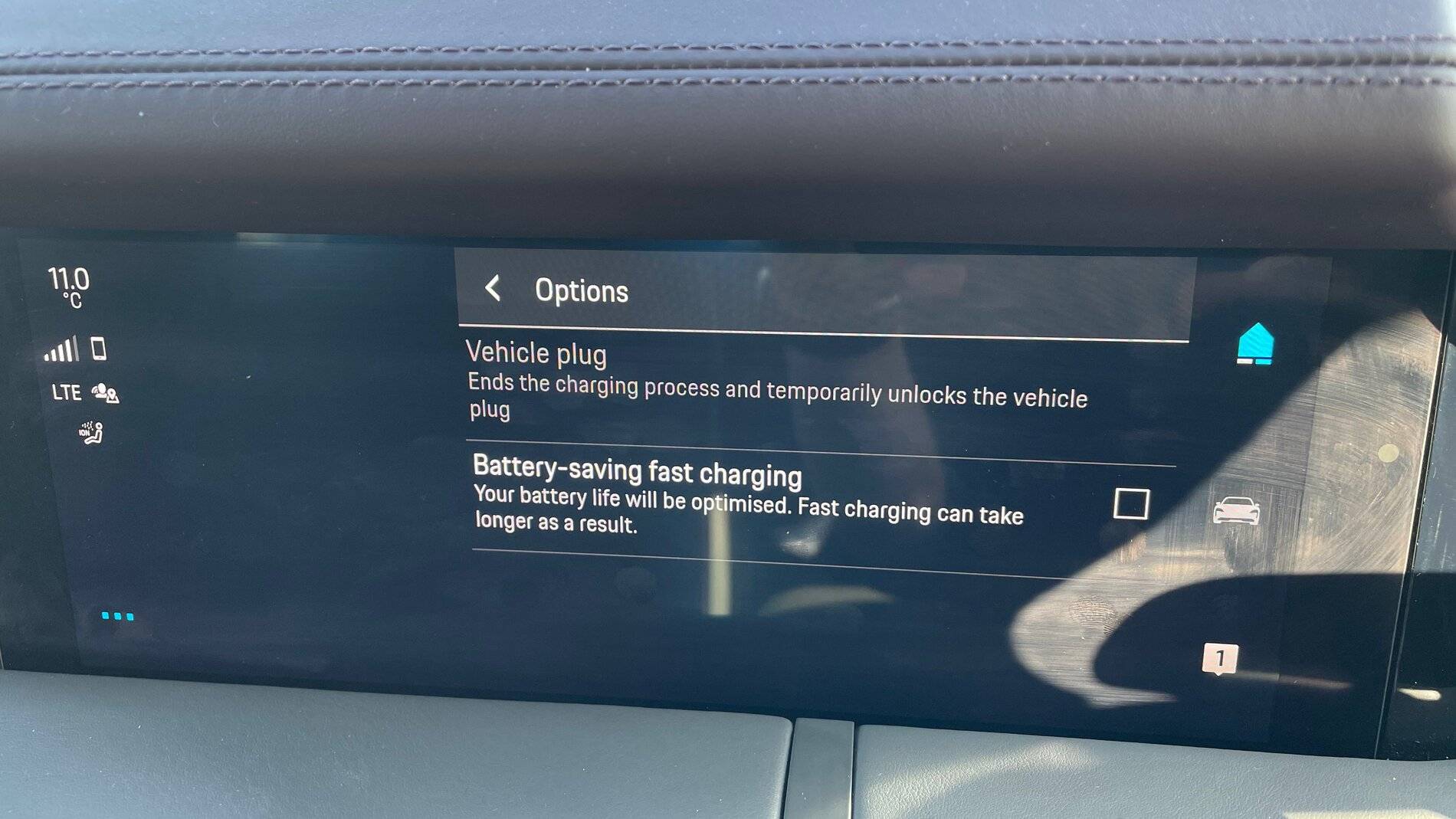

Hmmm ... my Irish spec MY2021 doesn't appear to have that option.
Porsche Taycan Anyone get a 2021 Taycan auto-recognized when using an Electrify America charging station? IMG_0082
Did you activate Porsche Taycan Charging service? I wonder if this is enabled in US only otherwise.
I do have the charging service active – even have the physical RFID card they give out in Europe. Maybe I have to charge at a supported (Ionity) charger first – not able to do that due to local COVID restrictions yet.
