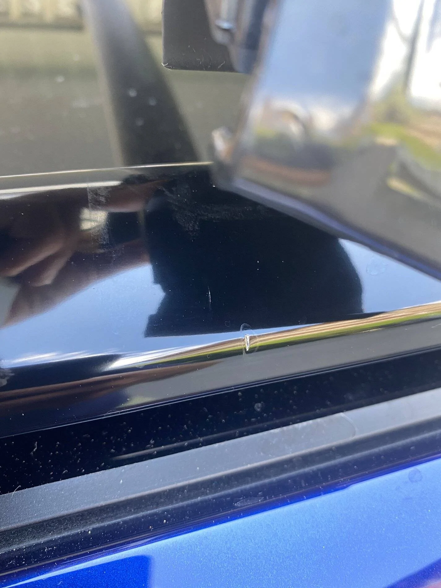

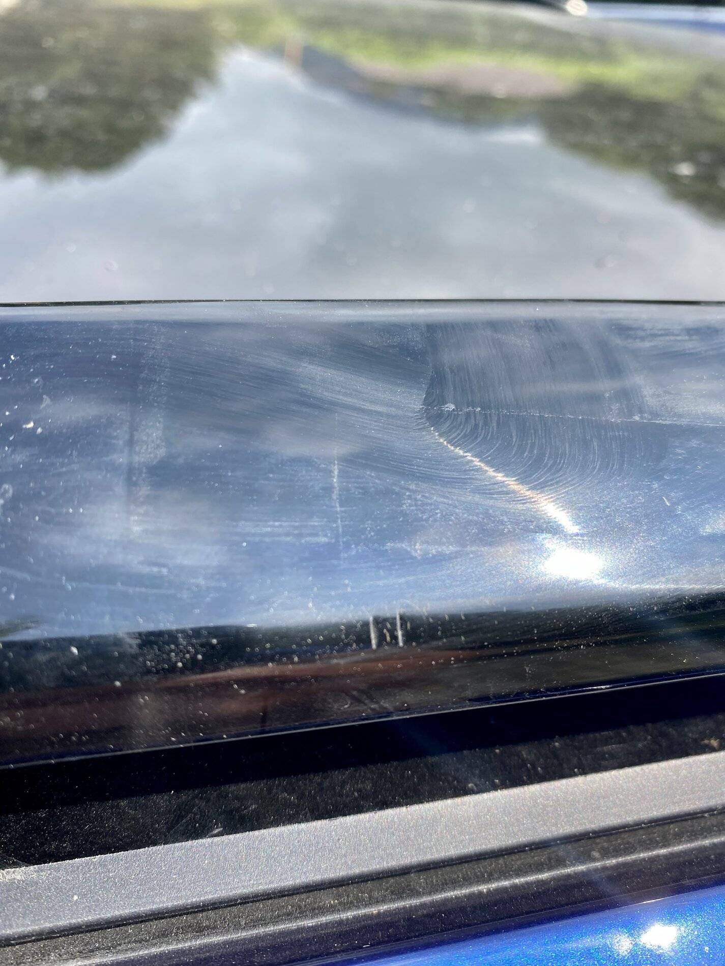

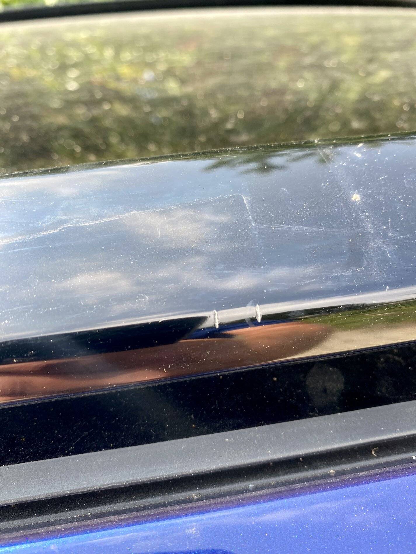

Just back from a monster 4000km road trip. Taycan CT4 with roofbox was GREAT! Fast charging at the Ionity chargers worked well and twice as fast as with my old Model X. Range was also significantly better. Just taken off the roof box and bars and the metal clamp on the bars is leaving a compression mark going through the paint on both sides. I noticed it on one side when I initially removed the bars when getting home from collecting the car (and reported it to the dealership as they had mounted the bars). Now I have another set of dents a few mm’s away. Anyone else experienced this?

A Taycan CT has the rails to mount the bars, how come you don`t mount on these? Nevertheless, whoever mounted should get this fixed…it looks pretty severe if you zoom in.

It is mounted on the rails (no alternative) - so the clamp / foot has caused this damage.

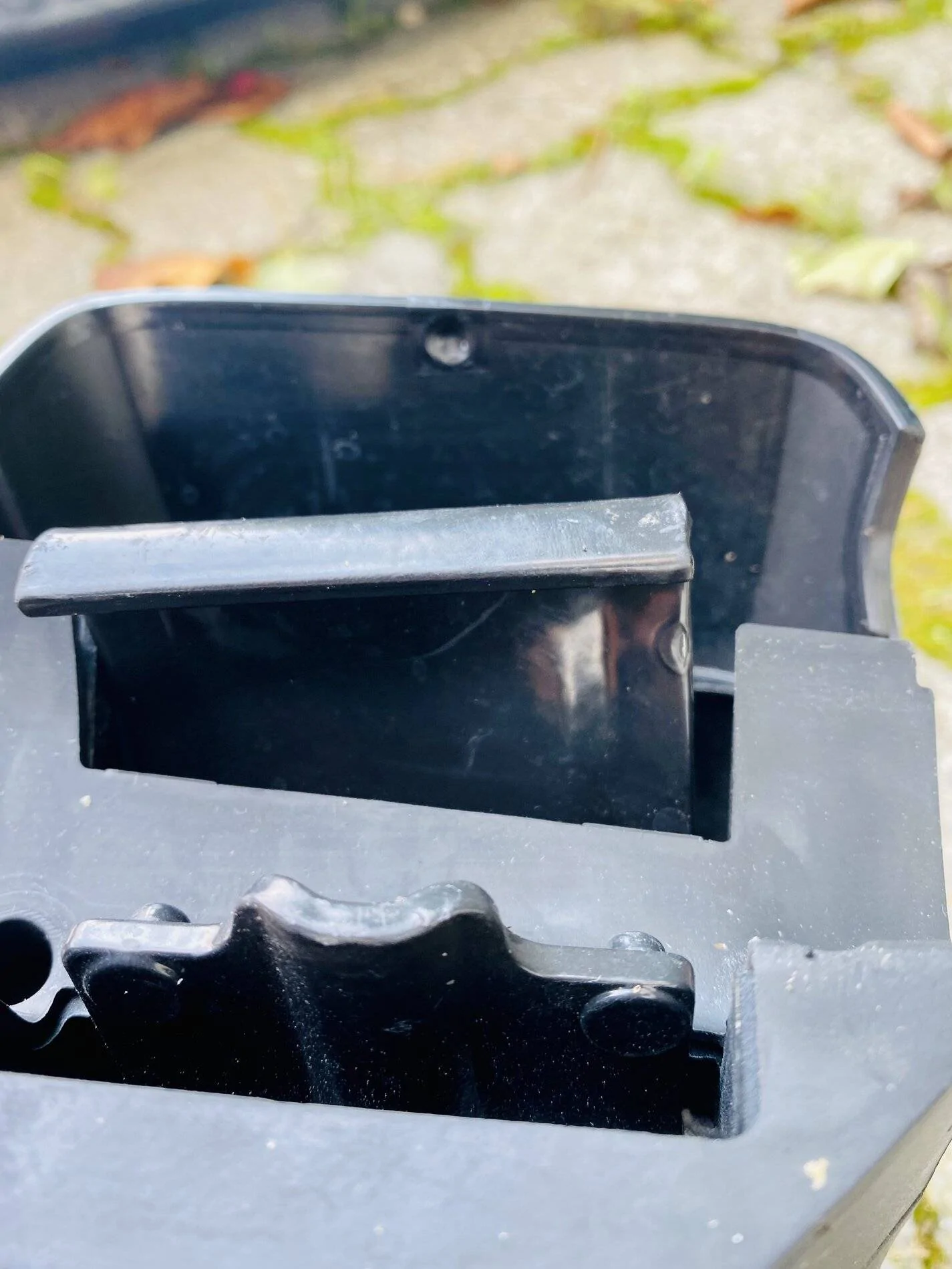

The clamp surface is not smooth (I can feel the ridge causing the damage on both sides) so not sure if it is a fault with the clamp or the way I’m attaching it? I asked Porsche who tried to blame me until I pointed out it was them that had attached it. They said they’d try and touch it up. But I’ve now put a new set of dents in it on the recent road trip…

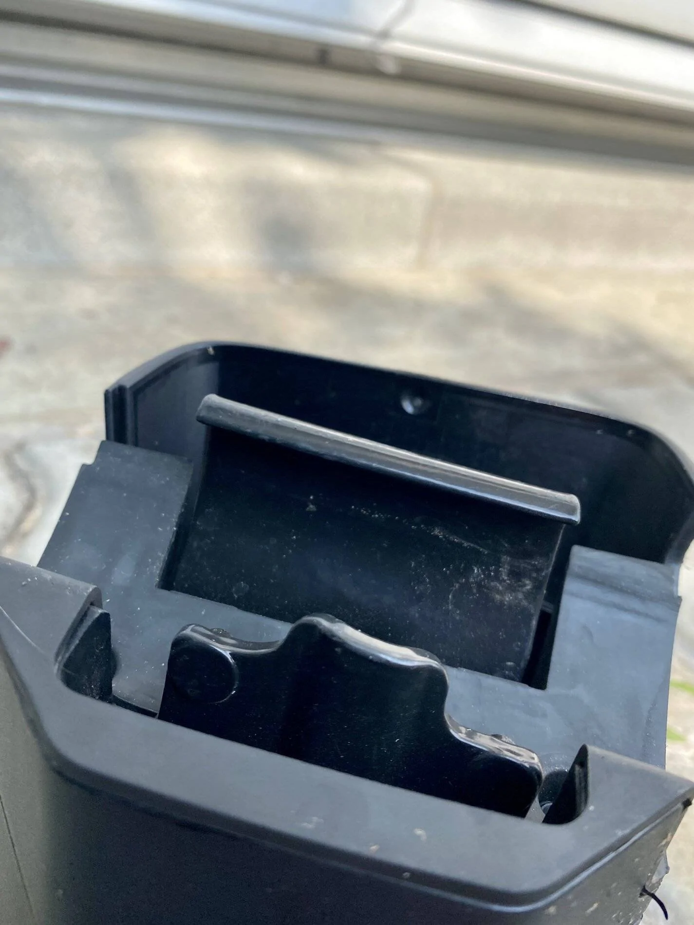

Yep these are the OEM bars supplied by Porsche. There is no rubber padding at all.
see the notch here which looks like it is causing the problem
Porsche Taycan Anyone got the Porsche roof bars and box? 0AE8EF70-603C-4727-B6BF-D3EF4F06A1F1
Porsche Taycan Anyone got the Porsche roof bars and box? 8C7FFDF5-924F-49AD-88DB-866F5E0A2343

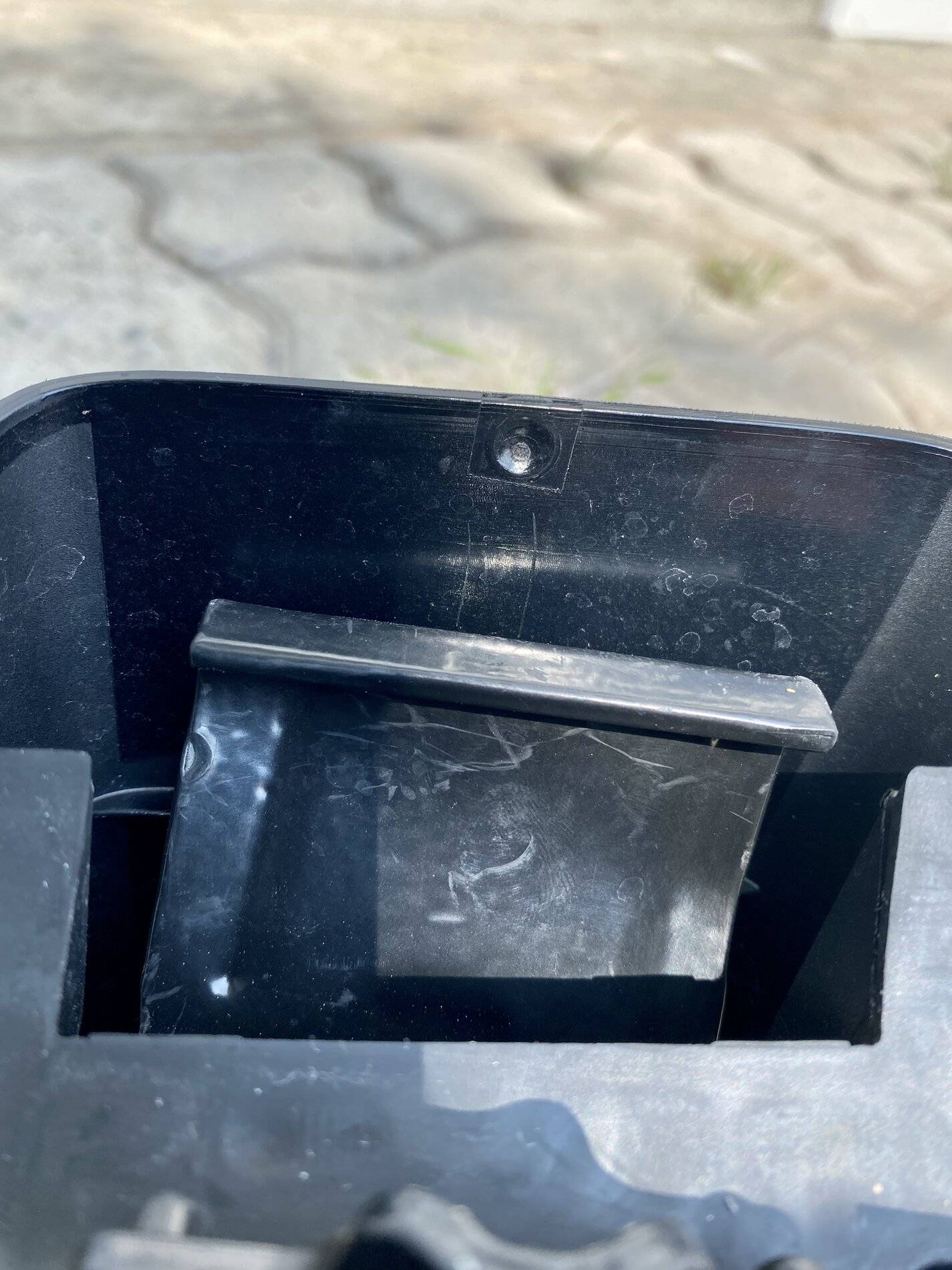

on the front bar where there is no damage, there is no notch
Porsche Taycan Anyone got the Porsche roof bars and box? 93B4C46F-D52F-415B-A2BE-90F36DD189C4
This is the result:
Porsche Taycan Anyone got the Porsche roof bars and box? 94E6C6A9-F1C0-485C-8C47-B8DDE1DBED29
Porsche Taycan Anyone got the Porsche roof bars and box? BC315938-0E7B-4264-B1EC-91F9DE688779
It’s only going to get worse when I attach them again.

Is it possible they forgot to install the rubber pads / protection?
Suggest they replace the roof bars free of charge and check the installation instructions.

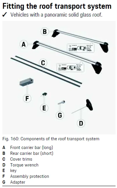

The following picture is for the saloon (note protector (F)). The Porsche Good to Know App has a section for the Cross Turismo but its not easy to discern what protectors are provided (if any) - take a look at 'Roof Transport' for more details if not already done so.

I am surprised at the lack of padding on the clamp. I wonder are the notches a manufacturing defect, or the result of deformation at the point of contact?
Looking at the MY22 manual (the Good To Know app):
Porsche Taycan Anyone got the Porsche roof bars and box? 7AE1D2B4-FE4F-46EF-8C1F-CAEFB20913D2
… there is a fairly conspicuous image of what looks like an unpadded clamp - so I guess this is the design. Wow.
I do wonder if it is in any way possible to get the installation wrong? For example, there is a front and rear bar - are they close enough in width that they could get accidentally swapped and then the shorter of the two has more lateral clamping force than designed? Also, I note that there are a nuanced sequence of torquing steps that, if not followed, might result in skewed clamping.

I think its down to incorrect installation.
These bars are used on various Porsche models with roof rails (Audis, VWs, Skoda's too) and can't believe they'd be engineered to cause damage.

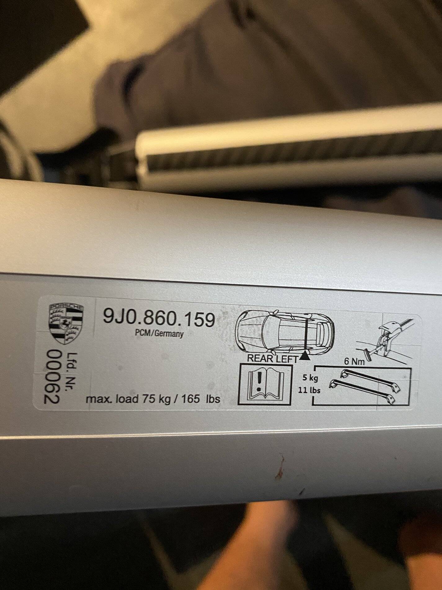

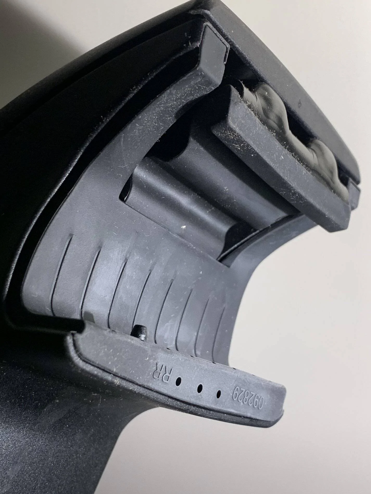

The lengths are completely different but I think I know what it is now… they need to go on in a specific direction (as the rail gets wider). I didn’t realize this until I just checked underneath and saw it is indicated. In my favour clearly the Porsche tech didn’t know this either as the first dent was caused when they fitted them prior to delivery
